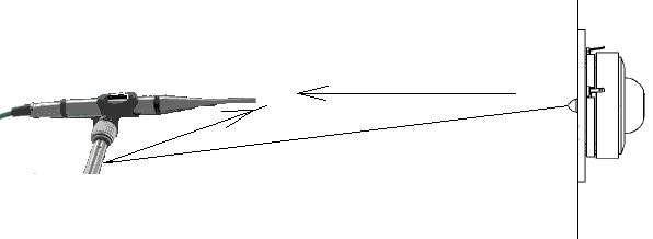

Thanks Fluid. Here is the ribbon tweeter zoomed in.
I calculated the +/- 2.5 foot distance from the mic tangent which comes to @ +/- 4" or 1/3rd of a foot (first circle) which is shorter than the 8/10ths of a ms ripple.
I assume the additional ripples (second circle) must be the floor ceiling line source reflections ???
Thanks for the info. I see some of transferred onto the tweeters STEP.
I got that from your description which is why I said the response was similar to an array. Compare your long ribbon impulse to my 25 driver impulse from a few pages back similar behaviour. Look at the first millisecond. There will be a path length difference from the ends of the ribbon Vs centre to the mic just like there are in an array. And when you look you have the same unsettled first millisecond.
I would be surprised if anything less than a millisecond was a reflection rather than the speaker, 1ms is a path length difference of about 30cm.
The portion of the impulse in the left circle is quite different to the right which seems a more defined ripple.
You can try a short gate and look at the frequency response, this is dominated by high frequencies anyway.
In your earlier graphs the first reflection looked to be between 3 and 4ms.

I also noticed the waveforms of the content of the 2 circles to be different but didn't know what to make of it. I appreciate being able to better interpret the plots.
I use the 1ms~=1ft rule of thumb. 30cm is 11.8 inches.
The 4ms/4ft reflection is most likely the leather couch which I should probably move back (or throw a quilt over) when taking measurements.
Seems odd to quibble over a slightly inaccurate rule of thumb division.
For us metric users 3ms per metre is the ball park figure. Neither is totally accurate.
I hope you took the intended point that unless you have a reflective surface in that area you are looking at speaker response in the sub 1ms region.
Sorry Fluid, I was not quibbling or disagreeing at all. Just stating I don't normally think/dream/work in the metric system and none of my tapes are metric but do have a metric machinist ruler, feeler gauges, wrenches and sockets, none of which would work for measuring the 2-channel room distances.
1) I confirmed the 4ms ripple was a leather couch reflection.
2) I confirmed the 8ms ripple was a reflection off the back wall.
3) I tried covering the top and the bottom of the front of the ribbon to make it a quasi-point-source. It made some minor magnitude changes to the 1st ms of the plot confirming your assertions.
4) I tried padding the floor in front of the ribbon and it made no difference confirming it wasn't the floor's line source extension. I didn't test the flat ceiling reflection.

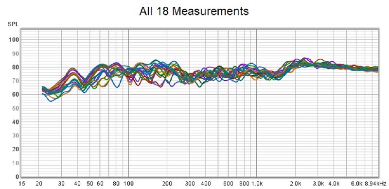

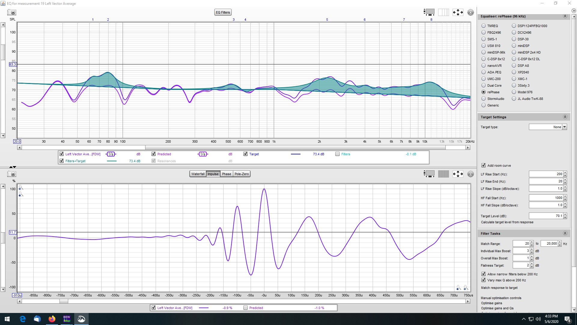

1).
Here's my 18 measurements. Nine for each channel as outlined in SwissBear's tutorial.
attachment.php

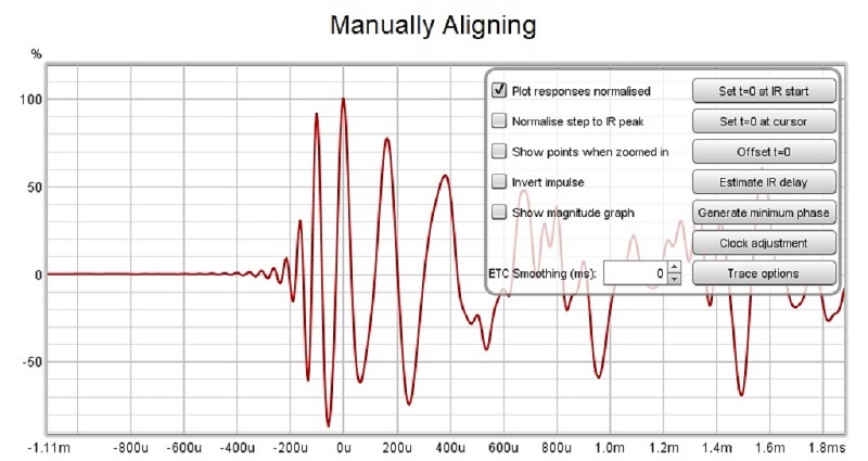

2.) I manually aligned the impulses of all the individual measurement using the
'Set T=0 at cursor' feature with the cursor at the center of the highest peak on each impulse.
attachment.php

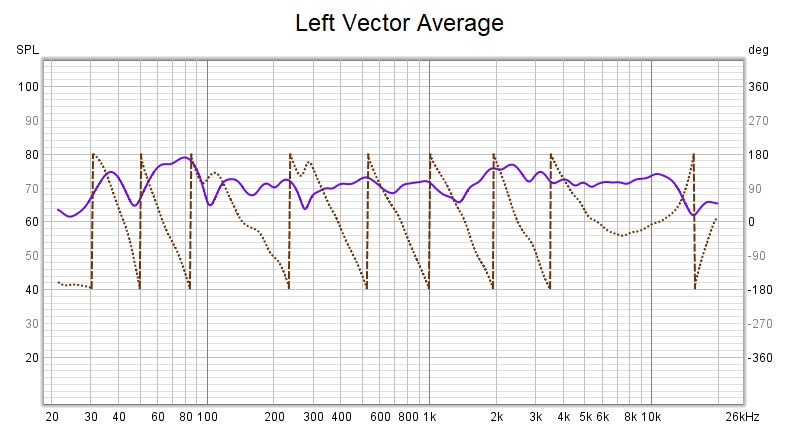

3.) I then vector aligned the nine measurements for each channel and applied 1/6 smoothing and FDW of 15 cycles. Left Vector average shown.
attachment.php

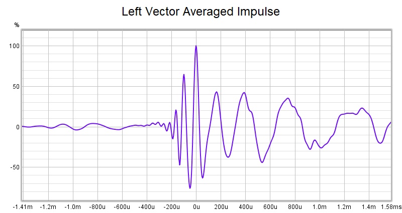

4.) Just for information I've included here the impulse of the Left Vector Average.
attachment.php

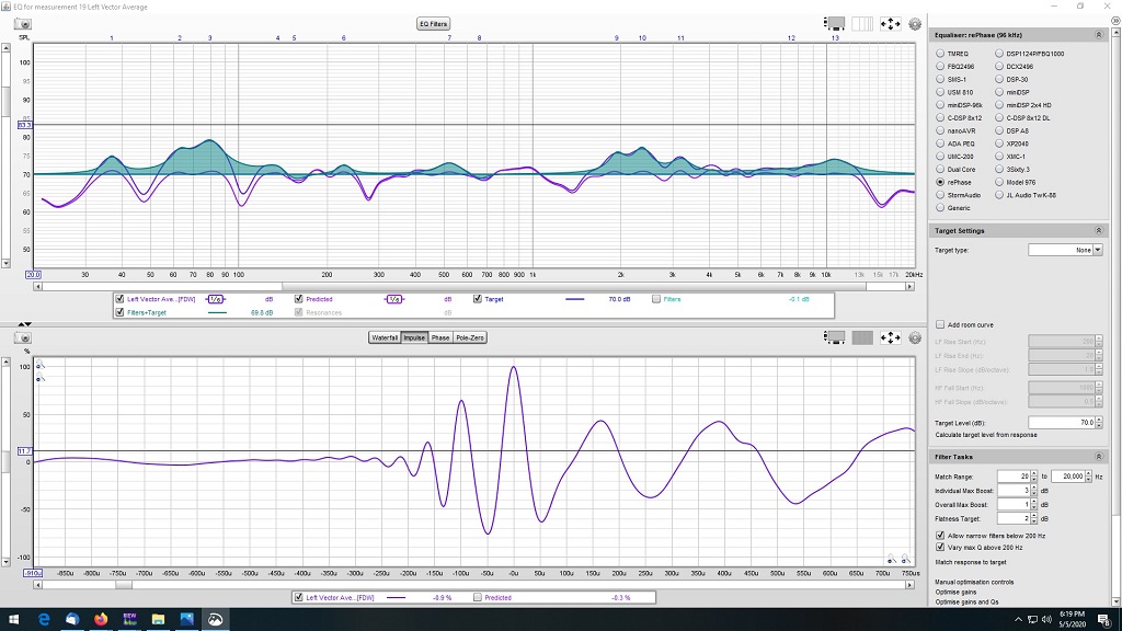

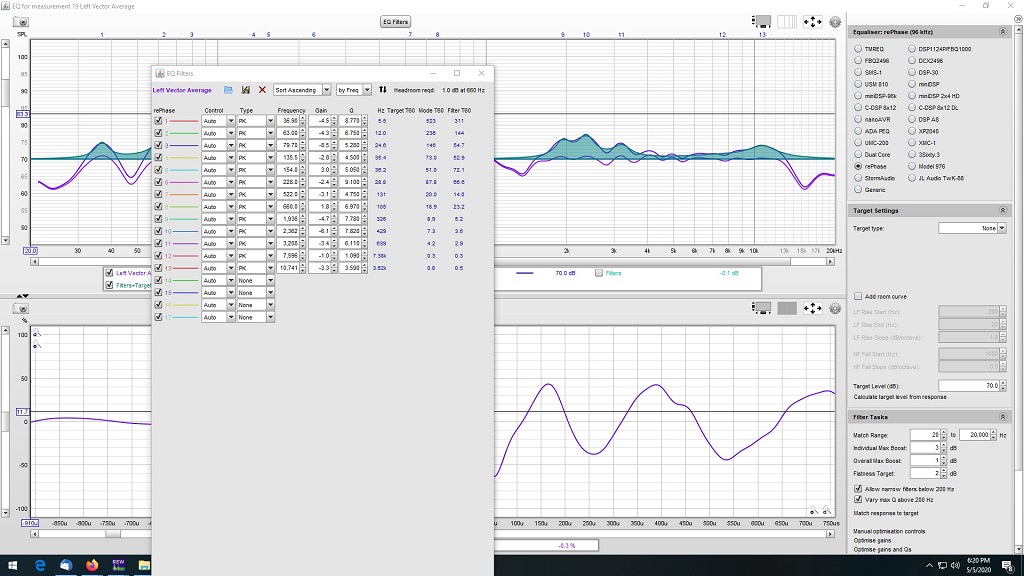

5.)A screen capture of the Auto EQ of my Left Vector average.
attachment.php

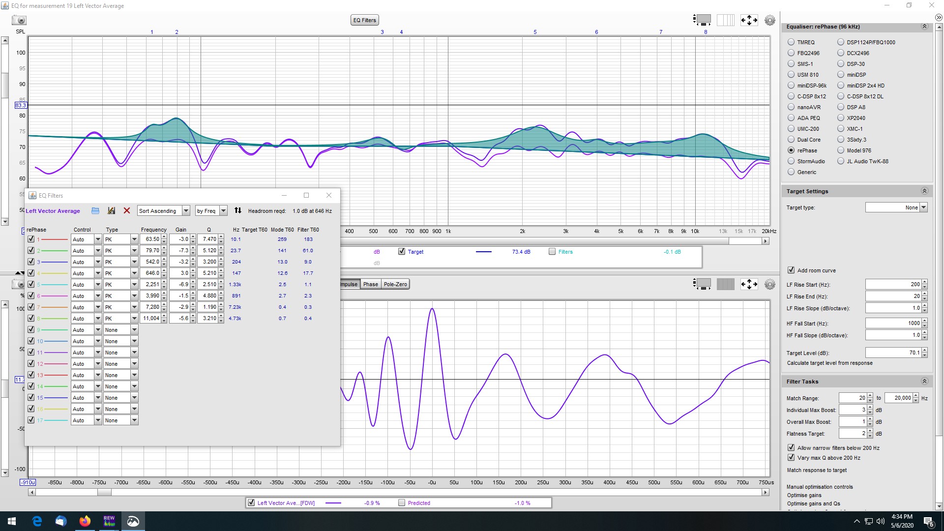

6.) A screen capture of the filters generated by the Auto EQ.
attachment.php
7.) The filters are saved for each channel in .xml format for use in Rephase.

8.) Windowing (FDW) is removed from each vector average but the 1/6 smoothing is left intact before exporting each as text for use in Rephase.
No 8 doesn't make much sense.
Also a flat in room response is unlikely to be the best final target. A speaker with flat anechoic on axis response has a downtilted response when measured in a room.
I realise that you have been following the tutorial quite closely and their graphs show a flat response but that is something that is probably better to deviate from.
Add a tilt in the REW EQ section target response. The LF and HF sections switch at 200Hz so you can create a linear tilt from any frequency or have it hinge a little at 200Hz.
Anywhere from 6 to 9dB slope from 100Hz to 20K is a reasonable ball park figure, which comes down to personal preference.

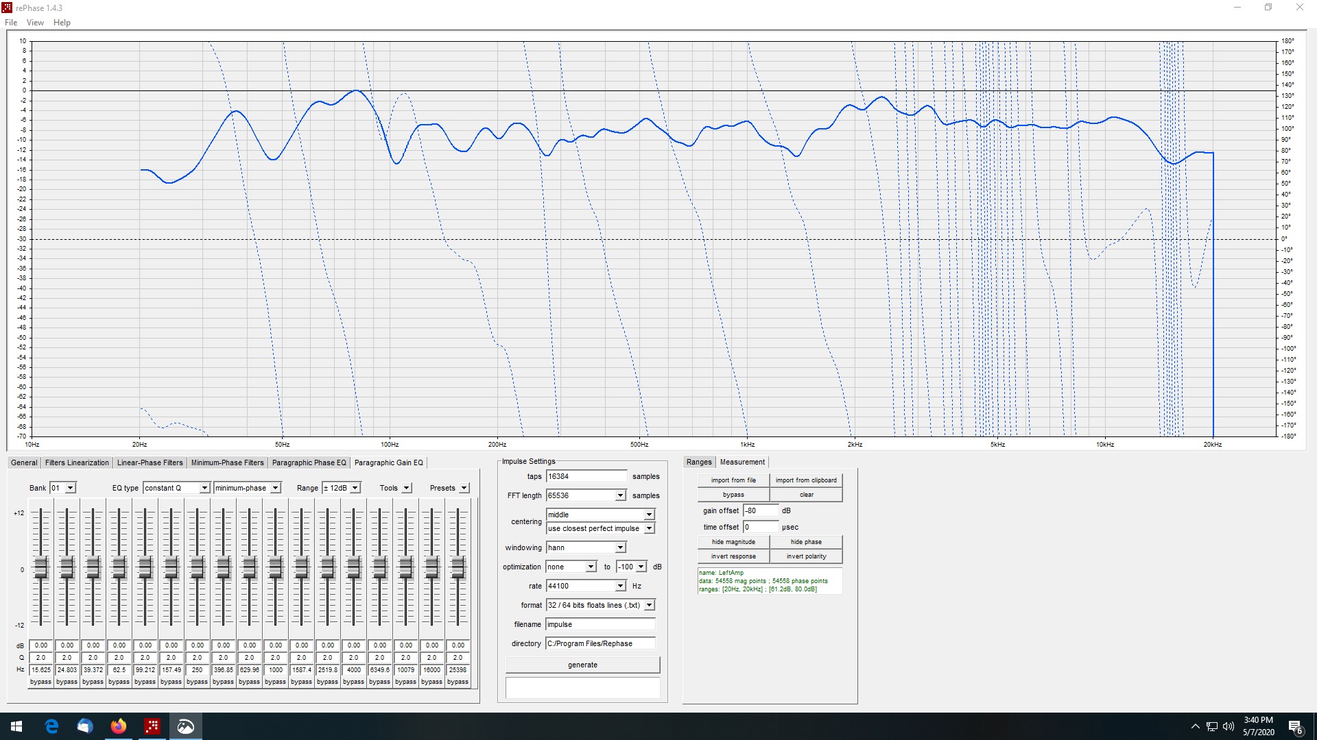

Part II
Left Channel only
Left Vector Average imported into Rephase with 1/6 smoothing but no FDW.
attachment.php

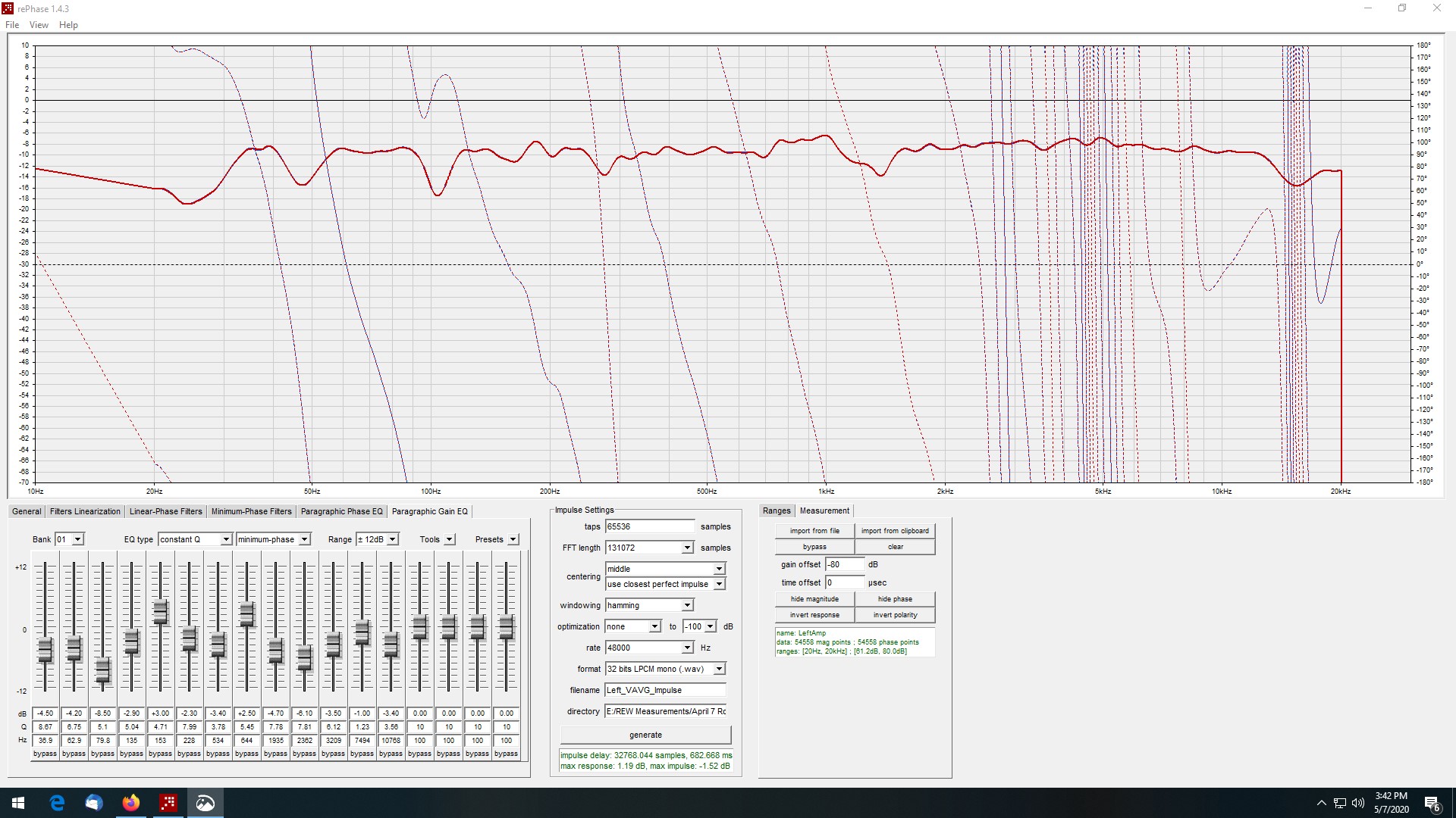

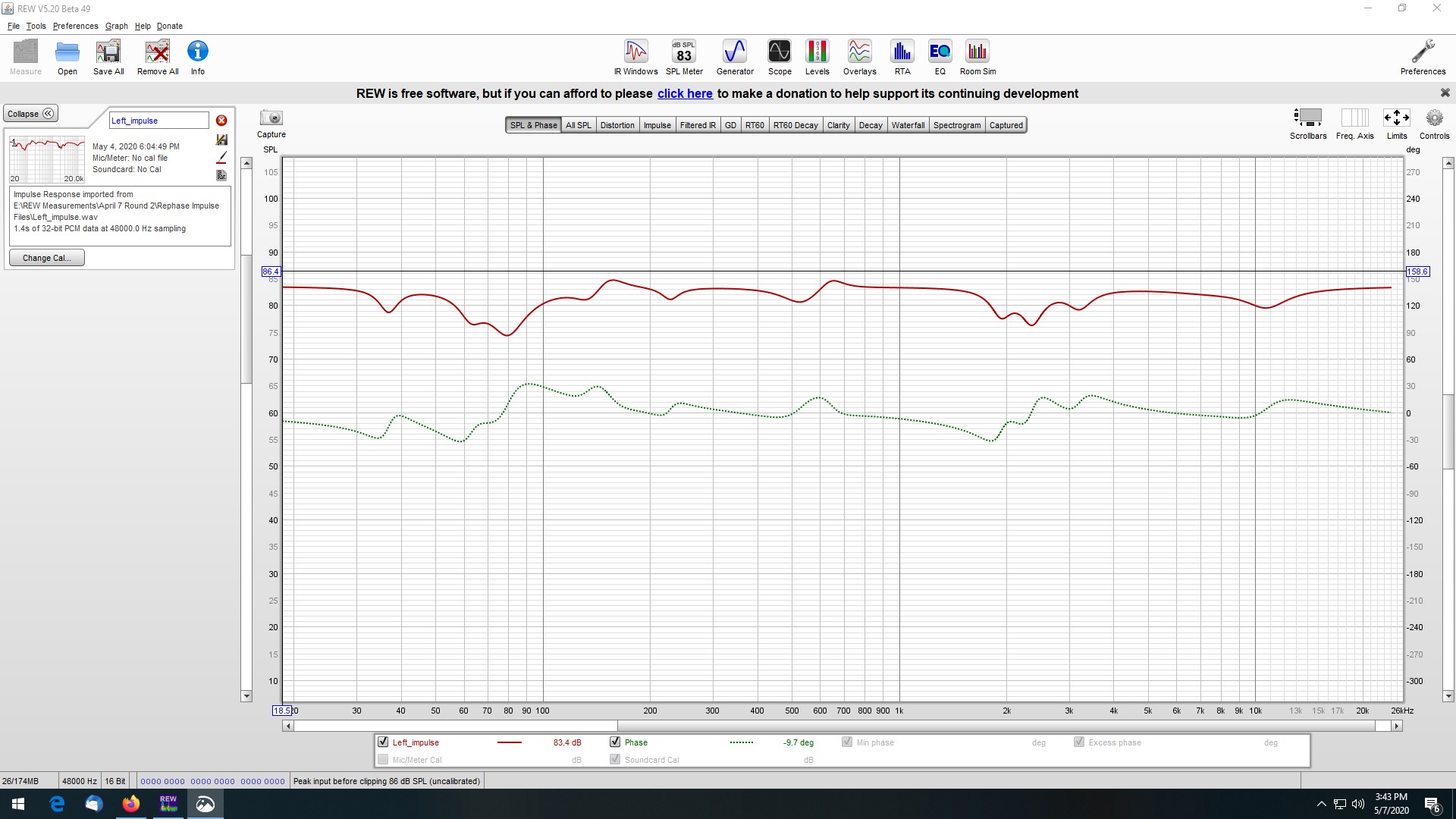

Left Vector Average with REW filters applied and generating Impulse.
attachment.php
View of the Impulse generated by Rephase.
attachment.php
