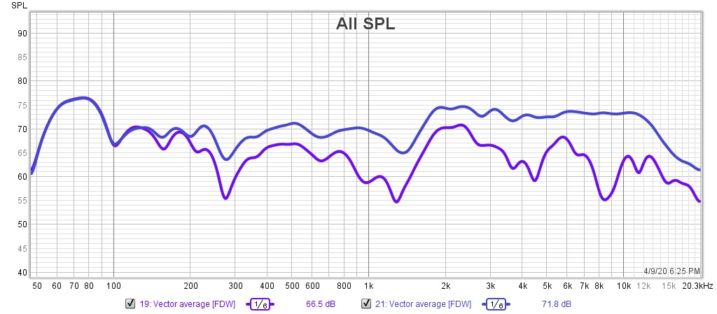

Briefly, my goal is to use one or more of these tutorials to learn how to correct the amplitude and phase of my line arrays. These corrections will be applied via a minidsp 2x4HD. So far, all I've accomplished is going from zero knowledge of REW and Rephase to a reasonable amount of comfort using them. This hasn't been without a few bumps along the way but thanks to the kindness of my fellow forum members I feel I'm progressing nicely and sooner or later I'll achieve the results I'm looking for. From my point of view, the experience has both very challenging but enjoyable. I'm not the type to give up easily so expect to see more posts here as I get closer to the end!

If the EQ was all done in REW then there is actually no need to import the amplitude measurement into rephase other than to confirm that the EQ is working as desired.
The point of using a FDW on the phase is to clean it up and avoid trying to micro manage it in rephase.

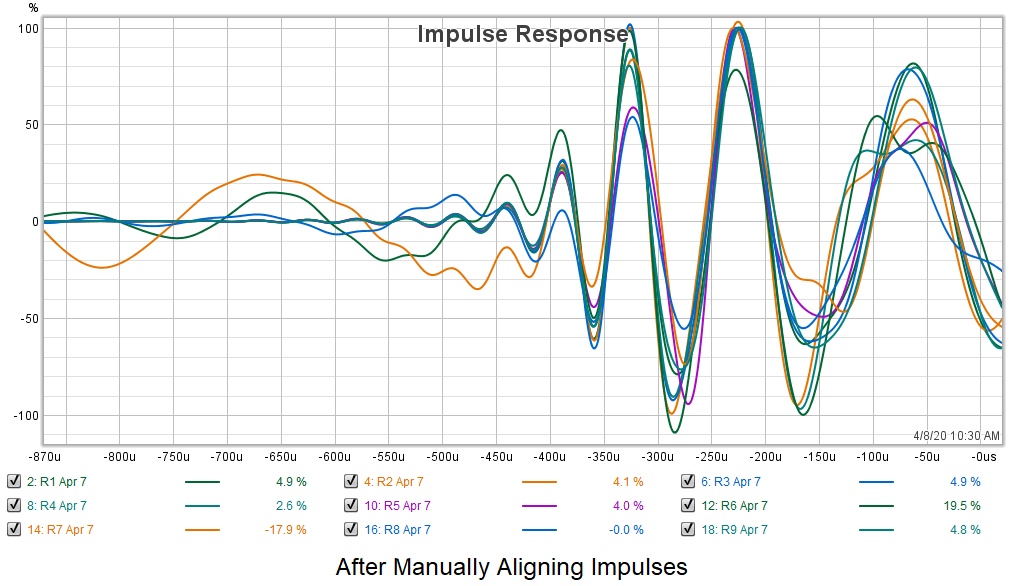

This ended up being excellent advice because the additional tutorial suggested manually aligning impulses.

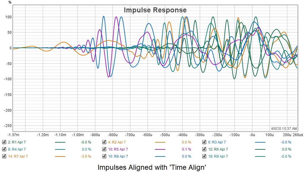

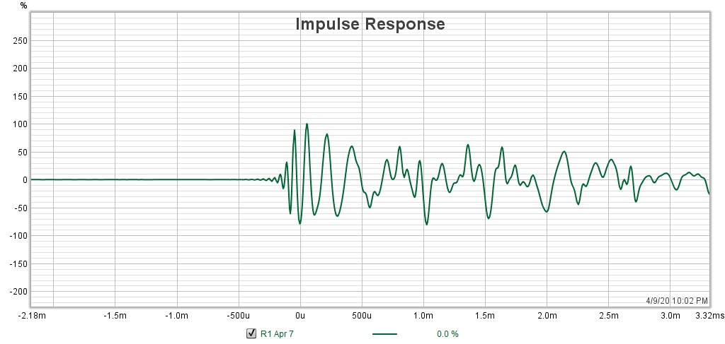

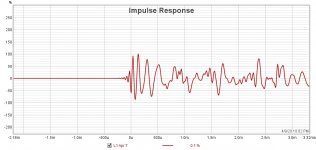

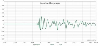

Here's an example of my impulses for the nine measurements of one channel.
The first image is the impulses aligned using REW's 'time align' function. The second image is the result of manually aligning them all.
Dan
Dan
Your impulse responses do not look right, it is no surprise that REW is not having much luck. What speakers and crossovers have you got running here?

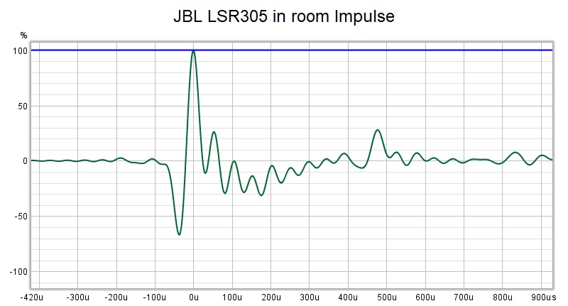

This is the impulse response of a JBL LSR305 in my room, you can see that the tweeter and woofer are out of phase but it is otherwise clean with a bit of ripple, you have a lot going on before the peaks and you have a lot of peaks.
If you can just try the main speakers by themselves.

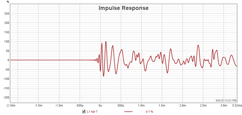

First is the impulse of my left speaker at an equidistant listening position from the right speaker. The second image is the right speaker's impulse.
Dan

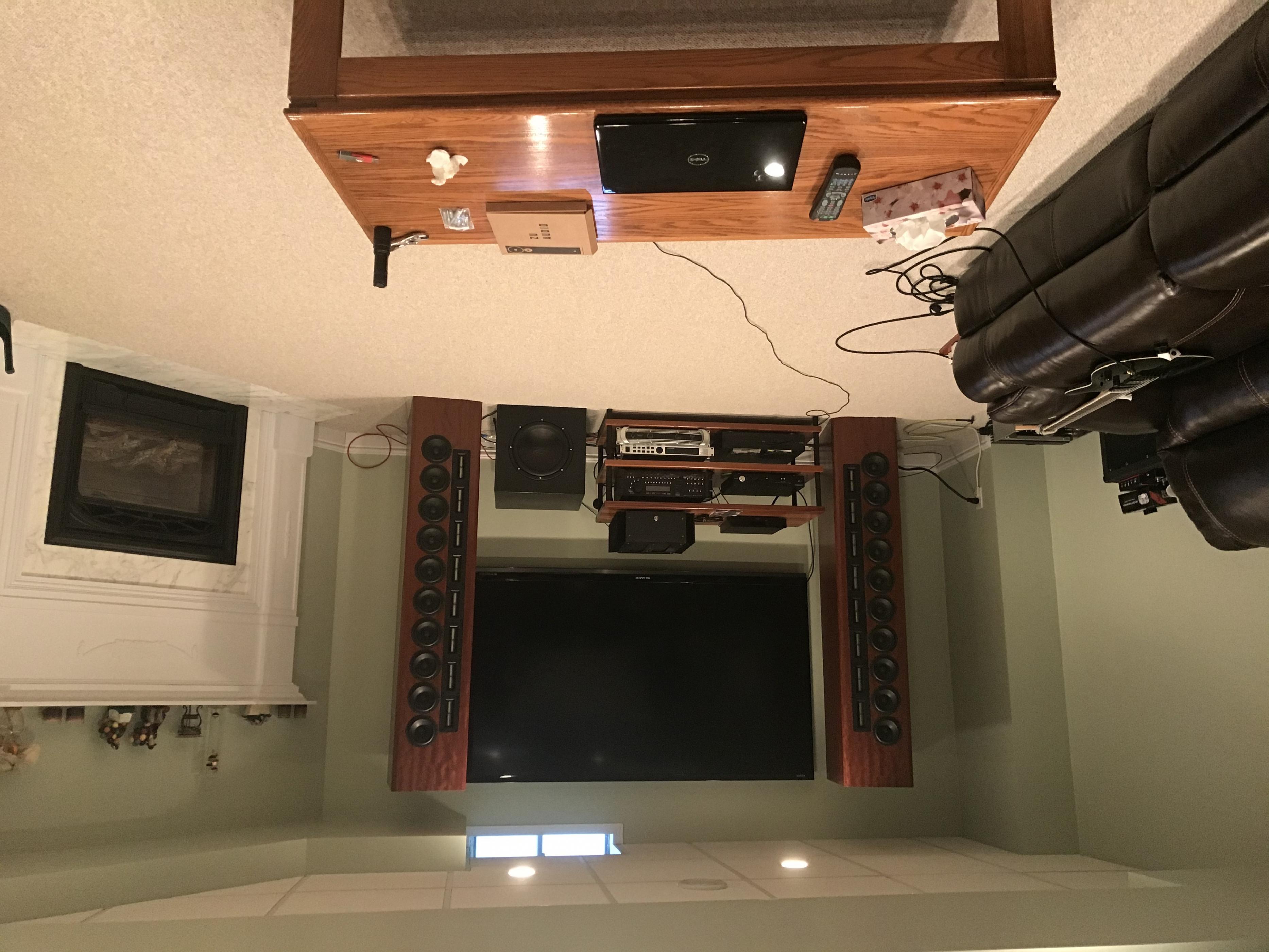

They are line arrays with Foundtek ribbon tweeters.
Dan
Dan
Dan

A line array consisting of
Silver Flute W14RC25-08 ohm 5-1/2" Wool Cone
and
Fountek NeoCd2.0M-blk 5" Ribbon Tweeter - Rectangular Flange - Black
Both on fourth order LR crossing over around 2500hz.

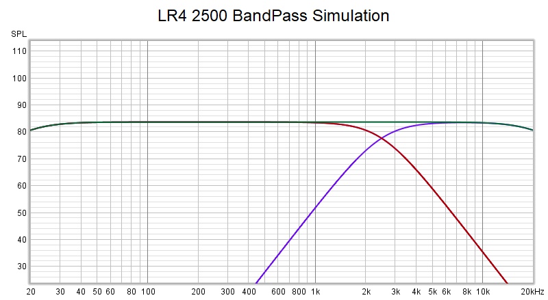

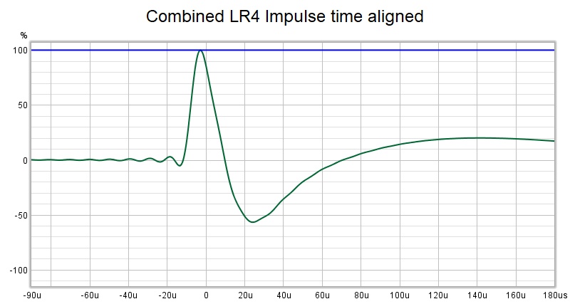

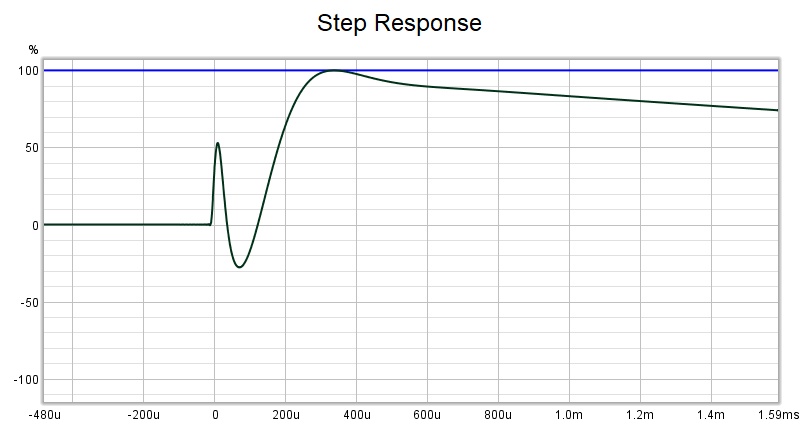

To add a little bit more rephase into the discussion I made a simulation of a speaker with 20Hz 20K 2nd order rolloff and 2.5K LR4 IIR crossover from rephase impulses and combined them in REW after being time aligned.
So this is an idealised response
Impulse
Step

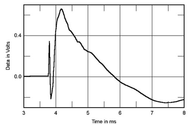

For comparison a Revel M106 step measured in Stereophile, with a similar LR4 crossover.
Impulse
Step

Another interesting note I found in another tutorial is that 'zero' on the impulse graph should be in the middle of the largest peak.
If the largest peak is not on top at the time zero, go to the options menu shown above, and go under “time zero” and select “largest peak” and click “autodetect.” This should center the impulse on the time zero. If all the impulses you measure are upside down, you may need to check the “invert” box; if only some measurements are upside down, leave them be. It's important to get your time-zero lined up or your phase results will be wonky. You should check on this for every measurement (the “auto” usually gets it right, but it's worth confirming).

Those instructions are for Holm Impulse so the Options Menu is not the same in REW. REW will normally set the peak at t=0 or it can be moved manually with offset. Aligning the peak to t=0 is a good idea.
If you had to pick a peak from the graphs you posted then the third one has the highest amplitude and I would go with that, but I think it is worth trying to find what is going on in the measurement as there is a lot of up down movement early on in the impulse which looks like it comes from the speaker itself.
It is important to know where the phase inversions come from, amp or DAC connected in opposite polarity, speaker wired incorrectly or and out of phase wired crossover.
In most multiway speakers the tweeter will fire first so if the tweeter is wired positive the first peak should be positive.
