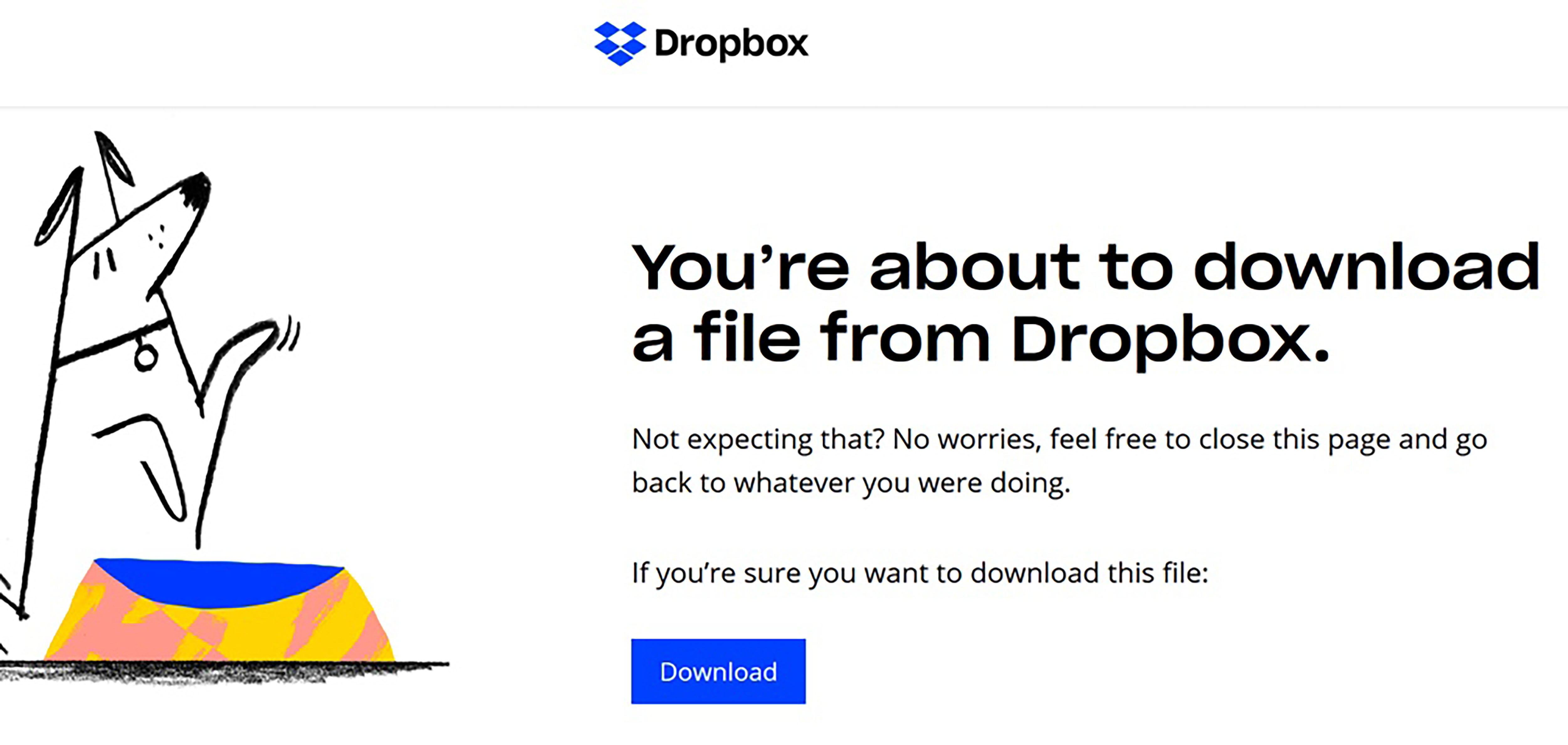

Hello francolargo
Yes, rePhase binaries have been stored on my personal dropbox repository ever since the project left sourceforge.
The fact that dropbox now shows a warning page is quite new though.
Hi Thierry,
I like the direct seamless download behavior of dropbox (well, looks like it does not work anymore, at least not for that particular file...).
Not sure I can do this with google drive but I will check.

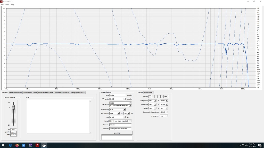

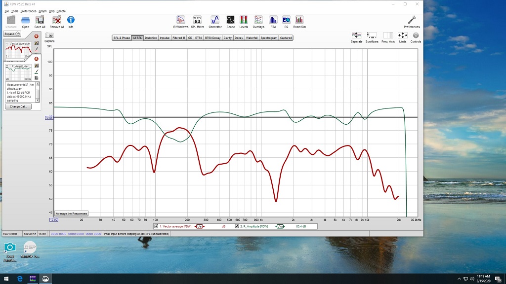

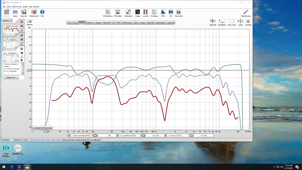

I'm working through SwissBear's 'REW measurement averaging + Rephase' tutorial and my progress has stalled on the last couple of pages.
As seen here I've reached the point where the amplitude correction impulse is ready to be applied to RAvg as seen here.
The next photo shows the the creation of A*B with the SPL adjusted down 70db to show in the graph.
Next we see A*B by itself.
And finally all four together.
Give me a couple more minutes and I'll post my Rephase results to see if I'm on the right track.
Dan

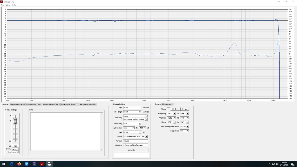

Anyways, here's my Rephase results
What throwing a monkey into my wrench is SwissBear's quote from his 2017 article titled, "Acoustic treatment & Calibration
Rephase - The Tutorial
[pda0] & [Bear]"
And, in the same tutorial he mentions A+B which appears to produce better results for me?
Dan

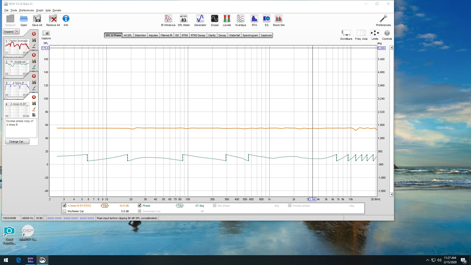

What that means is that you need to convolve the correction with an un-windowed raw measurement. If you perform trace arithmetic in REW or export the measurement, the FDW can become baked into the response.
So deselect the FDW in the IR window before performing trace arithmetic on the measurement. You can always put it back on for viewing afterwards.
A*B with a level reduction is the correct way of convolving traces together in REW.
A+B is adding the responses together, that is for two sides of a crossover or similar applications.
This is simulating a convolution so A*B is right.
The orange trace is your excess phase which you imported into rephase. The filter generated from that needs to be imported into REW and convolved (A*B) with the other traces to get the overall result.
Your vector average is a bit strange, that is a big dip at 1.5K. Without knowing more about your speakers or room it is hard to guess what is happening.

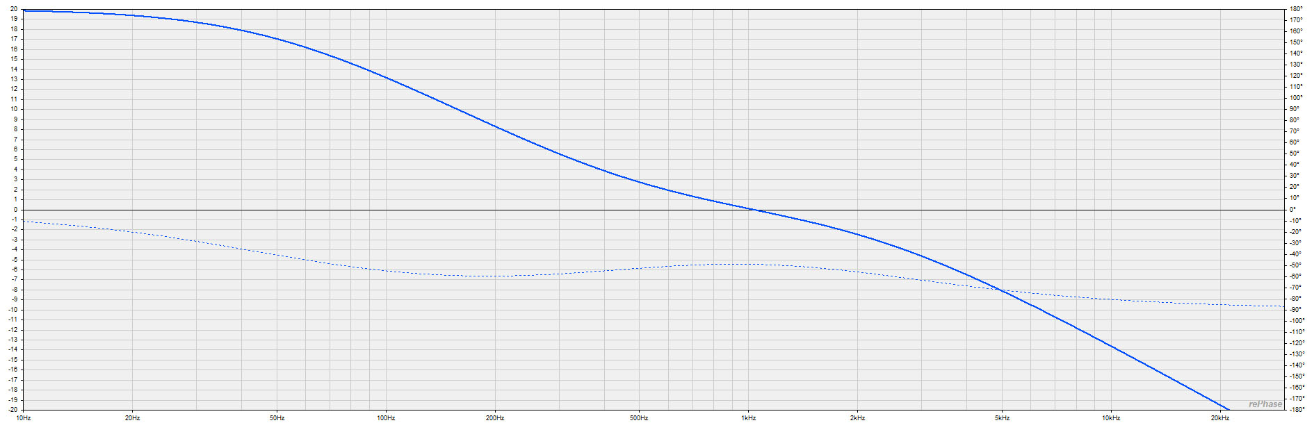

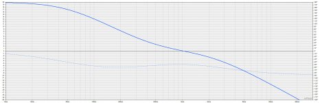

Question about RIAA EQ with Rephase.
I would like to do RIAA EQ via convolution using rephase. I searched around and noticed some old posts from POS about adding RIAA EQ into rephase as a "standard filter" but as far as I can see it never happened. Is there a reason it didn't happen (like it doesn't work) or something else. I also see several different RIAA solutions posted but little follow up if these work correctly or not. Any help / advice on RIAA EQ with rephase appreciated

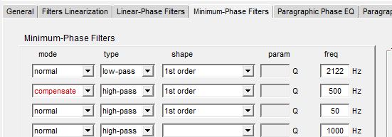

Hi levimax,
Here are the correct settings for RIAA Playback curve in rePhase…
Just apply these 3 simple filters using the "Minimum-Phase Filters" tab:
NORMAL --- LOW-PASS --- 1st order --- 2122 Hz
COMPENSATE --- HIGH-PASS --- 1st order --- 500 Hz
NORMAL --- HIGH-PASS --- 1st order --- 50 Hz
Equally valid, the filter shape name "1st order" could also be set to "Butterworth" with "6 dB/oct" slope which is exactly the same thing.
If you ever need to make the RIAA Recording curve (perhaps if you were mastering to a vinyl cutting lathe machine???), which gives the opposite curve, just use the same settings above, but for each filter swap NORMAL to COMPENSATE or vice versa, to invert their behaviour.
https://www.diyaudio.com/forums/att...ation-eq-fir-filtering-tool-riaa-settings-jpg
https://www.diyaudio.com/forums/att...rization-eq-fir-filtering-tool-riaa-graph-jpg

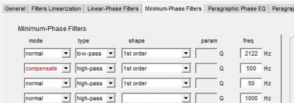

Hi levimax,
Here are the correct settings for RIAA playback curve in rePhase…
Apply 3 simple filters using the "Minimum-Phase Filters" tab:
(NB: Alternatively, filter shape "1st order" could equally be set to "Butterworth" with "6 dB/oct" slope which is exactly the same thing.)

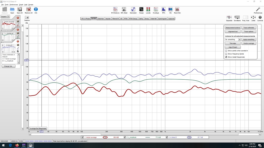

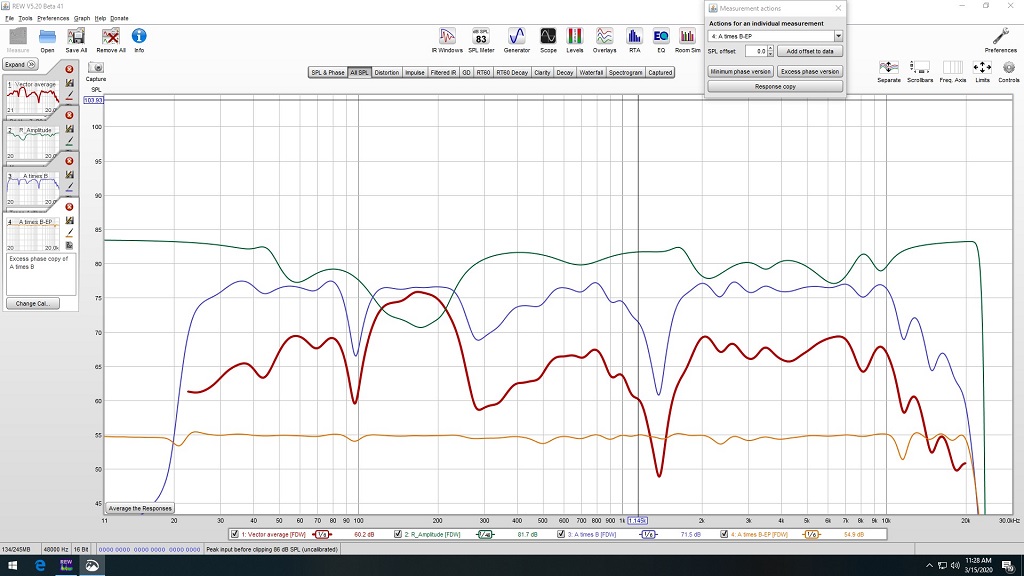

Ok, Here we go!
Red is the sum of the 9 left channel measurements without FDW.
Green is the amplitude correction impulse imported from Rephase.
Blue is A*B of the above.
More when I do a bit more reading.
Dan 🙂
On your Red Average line try setting REW's auto EQ reference at about 68dB and run it again to see what it comes up with the EQ on your graph looks odd which is why the A*B is not very flat.
Your graph as it is now will most likely sound bright as a flat power response in room does not sound flat.
