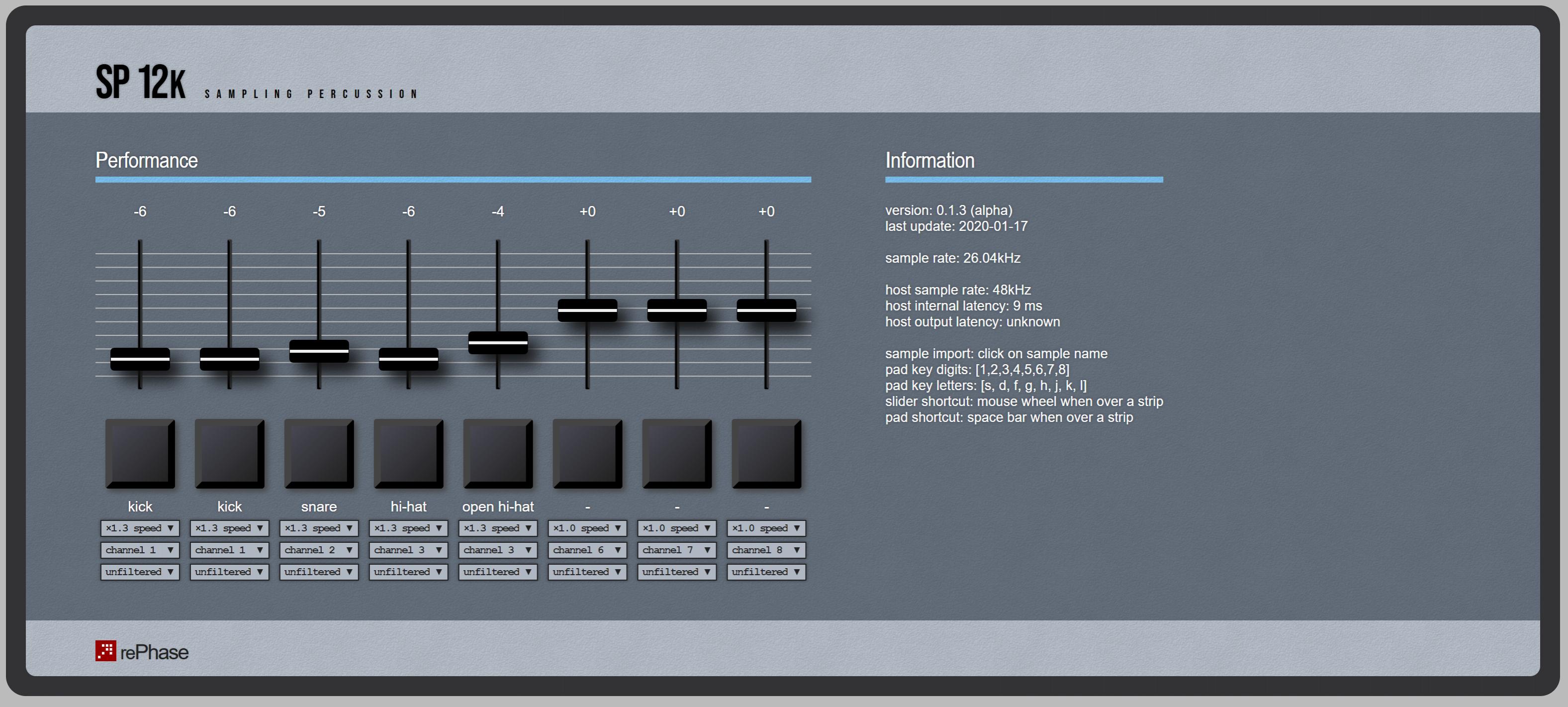

I don't know if there are any E-mu SP1200 aficionados around here, but I have been playing with the javascript webaudio API lately, trying to emulate its sound:
SP12k - SAMPLING PERCUSSION
It is a web application, running in chrome desktop, firefox desktop, and android devices (although latency might be quite high there depending on the device and android version).
ios and safari are not supported for now, but it works with chrome on macos.
I am pretty satisfied as far as sound is concerned (close to indistinguishable from the original on the sound comparisons I have tried), but I still have a lot of work ahead of me with functionalities (sequencer, sample editor, mixer, ... filters, etc.).

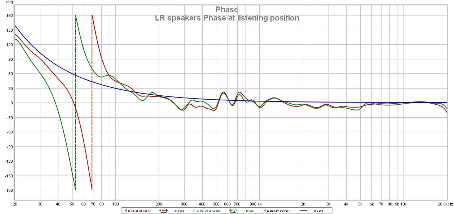

If one models the phase response of an "ideal" speaker, it is similar to the blue curve in the chart below. Of course, it depends on the low frequency cutoff and roll off slope for any particular speaker system, but if you play with different low frequency box alignments, the phase shape is more or less the same.
The red and green traces are my speakers measured at the listening position some 9 to 11 feet away. I used FDW and psychoacoustic smoothing in REW as it closely matches the correction settings used for the DSP FIR filtering.
I have experimented with just linearizing the phase in a 3 way system with a passive XO and must say I did not notice a huge improvement when I switched the filter in and out while listening to music in real time. However, when I time aligned the drivers using linear phase digital XO and then corrected the excess phase, I noticed a considerable improvement in the "depth of field" in listening. Almost like the sound went from 2D to 3D.
I am wondering if this is the same sense that wesayso and others with line arrays are hearing as these types of speakers are inherently time aligned and have no XO to mess with different time arrivals and phase...
Thoughts?

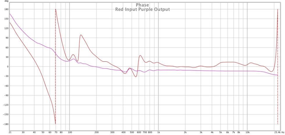

Hi Mitch,
this is probably not the measurement of the last version of your filters but I choose to comment anyway just to draw attention to one common problem that is easilly overlooked.
Your phase response look very neat, except for the 40-80Hz region in which there is more than 100 deg of difference between phase of left and right speaker which will cause a cancellation of response in that frequency region. That cancellation won't of course be visible in each speaker response but is easilly visible if you measure response of both speakers. But as I said, I'm pretty sure that in the meantime you polished phase response of your speakers.
I had the same issue in the same region and was able to correct it via phase EQ with rePhase. Here it is how my graphs are looking. measured from LP (4m from the speakers, FDW of 12 cycles and psychoacoustic smoothing):
I wonder which is more "correct" then 🙂
Both are "correct". 🙂 Applying FDW is essential with phase correction to filter the refletions. Although the graph will be a little "choppy" for the phase itself you can go solely with it. But if you try to display GD based on that "choppy" phase graph you would see that using some smoothing (like psychoacoustic or 1/6 octave) together with FDW is also beneficial.
