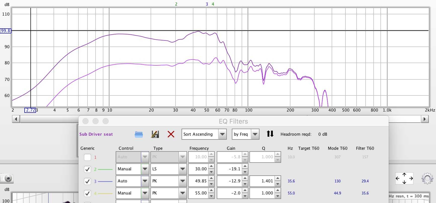

It sounding better than Dirac as far as ambiance, imaging , and harmonic balance. My 2118h midrange are extremely hard to get right.
The differences between left and right responce are so extreme that doing seperate left and right eq de-correlates the phase between left and right.
Where Dirac somehow manages it much better. I really want to figure out how to get that eq work done right and maintain spectral balance in the time domain.
So I’ll be hoping I can get help with that later, for now I’m going continue to get the sub farther nailed down. I’ll start with the sub and work my way up from there.
I’ll get some measurements of the sub just like you described and see if I can make the stopband have better attenuation. I also noticed that and tried adding a iir lowpass and it changed the timing negatively.

close mic and back seat and driver seat and passenger seat. All no processing
the last measurements also did not have processing. I just remembered that I sent my soundcard directly into amps. I do now remember my sub amp (Rockford bd100a1) has a 12db BW dial on it that can not be turned off. I think I have it turned up all the way to like 400hz. Now I know why there's sub timing has been strange. I completely forgot about this.
As far as the sub polar being backwards , I wonder if its the amp polar response or something to do with amp.

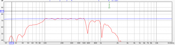

I also took some measurements of the 2118H close mic, 1foot away and a driver seat reference mic location for time alignment to left and right. (similar to the 1st Dirac measurement point)
you can see how the 2118h goes to complete s*** at the reference position.
Any ideas welcome
Thanks in advance.

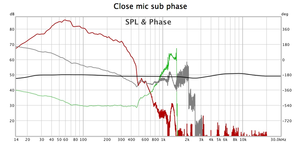

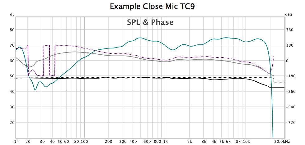

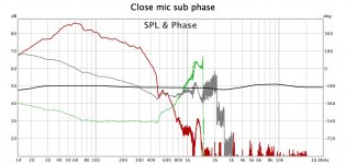

Your close mic measurements show that your drivers behave more as expected, but the phase is still a long way from being minimum phase. See how your phase has a similar shape to minimum up to 70 Hz but is a full turn out of phase, then it goes away. There are no big jumps in the unwrapped phase which usually come from reflections. That could be your mic, your equipment or something, but if you plan on using your measurements for phase correction you should work out what is causing it and if you can remove it.
I have attached an example of a close mic measurement of a single TC9 driver I made. The phase is pretty close to minimum as shown by the grey trace.

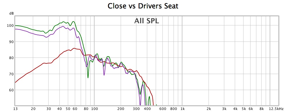

When you overlay the close mic and drivers seat sub plots and adjust for level it shows what the cabin is adding. A lot of boost with 80Hz and 27Hz boundary dips. Fairly easy to EQ close to flat with only a few filters.
Your sub seems to extend quite high but your midbass does not go so low. You might want to make your crossover closer to 100Hz and try that.

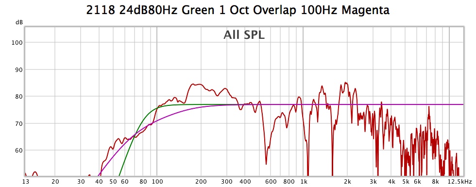

I have overlaid some textbook curves at 80Hz LR4 and and 1Octave overlap at 100Hz from rephase to show what they look like. If it were me I would EQ the driver to the flat part of the line by removing the peaks above and leave the dips in. If you are using LR24 filters on top of that response you will get quite steep crossovers acoustically. Work out what you are aiming for acoustically overlay that with examples from rephase and see what filters you need to hit those slopes.

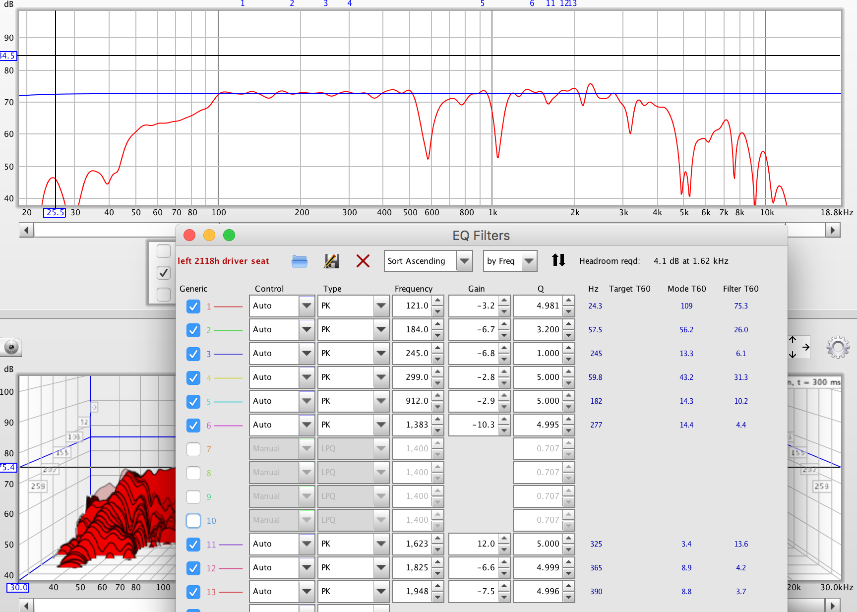

I would measure your amplifier at very low volume with REW, less than 0.7V output maybe less to avoid frying your soundcard. Do a search you will find plenty of guides on how to do it.
That will show you what the amp is doing, it should then be possible to create an inverse filter to undo whatever the amp is doing that you don't want.

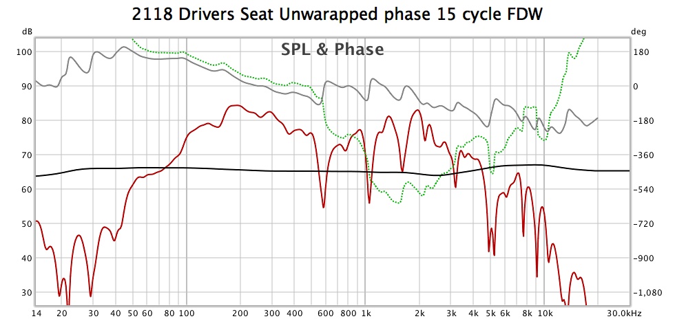

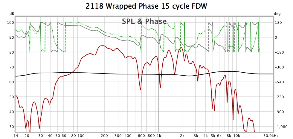

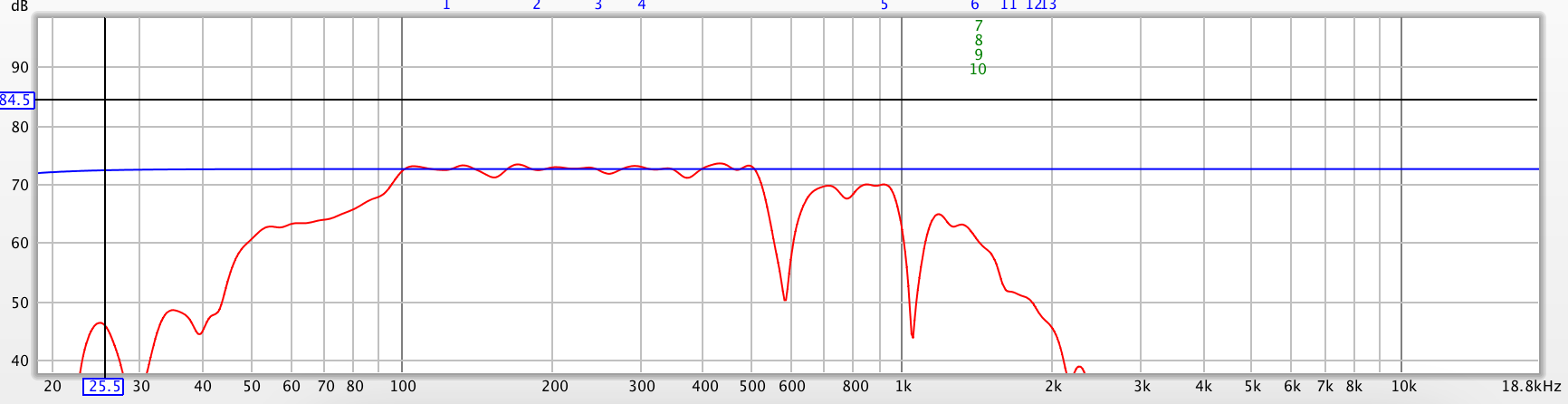

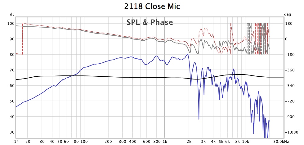

I have attached a shot of your close mic'ed 2118, this shows good matching to minimum phase before reflections get in the way. That demonstrates that your setup is capable of proper measurements and it is most likely the amp that is causing trouble on the sub measurement.

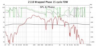

I have also attached a shot of the drivers seat 2118, with wrapped and unwrapped phase. You can see the jump from the reflections but in the wrapped one you can see the phase still follows the general trend of the minimum phase shape apart from the wraps at reflection points.
I have also done a quick REW auto EQ on that driver to show it isn't that bad with a bit of EQ. Then one with an LR8 @1400Hz.

Excess phase is anything other than the minimum phase, it can be from reflections but it could be other sources of non minimum phase behaviour.
What you call plain phase is the measured phase. If your measuring setup is good that should be a representation of what you have. Make sure to include your mic calibration file in your REW measurements. I don't have it so my screenshots don't take it into account.
A speaker is a minimum phase device. If you use minimum phase EQ to correct the amplitude it will correct the phase at the same time.
There are not many situations where trying to correct the phase from reflections will work well. You need a good understanding of what the problem is to decide whether you should try. If not leave it alone.
Any form of phase correction should be the last step. Frequency response, time alignment and crossover optimisation should be your first priorities.

So here’s where I’ve been screwing it up this whole time,
I have been using moving mic spectral averaging RTA with pink noise to make everything flat. I need to do time averaging. I have always liked the spacial averaging sound way better than using measurement points and averaging them. For this process that must be my problem as I’m doing or it’s adding the room reflections to the average. I need to take those out.
I can’t wait to try this now. Maybe that is what’s causing the de-correlation.
And what I meant by de-correlate is the center image goes away and the phase coherence between left and right falls apart.
In a car there is radical differences between left and right. If let’s say you have a 8db peak at 200 on the left side and a 8db peak at 400 on the right and there’s a 1.2ms time difference and you use time delay to correct for that (which delay as we all know is only a alignment at some frequencies because the acoustic origin is fixed where the acoustic center can be changed with delay) and try to EQ that the phase between drivers gets changed radically.
But I have a hunch now with time averaging I’m only correcting frequencies that are minimum phase and not non minimum phase. Your overlay massively helps me see that!
I’ve been getting screwed up thinking I need to see the overlay in rephase, but all I have to do is move it all to a straight line and that will make it minimum phase again. I did not understand that! Yes it makes sense now.
I am so excited to try this! I’ll do exactly as you said with the impulse peak alignment in rew for each driver. Yes that seems like an excellent approach indeed!
Your a rockstar FLUID , btw there’s some big car audio names filling this thread now. We all are anxiously waiting for this to work right. I’ve been trying so hard to make it make sense. Dirac has a way of doing left and right eq so very nice but it has its issues with tonality that rephase allows me to choose what gets corrected or not or worked on or not. I’m so excited now. I can’t wait to start measurements!
This is it! This is the big one for me. I so much can’t wait to try this.
Oh yes! I finally starting to get it now. Oh I wish it wasn’t Black Friday I would be measuring today. This is so exciting. Thank you FLUID!
Maybe see if there is a sub amp that has no filtering going cheap 😉
Using moving mic with an RTA will work better for overall target curve style correction than it will for setting up a crossover. For individual EQ you want to be correcting the speaker and not the environment. There are a number of ways to try and get the room out of the measurement. Spatial averaging or impulse averaging is a good way. As outlined in Swiss Bear's tutorial and discussed before. The other is using a frequency dependant window and that works well enough on a single point measurement.
A strong central image usually comes from having the left and right speakers being very similar in frequency response and sitting in the mid point between them. That is going to be different for a car.
Pure digital delay is the same at all frequencies, the whole point of using time delay in an active system is to correct for the acoustic centre differences of drivers that are not coincident.
Not sure I understand how that helps you understand 🙂
Kind of, just don't try and EQ the big dips out and you will be correcting the parts that are behaving as minimum phase. Minimum phase eq will fix amplitude and phase at the same time in that situation.
Start with aligning all the left drivers together, then the right together, at that point you can decide on a relative delay between left and right channels which may help you to get the imaging where you want it to be. A sub can be hard to align in this way because it does not have a sharp impulse, some trial and error might be needed. The step response will show if you have it aligned well or not.
When you have the drivers aligned and EQ'd individually, dirac will have a much easier time, so it might be worth trying it again when you have done some manual tweaking.
That’s fantastic! Yeah I will definitely not forget any of this and I’m sure I’ll be going back and re-reading this along the way along with Swiss bears how to.
So I was under the impression that with unequal path lengths even with signal delay used for time alignment because of the unequal path lengths there would be comb-filtering and because of the physical distance the time alignment only works at frequencies greater than 1 wavelength compared to the path length differences (especially between left and right channels)
For example , speaker pair that plays midbass and/or midrange, the left is let’s say 1/2 wavelength of let’s say 300hz and the right side is one full wavelength of 300hz.
You set the digital delays so both left and right arrive to you at the same time.
The left side starts to play 300hz and arrives at -180 and the right arrives at +180 however they arrive at the same time. The physical distances cause the comb-filtering and the use of the delays is what makes the comb filters emerge.
In this instance (the way I understand it to be and please correct me If I am wrong), the right side if the use of MP-EQ to bring the level down so that frequency is not right side biased and where let’s say 600hz (it’s oactave) would flip where the driver side is at +180 and pssanger at -180. This seems to be a issue and the way I understand things to be and why I see this type of interaction in the mid-bass.
One might think; well no , actually if there’s a 1ms path length difference and you delay 1ms the wavefronts all arrive in phase the same as if you had equal path lengths. (Which is the argument I also understand). Which may be the case, but want happens at 1/2 octaves and octaves above or below the frequencies where there both left and right are at +180 or whatever. It seems to me that the physical offset causes comb filters and trying to eq them to have the same response causes massive phase problems.
And these problems must have eq. The differences in amplitude between left and right are so severe it has to be corrected. So this is where I’m really putting my faith into getting the system to be minimum phase and seeing how that affects the ability to eq the left and right without these issues.
I know everyone says don’t boost the dips. And I wouldn’t want to, however the comb filters are so many from a 4way and each pair suffering from the above issues at all different frequencies because of different pairs being placed in different spots, this almost makes eq work on some of the dips a must.
So in car audio we cut the peaks and don’t boost into anything until we get into the 2db range. If we use the same eq on both channels and just eq the sum of L and R the system sounds great. Once left right eq is applied some frequencies can tolerate it (highs) and some make the speaker go out of phase and the center vanishes.
So again. I’m really counting on this to work. I can’t wait to start measurements. I’ve read all the Dirac pages and they seem to be doing the same stuff rephase is doing. It’s all the same talk. Getting a minimum phase system. I so much want to be able to do my own Dirac correction except do it my way the way I like the eq work done and .....nuff said
I’m actually a car Audio installer by trade and manage a very busy store, so this weekend in retail I’m cooked. I won’t be able to do measurements till at least Monday or Tuesday. And I have a brand new set of beyma 8G40s coming to replace the 2118H (should be here tomorrow) so few more days and it’s on!
Thanks again for the help. I can’t wait to try this 🙂 🙂 🙂
We aren't in a car audio forum here and I have no first hand experience with car audio, other than driving in different cars and being disappointed by the sound in most 🙂
That being said the underlying physics and acoustics involved does not change because you are in a car, but it does change significantly how well any of the strategies that make better home speakers will translate to a car. You'll have to experiment with that yourself to see what you get.
The delay changes when the speaker will start it does not alter the physical path length and it will not change change any comb filter pattern caused by a driver interacting with it's environment. You could get a change from separate drivers interacting with each other. That is why it is a good idea to set the delays first on each channel and see how that affects the overall response on each channel. If the drivers are not time aligned then applying textbook crossovers and linearizing their phase will not result in a textbook combination. Measure the result after time aligning and applying crossovers. Do you get what you thought you would? If not why not.
I don't understand what you are getting at.
There are two places where you might consider using delays. The first is to try and align the speakers forming the left (or right) channel together. The second is trying to delay the left or right channel to overcome the fact that you are not sitting in the centre between the channels. The first one should be more straightforward, the second one is where what you are describing is more likely to appear.
I don't understand why you would use EQ, if a speaker is more dominant because of position then changing the level would seem to be the solution.
I don't really understand this either.
Why not change the level if it's a level problem 😕
That is why you need to look closely at the measurements and compare close mic'ed to listening position. Is it a dip inherent to the driver, in which case you should be able to fill it. If it is a boundary dip, a null, then filling it will not work and the dip will just come straight back. You can take a measurement full of nulls and dips from boundary interference and EQ out all of those dips so that they disappear on a computer screen. You get a lovely flat line, your job is done. Then you measure it with the correction applied. Hang on where did all my EQ go 😱 You can try and fill the edges of the dip by using low Q EQ and that might work to improve things. Only way to know is to measure and see what you get with different amounts.
If using the same drivers on each side then using the same EQ makes sense as you are using speaker EQ rather than environment EQ.
I use DRC FIR because I can change everything about it to get the result I want so I'm with you there.
Good luck 🙂
I love it! :hbeat: 🙂
Just wanted to throw out that last argument to see what you think of that logic.
And your very consistent, you definitely know a lot about this stuff. I’m so excited to try this.
So than okay, I will follow exactly that and completely re-train my brain and give this a honest go at it. I’ll make sure to be patient and follow exactly that. That makes solid common sense and is in step with everything I’ve read.
I only asked targeted questions to see if doing this type of correction changes anything in the “norm” of tuning considering unequal path lengths.
And yes levels do make a big difference. However some core frequencies in most cars have two or three big comb-filters that need to be dealt with in one way or another. Just wanted to see what your thoughts were and if that changes how to do the process.
So I’ll do exactly what you said. I’ll tune align all the left speakers to a reference mic position, and make the correction , than do the right channel. Than time align left and right after each correction and listen and measure the sum and go from there.
Thanks again Fluid and thank you for the time to teach me. You know how managing 4 dsps can be all with different delays and such to offset for all the diffrent fir and all the time it takes to get something. Now that I have a clue on how to do this I feel like I have a small degree of confidence thanks to you guys. This is super cool. Best community and smartest ppl here, I feel so much gratitude for all the help.
I’ll definitely keep you guys posted on how it turns out. 😉
