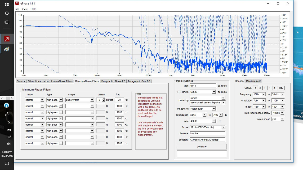

So I got the cascade implemented just as you drew out.
And this time I did it right.
Sorry for all my double posts (it’s the old man in my spinning my wheels)
As far as this
What if those speakers don’t roll off picture perfect,
I’ve been using peq on the speaker output to shape things. Wouldn’t that affect the phase of other speakers? Should I be using global eq on everything?
Like my horns crossed at 1000LR4, do I match the drivers gains to form the crossovers so I can use global eq on everything? If I want every crossover and eq to globally affect everything which I realize is ideal how do I solve the +15db peak at 4K in my horns and the +6db peak at 1.6. On horns without killing the efficiency at the top end.
If global eq is ideal I’ll figure out a way to make it work.
So the results. Got it all dialed in and working and sounding great.
A few points
1. I had no idea that it would be noticed this much especially the horns and subs
Adding the 2nd low pass on the sub made the midbass sound like the crossover was dropped an oactave and everything sounds much more “open” and airy.
And the singer voice sounds more real and life like rather than sounding like coming out of a pair of speakers. I always thought about an oactave past the crossover the speaker is no audible so why would it matter. But it seems as if it’s not attenuating anything, it seems like adding the cascade pushes the timing on the sub and horns in a way that lines them up with all the midrange frequencies.
The snare has attack now where I’ve never really experienced that before. Very interesting trick, I’ll always do this now. So thank you!
2. To get the midbass to get this awesome effect that makes them seem to play lower and the sub sounds more in front , with the sub I basically had to turn off the time delay between the midbass and sub. It doesn’t make perfect sense yet but I think it’s the long wavelengths or the reverb time of some kind causing this. I had 2.5ms delay of the midbass to time alignment them to the sub and that seemed to make things worse with your cascade trick. I basically just have the sub and midbass all come out at same time now even tho there’s path length differences. Definitely a lot more ambiance down low especially and up front bass that I’ve never had before.
Now on to my question.
So if linearization makes the crossover spin disappear why do I have to have this cascaded crossovers on all speaker and the firs? Can anyone in a basic dummy way explain how that works. I’m trying to wrap my head around this, I’ve run all the sims in rephase to try to figure out why and can’t make sense of it.
Thanks in advance

To do that in reality means that you need to EQ each driver individually to flat at least an octave or two either side of the crossover with minimum phase EQ, time align then add textbook linear phase crossovers. The rolloff at either end will most likely not be textbook 2nd order but you can EQ to that if desired.
The idea of the global EQ is to use that to set your overall target curve and by doing that with minimum phase EQ you will not upset the crossovers that were EQ'd and aligned separately.
I'm not sure that you and Byrtt are on the same page. That graph is an idealised representation of the crossover points and slopes you could have in a 4 way system with 2nd order rolloff's added at either end, because the crossovers are linear phase they add back to form a minimum phase sum that that matches the amplitude.

Maybe I confused you before saying not to input them directly, I should have said if you want to look at the cascade of filters ignore the low and high ones as they represent the system stop bands in the simulation and may not be what you have.
If you cascade the three crossovers slopes you will see what effect it has.
Here is an example using the low driver, comparing the LR24 at 80HZ in blue to the cascaded version using LR24 at 80Hz and LR24 at 300Hz.
The start of the rolloff is the same but gets to be a 48dB filter further along.If you add in the 2000Hz filter the change happens somewhere around -140dB so for real use it would be fairly safe to leave it out.
You could do the same thing by cascading the LR24 filters with IIR and then use filters linearization in a global FIR to undo the phase turn of the crossover filters. That would likely save you taps in your mindsp units.
Maybe it is this change in crossover slope that you like. The change only happens at -40dB so in reality it should be a fairly subtle effect.

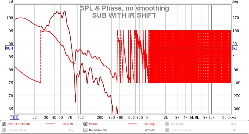

So, going back to my original post. The closed box linearization that I asked about. I think what I’m trying to figure out or learn in a simple way is.
Let’s say out of the car the box rolls off at f345 QTC.83, in car I get fairly flat to about 16hz. I do have to use eq at 66hz (you hit that on the head) and take it down -6db peq Q 1.4 to be flat to 20
My question is, if the box , the cabinet causes a natural roll off at 45hz but the room boosts below it and you say it acts as a Linkwitz Transform, that would mean it’s minimum phase and doesn't need any farther work done from Rephase
I was wondering I guess if room gain is minimum phase now that I think about it

That was pretty much the discussion that was had above. If you linearize the sealed box you will change the phase away from minimum and end up with a phase that does not follow the amplitude response.
Measure the result you have and use REW with a FDW to clean up the phase, generate a minimum phase version in REW and compare to what you have. If there's excess phase you can export that and use rephase to try and correct for it and see if you like that any better.
...My question is, if the box , the cabinet causes a natural roll off at 45hz but the room boosts below it and you say it acts as a Linkwitz Transform, that would mean it’s minimum phase and doesn't need any farther work done from Rephase
I was wondering I guess if room gain is minimum phase now that I think about it...
First will say remember room is global so don't count its corrections dedicated for the lowest pass bands but as global for the summed system passband, and yes room gain is of minimum phase except the reflections that arrive late at listening position, one can repair late reflections but think forget about it because correction only works at that particular spot in space where microphone was positioned. Reflection free is no room but we can get superior sound with a perfect dialed in speaker system corrected for room gain and a house curve that is tweaked to suit the speaker/room profile.
Below is sim model your system HP stopband with the red curve, you can see the numbers in first row, next i set the program WinSpeakerz model for auto cabin response with the numbers in second row. Now look the blue curve it is hot and worthless in you get a flat boost all the way down to DC, this will sound bloated with DC thumbs and mud sound signature way up into higher frq.
Cure for that if WinSpeakerz model is spot on is a linkwitz transform as the first two rows below, first it linearize your HP stopband to flat in row 1 then in row 2 the new 66Hz HP stopband is set, now we are flat down to DC because remember your system is at 2nd order 66Hz corner and auto cabin response boost a 2nd order 66Hz flat down to DC, therefor set some HP filter in area 15-20Hz (15Hz 2nd order used below). Overall correction is the blue curve and red curve is your new speaker plus room HP response, hope it makes sense ...🙂

so here is some measurements of just the sub at listening position, I also took screenshots of the eq pages even tho its not in measurements.
In can post up the actual file or send it if it helps.
I would love to know what to do!
the sub seems like the hardest part to get sounding the best

here is the mdat
And those measurements do have the linearizations applied and a 80hz crossover applied
There’s a big dip I don’t know what to do with and all that room gain
here is the mdat
so I did this in rephrase, it sounds good..much better with butterworth 6db 20hz hpf
but I don't know what to do with excess phase.....
do I make it flat? look at that around 80hz geesh
this is what I meant by hard to figure out sub measurements...the midbass was much easier
RED is unchanged measurement, blue is the correction ....what am I missing

I don't understand what is in the mdat is it a raw driver response or with correction ? And if so what correction.
Attached is a low cycle FDW with generated minimum phase to show what it should look like and another with what is in the mdat. The phase goes the wrong way in yours which makes me think you have processed it.
The phase jump at around 85Hz is a boundary interference null. I think you will probably have to leave that alone unless you can treat it acoustically somehow.
Sub only at listening position
No eq just crossover turned on and textbook 80hz linearization
When I took that I just plugged my sound card right into the minidsp that runs sub , so it was missing eq
I was hoping to see what I should do about the excess phase around 70-80 hz
And elsewhere and just post it so it could be seen as what I should actually be doing with the sub.
Aha ! So I won’t mess with that than. Yes a back window is in the way !

The 6db subsonic really cleaned things up, and I didn’t know what else to eq because I didn’t know what eq or where to use the eq.
I always did it on the sub output now it’s gloabal , and wow the system sounds so much better now.
The horns sound way more in tune with the bass it’s ridiculous how much better it is.
The 80hz phase issue is what it is. Still sounds way better than before.
I lost a ton of gain but it’s still plenty loud enough for me.
The 12db BW subsonic sounded like too much of the very bottom end was taken out
The 6db BW sounds great, (that was the best improvement)

It would probably be useful to get a measurement without any processing or EQ, to see what the basic driver response is. With that sort of cabin gain you might be better off eq'ing the slope to what you want rather than flattening and using a textbook crossover. You might get some gain back that way.Sub only at listening position
Try a close mic measurement as well to see the difference in phase, because something is sending your phase the wrong way.
FDW is just different gate lengths at different frequencies and can be helpful to see the direct wavefront before it gets messed up by the room/cabin. In your measurement reflections are happening early due to the small space. I don't understand what a FDW and minimum phase have to do with each other?Aha ! So I won’t mess with that than. Yes a back window is in the way !
I thought weren’t supposed to use FDW on subs. I thought it was all minimum phase and didn’t need it (what I read awhile back) so this is interesting
Why not use it if it helps you to see what is happening?
