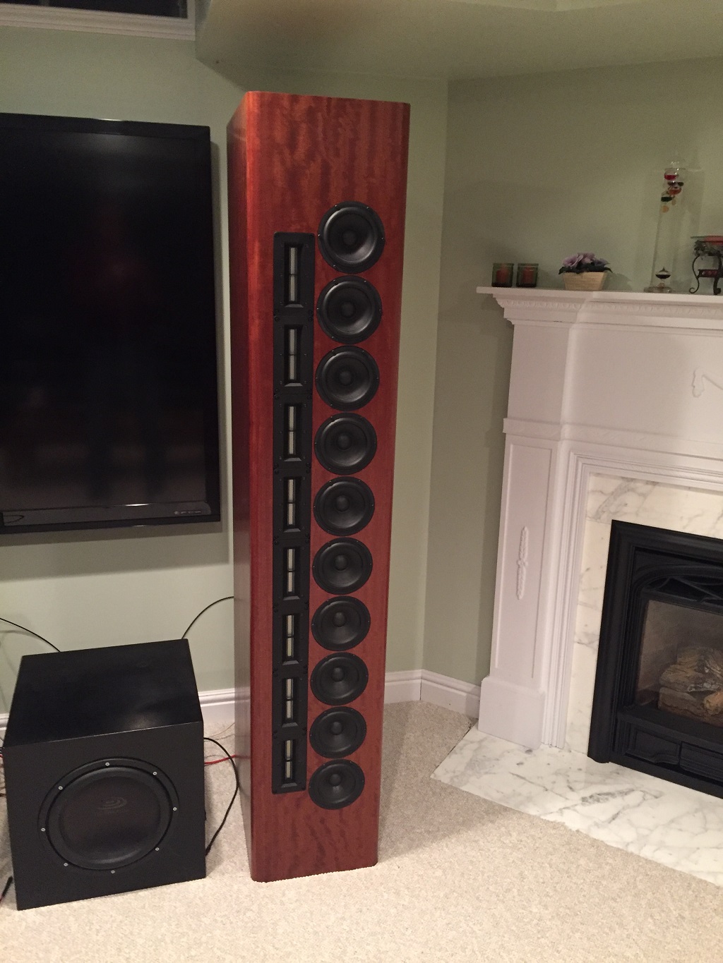

My right speaker.

First and foremost, thank you for taking the time to help me figure where I’m getting off track here.
Despite being a very well written tutorial the learning curve here can be a challenge for those of us new to audio measurement. Let me take you step by step on how I got where I am right.
I took the nine measurements for each channel with the acoustic timing reference enabled and all seemed to go well.
When it came to averaging them I did have FDW enabled and as is outlined on page 2 of the tutorial. I first time aligned the nine measurements. I then smoothed them at 1/6 before vector averaging for the final result for each channel.
Following the instructions below I created the EQ filters for each channel. My goal was NOT a flat response. My goal was to flatten the response using a modest amount of filters. So now I saved the EQ filters for each channel in .XML format to be imported into Rephase. Up to this point things seemed to go very well. I easily imported the averaged response from each channel into Rephase along with the matching EQ filters. Perfect!

Next, following the instructions I didn’t seem to have any issues creating the corresponding correction impulse for each channel. Keeping in mind the correction impulse was created with the averaged measurement for each channel having FDW enabled.
No problem, if this is your first measurement attempt you picked a steep curve to learn on 🙂
The vector average needs to be performed first before any other form of smoothing or windowing. The timing reference should have aligned everything. Check the impulses of the individual measurements in the overlay screen to see if they are aligned correctly, if not move them or use the time align function before vector averaging.
If you smooth or window the individual measurements before averaging it will give an incorrect average. Don't throw the data away at this point.
I don't really understand the reason for that but ultimately it's your choice. As long as you are EQ'ing an actual problem that will respond well to EQ there is no reason to not use as much as you need. EQ below 500Hz is safe in most situations as the response is dominated by the room. Above 500Hz be careful because the power response of a speaker with a crossover between horizontal drivers is going to be problematic, you could do more harm than good.

My first goal is to master creating a minimum phase system. After that I'll tinker with amplitude.
Dan
That is getting things the wrong way round. Correcting amplitude response is considerably more important than phase response. In a minimum phase system getting the amplitude right means the phase will follow so start there and leave the phase correction till later.
