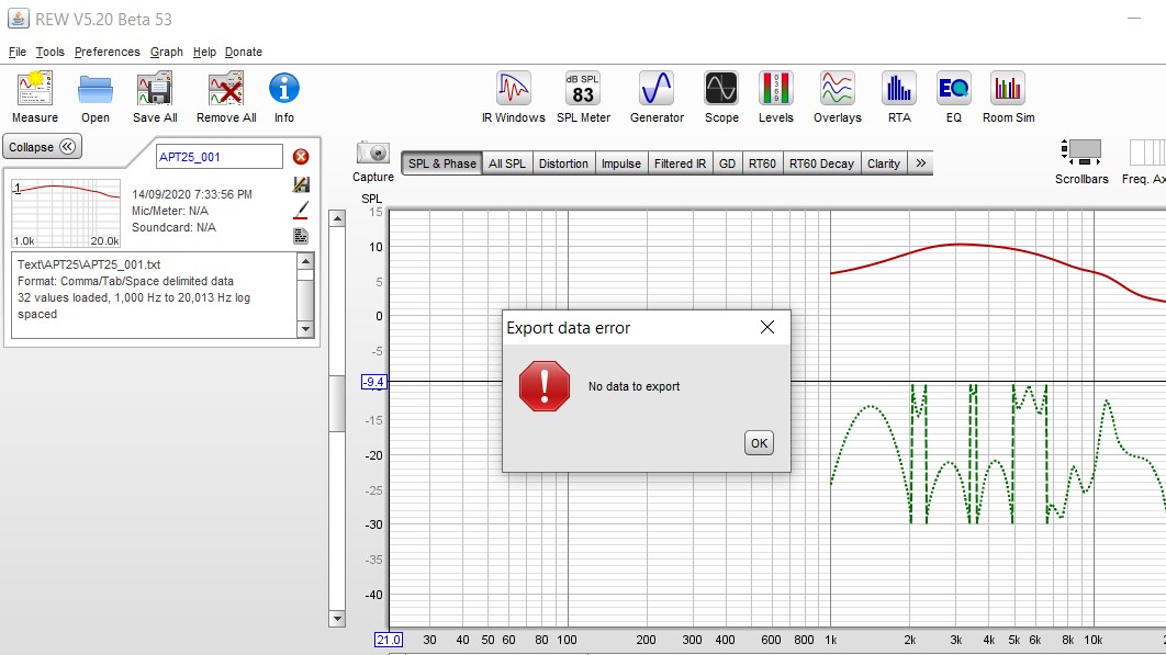

I am I just tried it and it says no data to export, have you tried it?
Once you got your frequency domain (phase+magnitude),its a transform (FFT) of the impulse.
Take a look at the export tab.
Have you actually tried to do it? Import a frequency response, select export Impulse response as wav, you get no data to export.
If you import a frequency response there is no data in the impulse tab or anything that is derived from the impulse tab and as far as I know no way to get REW to generate it.
I understand that it can be done but REW doesn't have a function to do it that I can find. I am happy to be proved wrong if you can show me how you have done it.

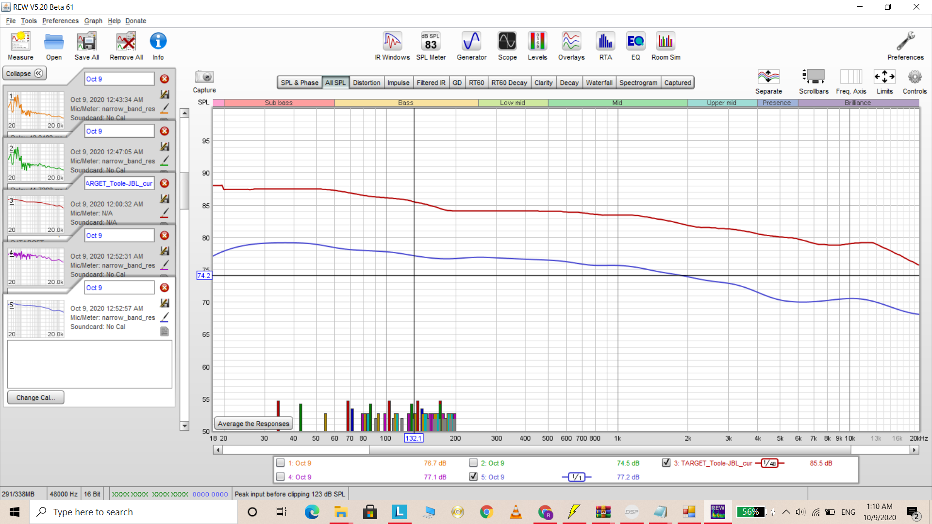

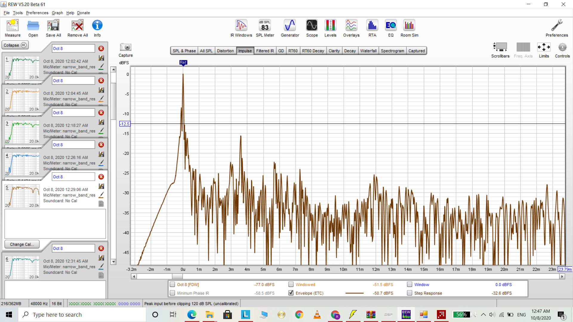

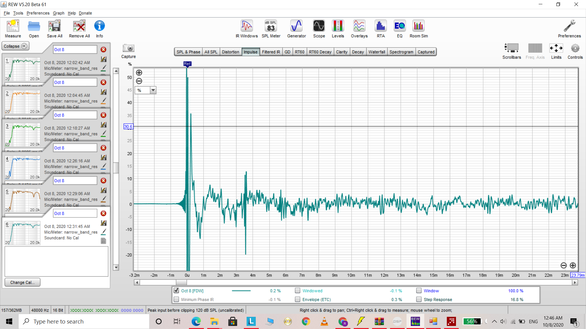

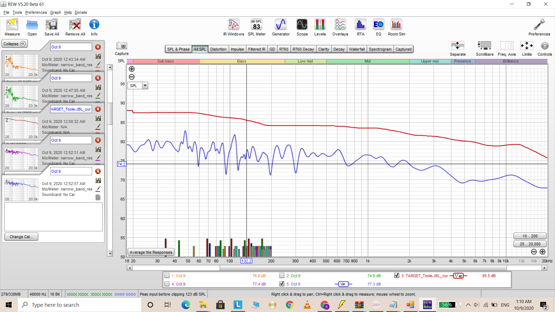

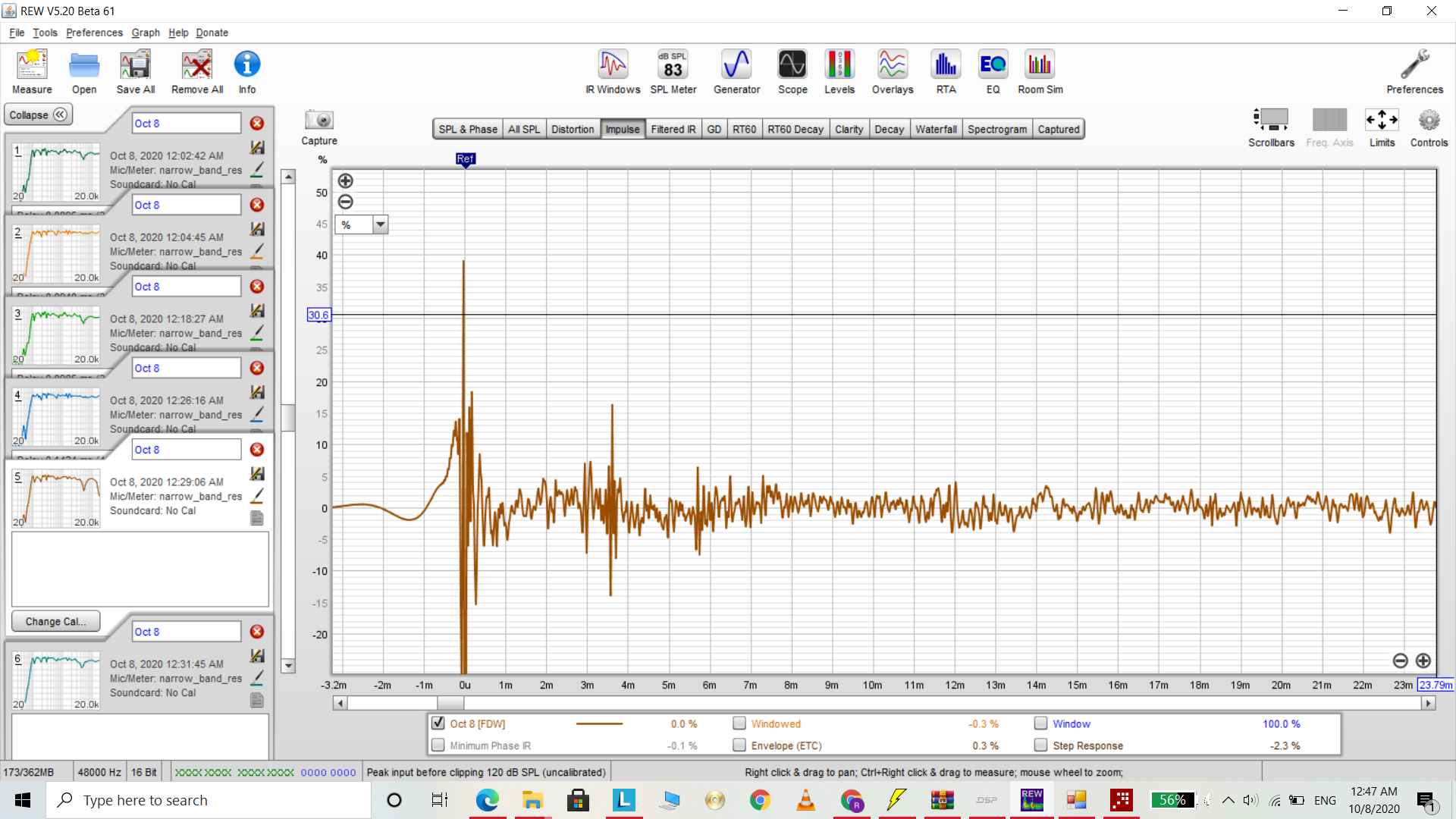

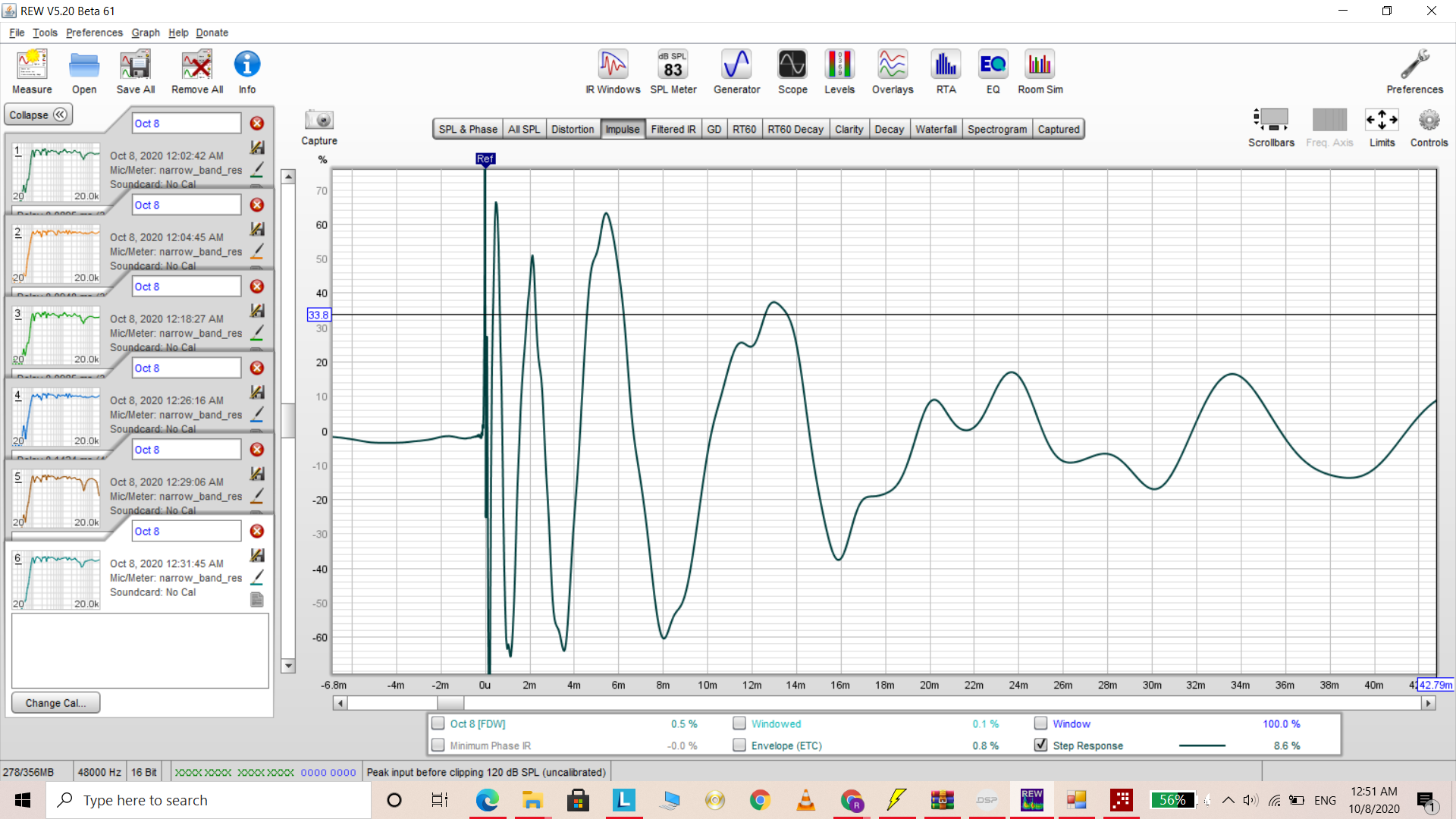

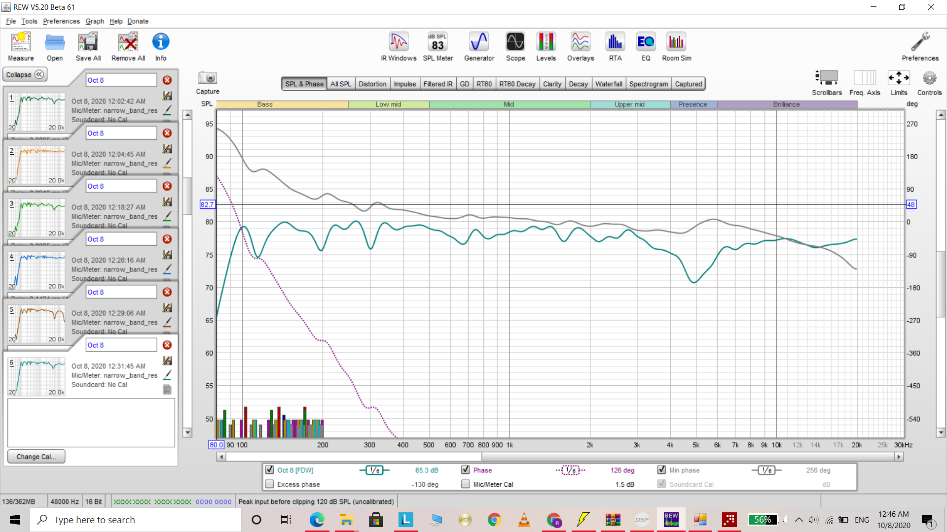

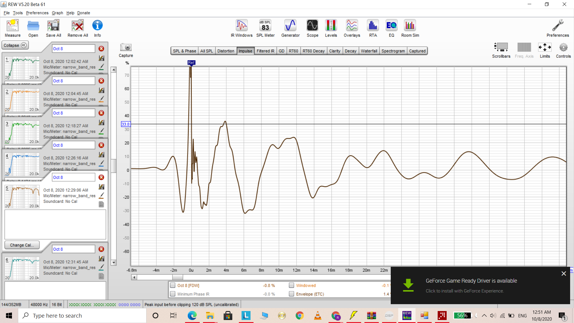

just like @fluid said, to generate the excess phase , i did make some improvements though i would say, i lasered the distance between the speakers and the LP
set the mic right in the middle and took 1 left and right measurement, applied PEQ and fixed the phase with Rephase, below are the attached pictures (brown with the FIR fitlers cyan without)
would appreciate your opinion and tips on the pics i just uploaded in the other reply, tell me what you think pleaseThe reason to import it back it is to generate the excess phase version for correction based on the vector averaged measurement. To do that by loading the FIR filter would mean another 9 measurements.

I don't see much difference between them other than a different impulse shape and more movement before the peak from the phase correction in the FIR.
My thoughts would be the same as before, leave the phase alone until you have got the basic PEQ where you want it. The only excess phase left after the first PEQ correction comes from the crossovers or non minimum phase room effects that are in the measurements. Trying to fiddle with these things should be the very last step in the process if you do it at all.
Getting the right tonal balance is probably the most important aspect to making a speaker sound good. Personal taste is a big factor too.
If you can post a link to your mdat from google drive or something like that I can have a look at the measurements for you. The one with the individual measurements used to make the vector average.

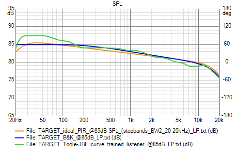

Have attached three alright target curves in below zip-folder to play around with, within their tonality sceme one should come a long way but of couse adjust for tiny other taste or system deviations, they are what is called "in room response" at listening position or "estimated room response" or "PIR (predicted in room response)" and typical with that curve dialed in at listening position then speaker system if it was measured in anechoic condition or close nearfield will show a flat curve, they hover around 85dB SPL area normalize/offset them your self into REW to whatever SPL..

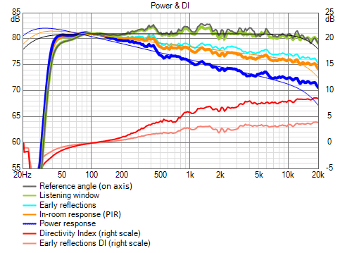

Here is example of a good Genelec performer 8341A measured anechoic over at ASR site, note how the PIR curve follows close to one of the above targets..
This is VERY interesting. Thank you for sharing.@zallou3,
Is there a research paper on this? So many questions come to mind when reading about this.
E.g:How would different room sizes with a different absorption rate affect the frequency response ?
I assume the difference between the anechoic chamber and listening rooms is mainly the reflections, so that must be what's causing a hot bright listening experience.
And how do they figure out how the response would be in a listening room? Are they using trained ears only or something a bit more scientific?
The target curves Byrtt posted will get you right in the ballpark. One thing that can change the preferred slope is how loud you like to listen. I like the 0.8 to 1dB/oct slopes but the louder I listen the more I prefer the sort of slope that is flat to 1K and then slopes downwards after like the original Bob Katz curve or the B&K curve.
The balance of a speaker can be affected by quite a small change. I prefer the bass to flatten off at 100Hz. I find to have the level below 100Hz to be higher than above is too much for me. The balance between 200Hz and 100Hz is quite significant and a change in Q or level here can make a surprising level of difference.
To find my preferred balance I use a set of shelving equalizers that can be changed to affect the overall curve in different ways and by moving them in real time you can hear the difference that they have on the sound.

Again,very helpful. i live in lebanon and not a single acoustics book is available in my country, i've started researching and already found a few research papers on the subject.
I've tried the curve prefered by the trained listeners in Floyd's research, i'll attach pictures(red is the target curve, blue is mine, one with variable smoothing the other with 1/1 smoothing) it sounds pretty good already and i'll play around with tweeking it.
FLUID.mdat - Google Drive
does this work?
