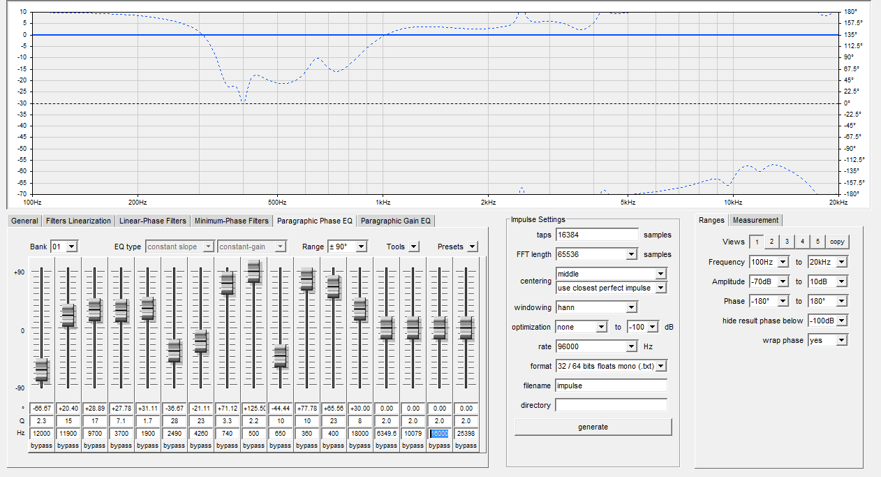

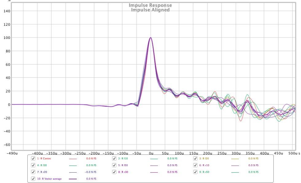

When using rephase to minimize the phase of my speakers should i avoid micro managing with the Phase EQ? Or is it usefull to bring every point of the phase to zero? I used 13 Phase EQ filters.

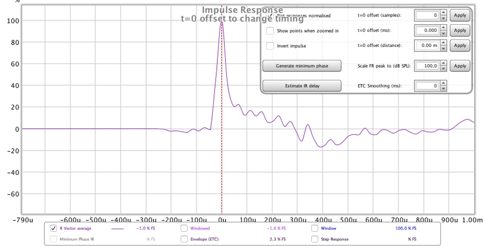

Here is my result:
Here is my result:
Mops1337,
Would you share some more info on physical speaker, measurement point in space and target goal you want to achieve there.
In general its so that sound waves starts as minimum phase so if they smoothed out using minimum phase (IIR) correction then phase will follow and smooth out too, so as for your curve that have ripple in amplitude domain then there should also be ripple in phase domain, problem is in acoustic domain to have good trust full measurement to base correction and the training and knowledge not to try correct into trouble areas that is impossible to repair in electric domain.
Could be wrong but it looks you try to linearize excess phase from a IIR XO point with 13x Phase EQ on "Paragraphic Phase EQ" tab which is doable but difficult job, instead use "Filters Linearization" tab for that job, below first attachment is yours phase settings set by its own where second is close to same using smoother 4th order phase correction at the other tab and third is example a 8th order correction because it looks your phase wraps around 720º in that area.
@BYRTT : exactly!
I made good experience when making the pure minphase-amplitude EQing in a first step to have a reasonable curve that sounds good, leaving the phase alone, till the magnitude verifies to sound just right.
Then, second instance, I measure the whole speaker as bunch, on listening position, and apply the REW frequency-window very tight, to 3 cycles for example. That's in most cases sufficient for 2-way or not so steep 3-way setups to fit into the window. That result is smooth due to EQ earlier and the smoothing side-effect of the windowing, leaves smaller risk for overcorrection.
If it may not fit, you can always run multiple instances of correcting the correction, each time with 3 cycles. That pulls the response tail closer and closer to the peak, without risking prering in most cases.
At the end, I always check that the total phase does not come earlier than the generated minphase at any point, rather always sliiiightly later.
So in a nutshell, excess-phase correction can be done in a very very short window, other than the amplitude.

Good points and approach there Joshcpct think Mops1337 could try copy that and also suggest down the road make trials with some less hot amplitude domain above 1kHz.

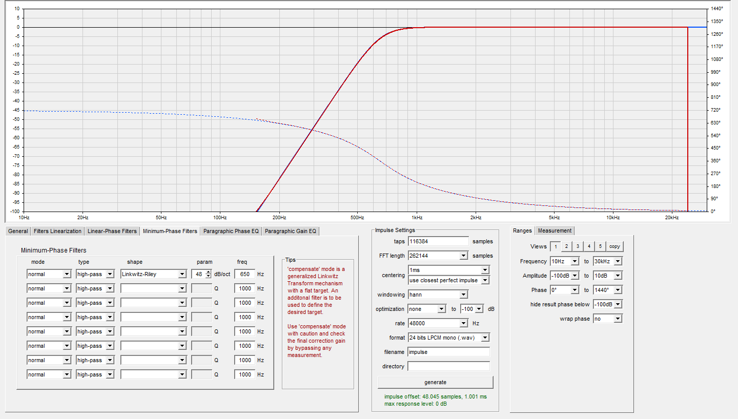

The 3-way studio monitors I'm building are almost finished. I bought an OpenDRC-DA8 to filter them.
I was thinking using 500Hz and 3800Hz as crossover frequencies. We can do measurements outside with an EMM-6 on a Roland UA-25. The speaker should have a low latency of let's say <10ms if possible.
What would be the best approach?

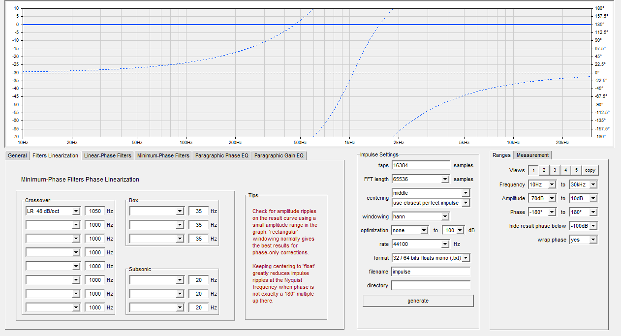

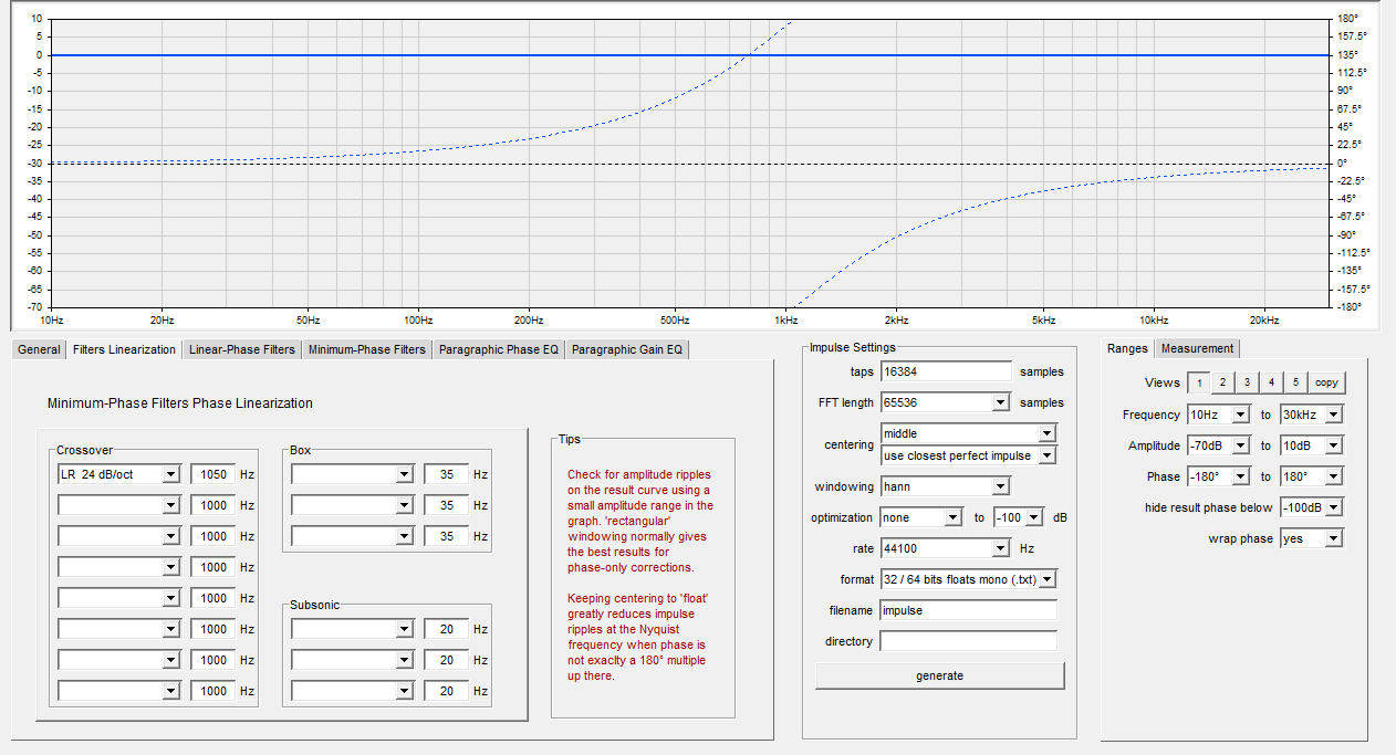

Hello WalterPPK,
You can build a minimum-phase crossover in FIR and get almost no delay out of a direct convolution box like the openDRC. You can also use its IIR capabilities.
You can latter choose to replace minimum-phase crossovers with linear-phase ones (or linearize the phase of IIR filters) at the cost of some additional delay.
The 3800Hz crossover will not be a problem in term of delay, but the 500Hz one might be. A gross approximation would be around 10ms of delay for a linear-phase 24dB/oct 500Hz acoustical target, and 20ms for a 48dB/oct one.

Mops1337,
Thank you for your response.
my Setup:
2x XTZ 99.25 Speaker
1x XTZ 10.17 Sub
Pioneer VSX 2020 Amplifier
MiniDSP 2x4HD
My measurement environment
I am sitting in a corner of the triangle created by my two front speakers and me. Sub is on the right side near my right speaker. As a DSP i use a MiniDSP 2x4 HD. My microphone is about 4m away from each speaker.
My goal
For measurements i use the MiniDSP UMIK-1, and REW/rephase as software.
For the last years i just used REWs automatic EQ tool, which gave me good results in past time. But now i want to try something new with the 2x4HD and its FIR Filters. The DSP has 2042 Taps per Channel, and a sample rate of 96k. So i dont have the possibility to create linear phase crossovers, because i dont have enough taps. The crossover at my front speakers is a IIR Filter LR 24dB/Oct at 90Hz. My goal is to get a system which has a very small phase response
What i tried so far
I tried to follow the tutorial i found here in the forum: Dropbox - REW_rePhase_tuto.pdf
I did 9 measurements per Channel, timealigned them and created a vector average of each channel with a FDW of 15 cycles. For the measurement i used a Sweep from 150Hz to 18kHz. I did the measurement around my head with the parallelepiped method. Is it correct that i sit in place and hold the mic while the measurement? Or should i use a microphone stand?
With that vector average i created some EQ filters and did the excess phase. It was my goal to bring the excess phase down to zero. Is this usefull? My result(just the left speaker) is what you see in the attachment.
Is this method correct? Maybe you can give me some advice what i can do better? Maybe you have a method which gives me better results?

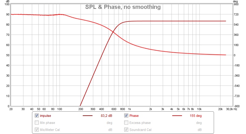

The loopback will remove electronic propagation delays and give a consistent baseline but when you move the mic from side to side for the averages the impulses will still need to be realigned to some extent anyway.

@ Mops: sounds good, in general that's all fine
@ Rajapruk: chaining works for convenient drafting as first instance, but the delay and the noisefloor of bit-rounding is doubling/increasing. So I wouldn't keep that for listening, only for measure test.
reg. the loopback, that's useless for speakers, as its just taking the few milliseconds of the loop out of the measure.
Your measurement contains digital buffer, delay of elec. devices, time of travel through air to the microphone. All that is linear on all frequencies and therefor irrelevant. The delay detector (REWs IR peak finder) eliminates all of it.
Time alignment of speakers isn't that easy as the phase is always relative to the frequency.
The most reliable reference is always a tweeter.
But u cant sweep twice (second time only tweeter) as each time u trigger a sweep, the buffer varies and such the total TOF...
So, the key is, to sweep a speaker with a UHF tweeter that has significant delay (to visually differentiate the IR). By knowing the specific offset of UHF delay, u can measure the IR peak distance and subtract the "artificial delay" with a calculator.

The function to change the timing is in the controls panel of the impulse tab. Change t=0 either positively or negatively to align the main peak to be as close to 0 as possible. If the gap is large then use the cursor to work out how much you need to change set that value and then you can use 0.001 +/- to really get it exact if you want to go that far.
This is one of my average and individual measurements after I aligned the impulses

I am trying to go between rephase-REW-rephase, to learn.
I tried generating LR8 650Hz target curves in rePhase, to use in REW.
I can not get the phase right down low. I have tried a lot of different settings in rePhase.
What am I doing wrong?
