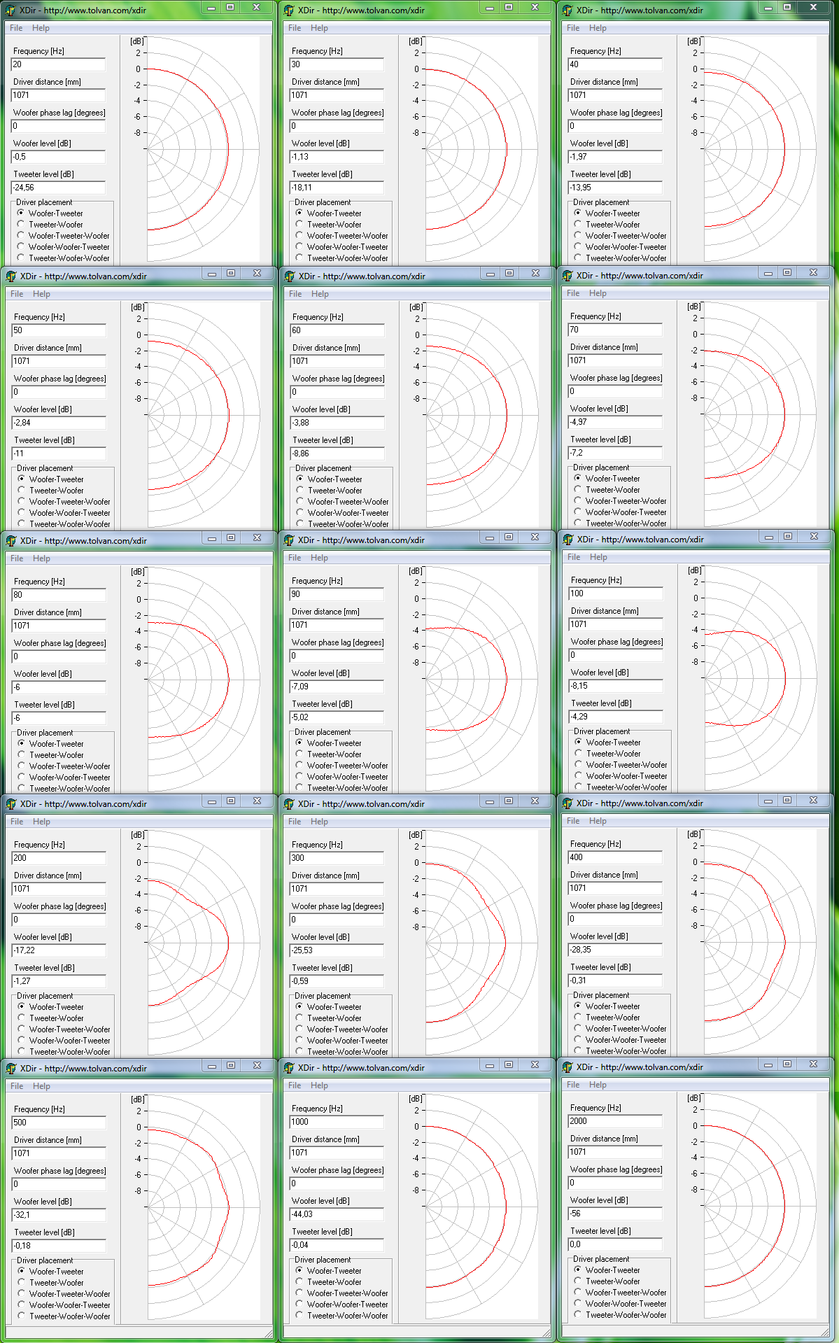

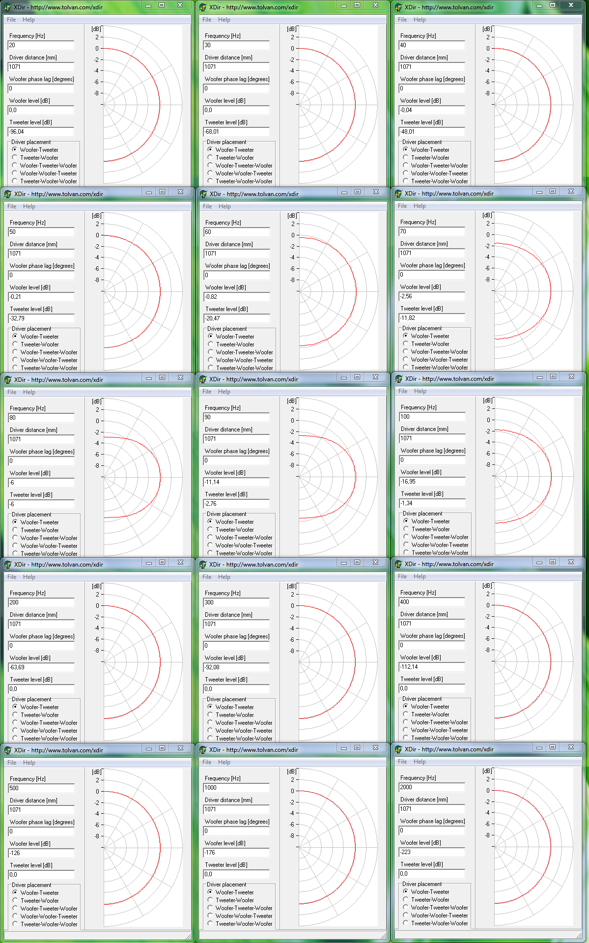

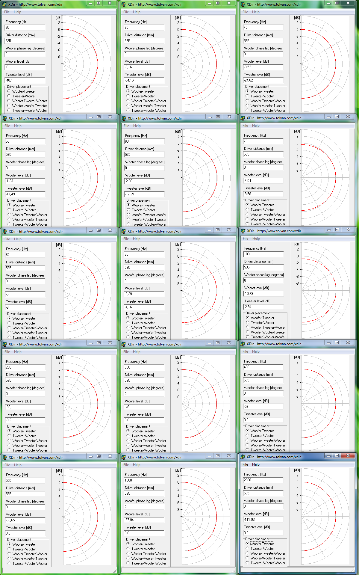

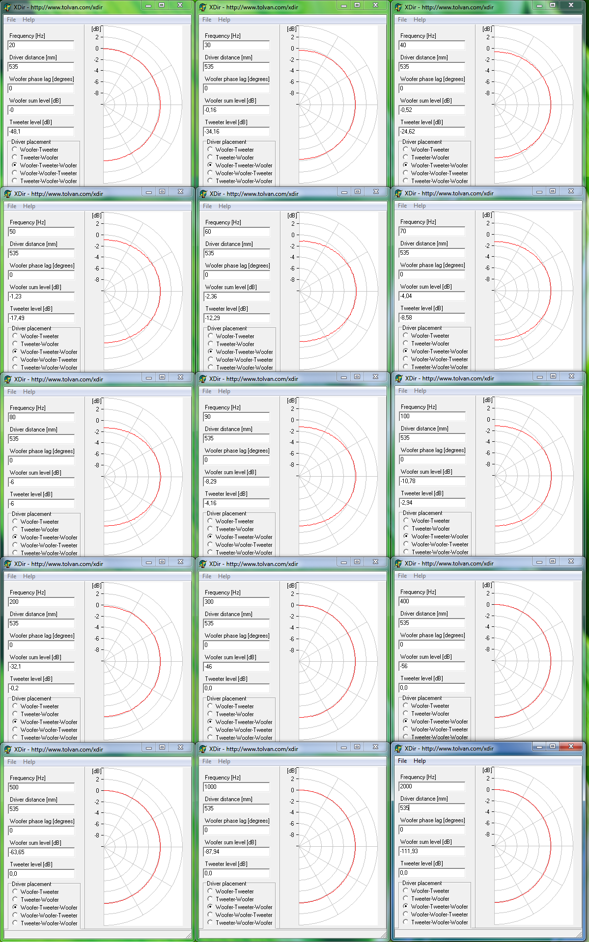

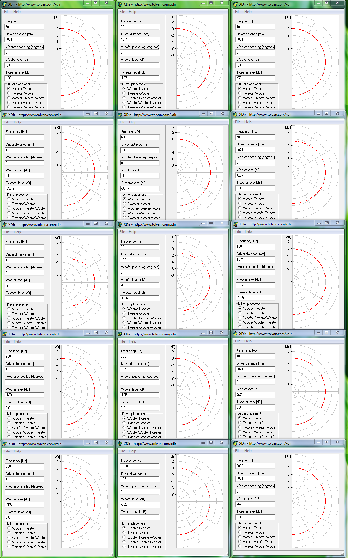

Sorry, one final argument. This might be wrong? I have feeling the dip in the power responce at xover freq gets narrower, but deeper when higher order xover are used. And more linear power responce is prefered by most listeners. Again this might be utter noncence.

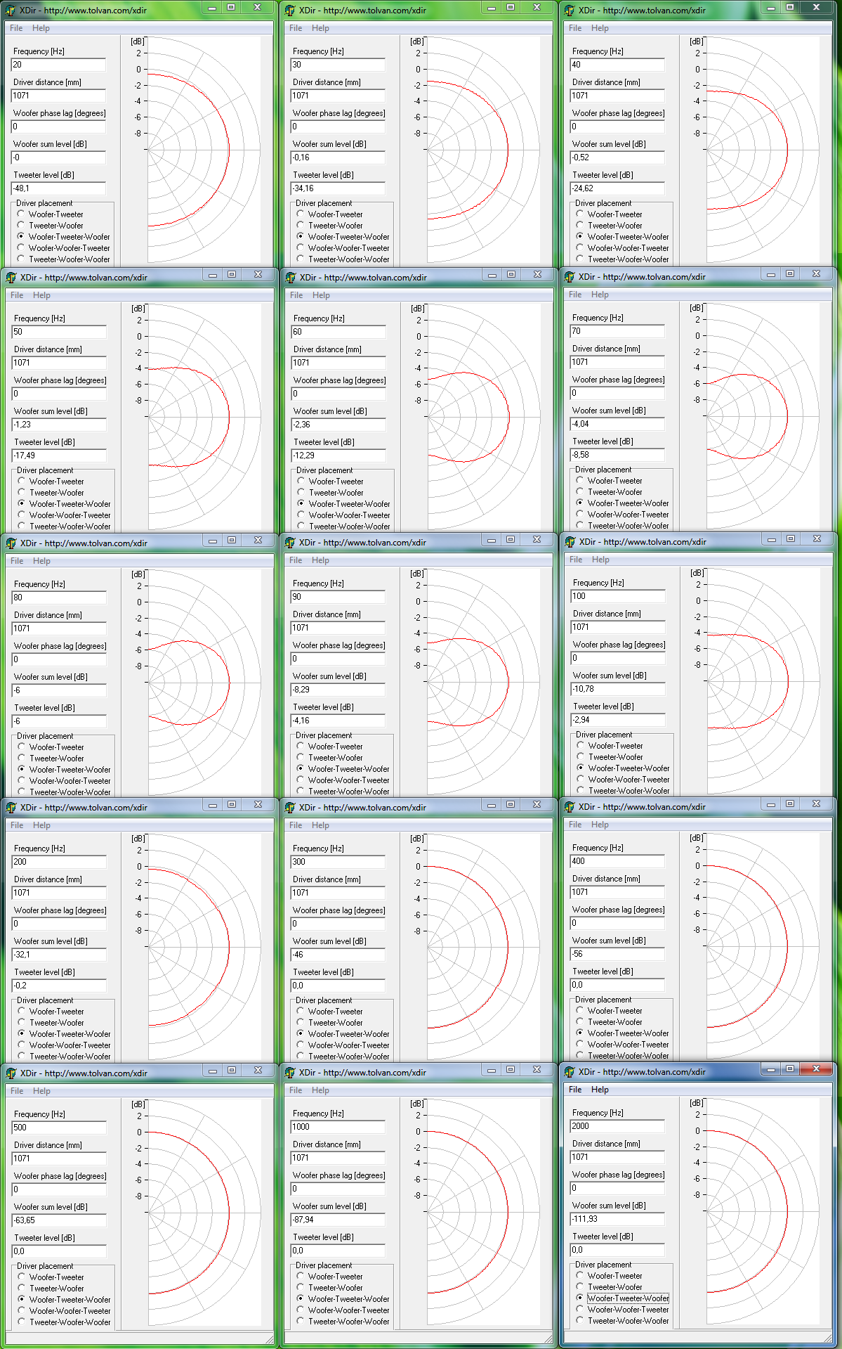

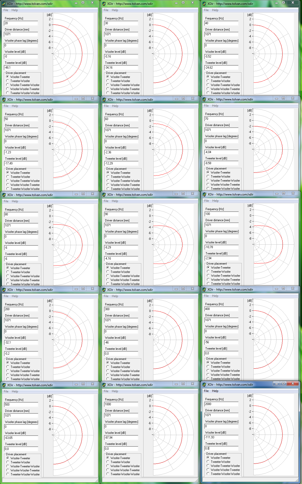

If my logic understanding of your expressed feelings is right, think you spot on power response dip at XO freq gets narrower the higher the order and think can be expressed as the logic that the higher the order the less the area can be distorted by adding a XO point, but its not any deeper than lower orders and here think the logic is they al sum at -6dB when talking LR topology. Think perfect linear power response is always good to dream about because real instruments and voices don't have this kind of distortion and it can be battled minimizing center to center distances, KEF do it perfect in a WT config using coaxial and most Synergy systems gets within 1/8 wavelength in a WTW config, we shall notice within same distances WT config always perform little better than WTW config.

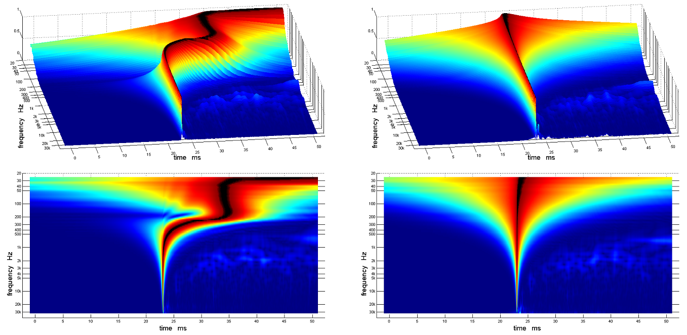

Even it was a lot of work Rephase was once again very helpfull to study theoretical vertical power response reading slopes level numbers and set them into multiple instances of free XDir, to read them visuals focus on XO point is the one at left side in the middle and frq steps lower values up above and higher values down below, it doesn't matter 80Hz is used in example relative other XO frq will behave the same. First four graphs are LR 2nd/4th/8th/16th order within 1/4 wavelength and think notice they exactly the same at XO point but the higher the order improve on transition area, in last four graphs they all LR 4th order but first two are within 1/4 wavelength WT config then WTW config, and the last two are within 1/8 wavelength WT config then WTW config and think notice how less physical distances or combined relative lower XO points than mostly seen will improve power response using XO points. Of course graphs are all theoretical based and don't know anything about real world non ideal polars from used drivers or any physical nearby or room interference.

You could be right about pre-ringing concerns, get timing right and don't do a bad repair, myself setup a 2-way 96dB/octave back in May/June and admit it was hard new territory get such two steep slopes feel its other at exactly same cycle but after that just enjoyed this bad looking exercise speaker, have since got dedicated computer hardware upgraded so JRiver DSP now runs flawless up at 192kHz with hundres of PEQs and also they released Jriver as real 64bit program, so with experience from past look forward setup same system with other woofer and a little higher frq for XO point so mid-tweeter get into a less stressing territory.
Pre-ringing and post-ringing 😛 when spacing being within 1/8 wavelength which one below will sound closets to real world sounds (measurement point about 74cm):
