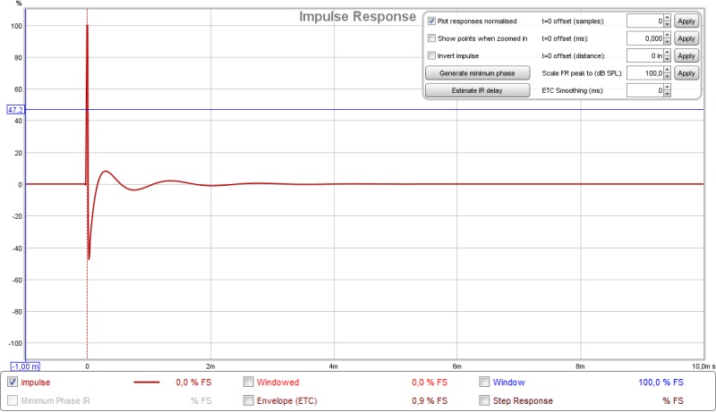

Impulse offset is about 1ms in rephase, but impulse peak is a 0 when importing to REW. Strange.

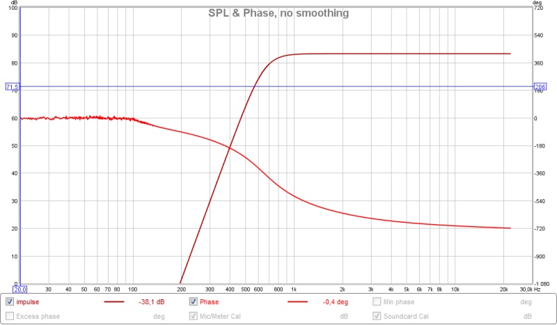

Level gets at 80dB in REW, but 0dB in rephase. Strange.

If you set "hiding phase result below" to -Inf in rephase you will probably see a red phase curve that matches the one you see in REW.

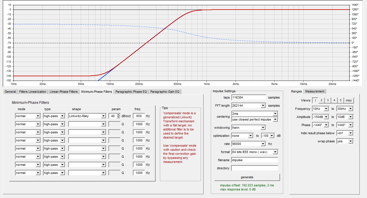

Now change export format from 24bit to 32bit and you might get a better result.
You can also try to increase the impulse centering value to take FFT errors into account.

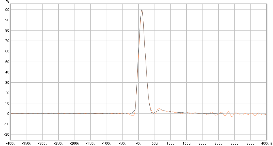

You are only getting issues at -140dB or so, even with a pretty good soundcard the noise floor will be at -110 to -100dB so this is 30 to 40dB below the electronic noise floor let alone the acoustic one in your room.
I tested the same filter and got the same response with taps from 16000 up to 131000.

My expectaton was to get a reference curve for spl and phase. But the steepnes of the filter makes the level go down too low then.
64-bit file maybe had made it.

Still strange phase.
I also tried "middle", even more strange phase.
REW says "16bit" in the bottom. I do not have my usb-soundcard attached. Is REW the problem now?
Set "hide phase" to -inf and not +inf in rephase and you will see the same phase behavior as what REW shows.

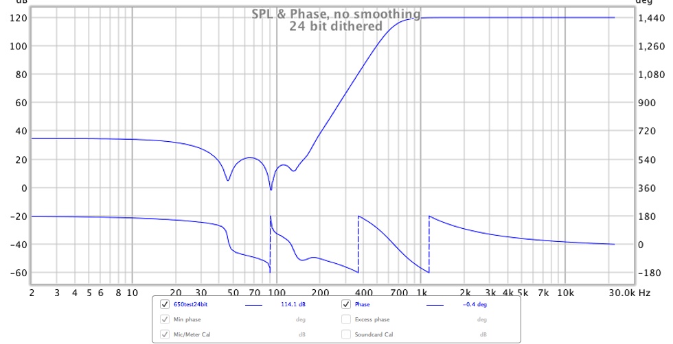

If you want something that looks cleaner you can import the impulse into Audacity and export at 24 bit which will dither the file and get rid of a lot of the very low quantisation noise.
This is a 650Hz LR8 made in rephase exported at 24bit from Audacity then imported in REW

I learned (I think) that REW changes T=0 to impulse peak, and changes magnitude level from 0 to 80dB, at the import of a impulse from rePhase.

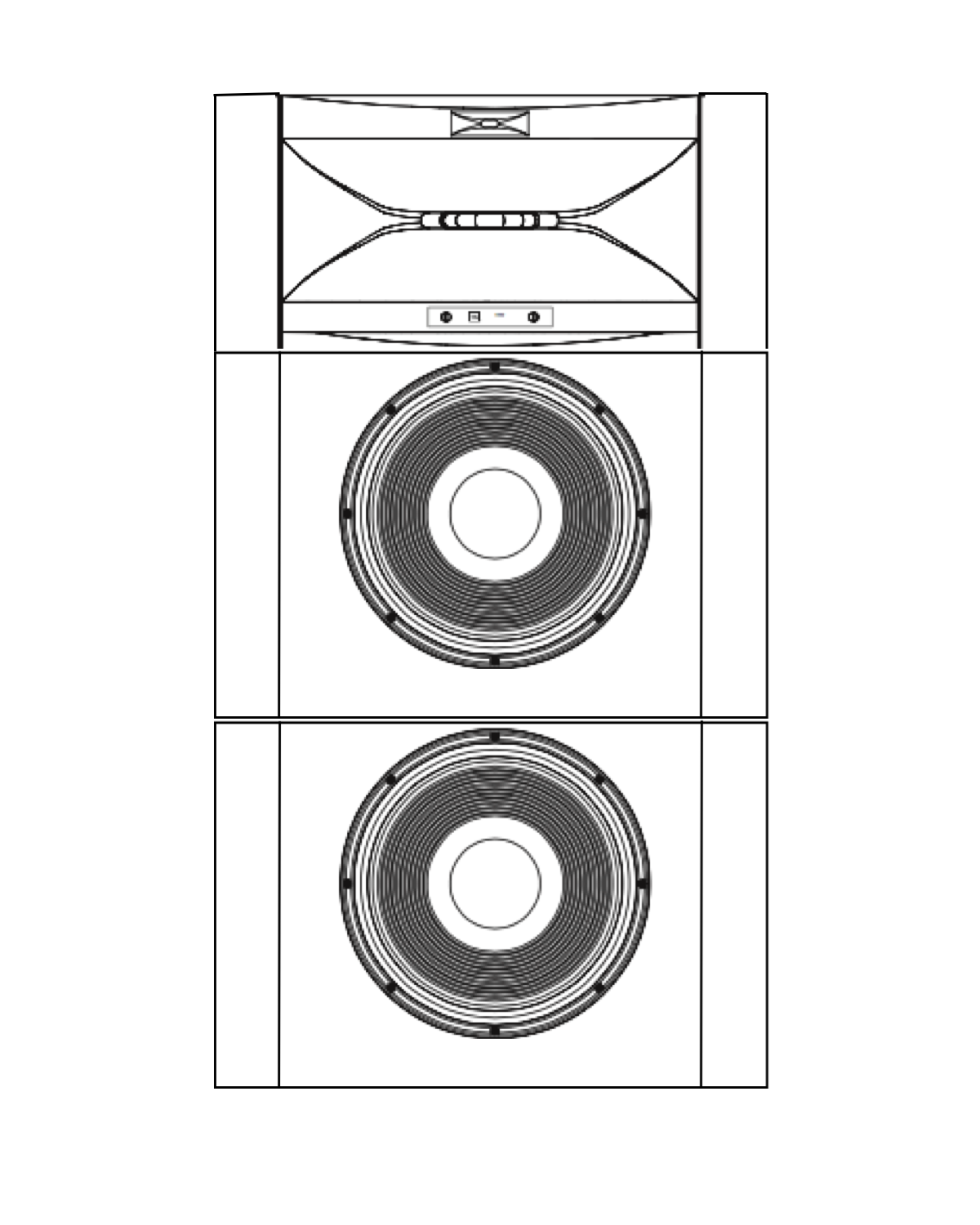

I am building a DIY-speaker with JBL-parts, see attached pic. It will be 2.5 way for starters, with dual 15" woofers and a 4" compression-driver. Maybe I will add an UHF compression-driver later on, and make it 3.5 way.
Closed boxes for the woofers.

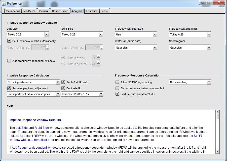

Your preferences in REW determine where it aligns the IR:
As fluid showed a few posts back, you can alter this alignment.
As far as magnitude goes, the scale in RePhase has a reference level (set at 0) and can swing positive (louder) or negative (softer) from that reference level. If you import a RePhase created IR into REW and it lands at 80 dB, that's your reference level.
The impulse offset in Rephase determines where the peak will be in the created IR file from RePhase. The room before the peak is there to be able to manipulate phase. In REW, as shown on the preference page that peak is set (aligned) as t=0. Two different things we are talking about here.
