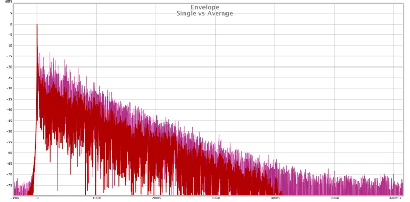

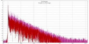

In my first test I used 22 separate measurements and it did a very good job of suppressing the room contribution. It also took most of the day to do so the next time I did 8 measurements for each side along the back of my couch in line with my ear position when seated 🙂
What the spatial averaging does is remove a lot of the position dependent room problems but leaves the dominant ones that affect the majority of positions. The method also weights dips more heavily than basic frequency averaging.

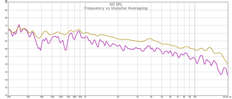

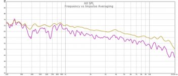

Gold basic frequency average, purple impulse averaged

Which of the average methods is most true to reality? The pronounciation of dips, is it ”real” or an artefact?

I honestly do not know which if either of the methods is more correct.
The dips are real but they can be "exaggerated" by the averaging. Look at all the different measurements overlaid and you will be able to see through "optical averaging" as described by Bob McCarthy. A big dip in one single measurement could dominate when all the others don't have it. Three measurements of 3, 0 and -3 when averaged come out to 0 it is representative of one value but not the other two.
