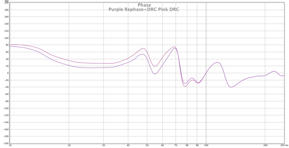

I am using rephase for a little bit of linear phase EQ and some gentle excess phase correction. I do intend to try as an experiment using rephase to do all the phase correction manually at some point.
This is the difference in phase of my DRC filter and the filter after rephase it is only below 100Hz. It doesn't look like much but it does sound better. More impact on kick drums a little bit less polite. This change makes it track the minimum phase more closely which was my aim.
