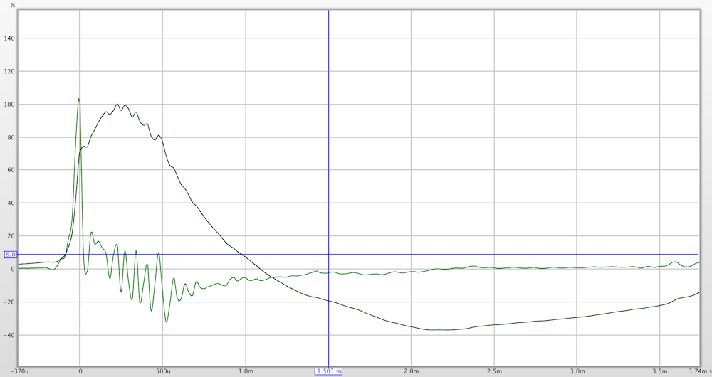

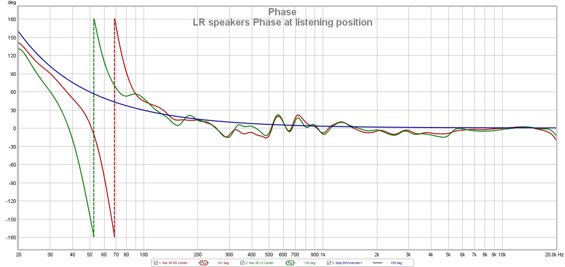

If one models the phase response of an "ideal" speaker, it is similar to the blue curve in the chart below. Of course, it depends on the low frequency cutoff and roll off slope for any particular speaker system, but if you play with different low frequency box alignments, the phase shape is more or less the same.
attachment.php

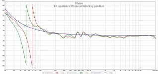

The red and green traces are my speakers measured at the listening position some 9 to 11 feet away. I used FDW and psychoacoustic smoothing in REW as it closely matches the correction settings used for the DSP FIR filtering.
I have experimented with just linearizing the phase in a 3 way system with a passive XO and must say I did not notice a huge improvement when I switched the filter in and out while listening to music in real time. However, when I time aligned the drivers using linear phase digital XO and then corrected the excess phase, I noticed a considerable improvement in the "depth of field" in listening. Almost like the sound went from 2D to 3D.
I am wondering if this is the same sense that wesayso and others with line arrays are hearing as these types of speakers are inherently time aligned and have no XO to mess with different time arrivals and phase...
Thoughts?

.....Thoughts?
Looks great and guess what we like to see after throwing DSP control into system, the impressing thing your case verse most other multi way systems is data taken at listening position and therefor guess performance is same sense or close to wesayso and fluid's line arrays, guess must sound very good so enjoy and many thanks sharing good stuff including interesting reviews and writing at other domain 🙂.

When I compare Frequency Dependent Windowing to Psychoacoustic smoothing in REW the issues in the response seem to flip around, they are dips with FDW and bumps with Psycho smoothing, do they look the same to you?
It seems logical that if the base speaker is more accurate in the time domain then excess phase correction would work better. I removed the last bit of excess phase below 100Hz with a manual rephase filter and it made a noticeable difference to the impact of kick drums. It took a bit of trial and error to find the right amount, it was easier to make worse than make better 🙂

This is an outdoor measurement of my uncorrected array, impulse and step

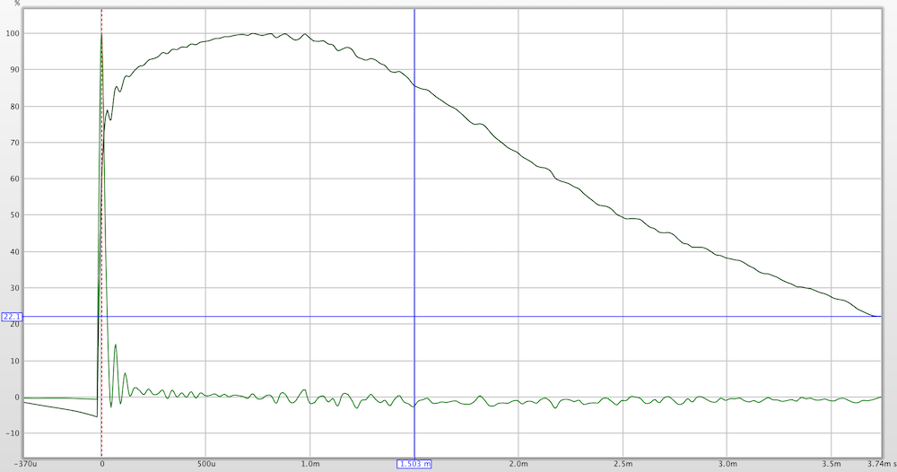

After correction indoors
attachment.php

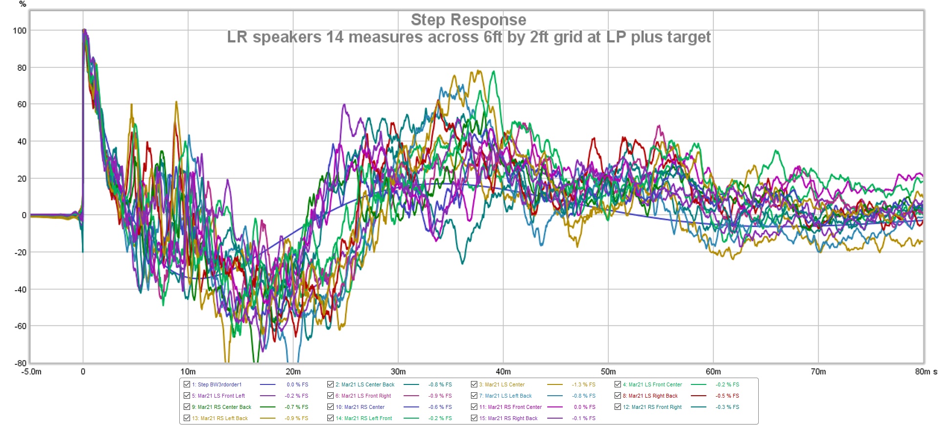

How large is the area/cube where the corrected arrays are perceived as time aligned?
The time alignment listening window can be quite large for multiway's as well. Here is the step response of the same active 3-way I posted earlier, except I took 14 measures of both left and right speakers over a 6' x 2' grid which covers my couch area at the LP:
attachment.php
The drivers are time aligned over the 6' x 2' listening area as indicated by the vertical "step" overlay at t=0. Moving the height of the mic up and down by a foot each way, produces similar results. I have overlaid the "ideal" step response as well. The peaks at 4ms and 8ms are the bounce off the rear wall from the measurements that were taken near the back of the couch area. i.e. the mic is (much) closer in distance to the rear wall versus the distance to the speaker.
It would in the vertical direction that I would expect the multiway changes more. Byrtt has shown before that by using very steep filters a multiway can get more even vertical response too. Probably not much of an issue if you always listen at the same height.
In my system I have found that using a spatially averaged measurement across my couch in a similar way that SwissBear has written about here before is very useful to base a correction on. On a single measurement I would need to use significantly weaker correction to avoid it sounding "processed". I tested the same strong correction with a single measurement as the base and it was terrible.
My room is quite reflective and has zero treatment so in a treated room the differences might be less.
