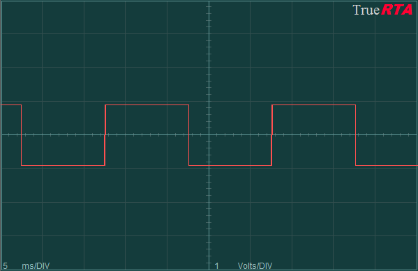

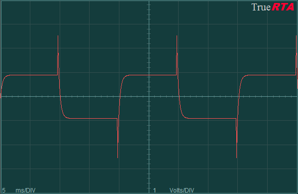

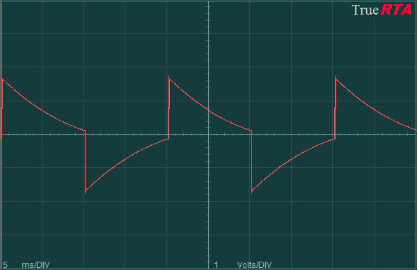

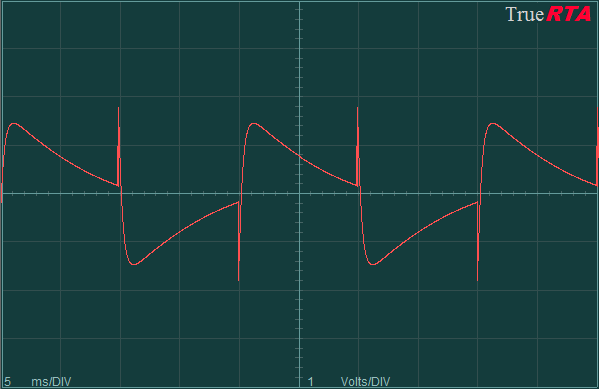

Right if its science for our hearing but that front also moves from time to time, regarding real world wave shapes i can do my own science and see output verse input is hopeless distorted no matter what we hear :).

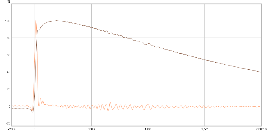

Wave shape output 50Hz SQ wave from a DC - light-speed domain:
633927d1504658724-rephase-loudspeaker-phase-linearization-eq-fir-filtering-tool-2000b-png
Wave shape output 50Hz SQ wave from summed DC - 500Hz pass-band with a 2nd order LR XO point then 500Hz - light-speed pass.band:
633928d1504658724-rephase-loudspeaker-phase-linearization-eq-fir-filtering-tool-2001b-png
Wave shape output 50Hz SQ wave from a 20-20kHz domain:
633929d1504658724-rephase-loudspeaker-phase-linearization-eq-fir-filtering-tool-2002b-png
Wave shape output 50Hz SQ wave from summed 20 - 500Hz pass-band with a 2nd order LR XO point then 500Hz - 20kHz pass-band:
633930d1504658724-rephase-loudspeaker-phase-linearization-eq-fir-filtering-tool-2003b-png

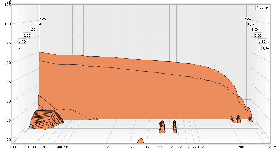

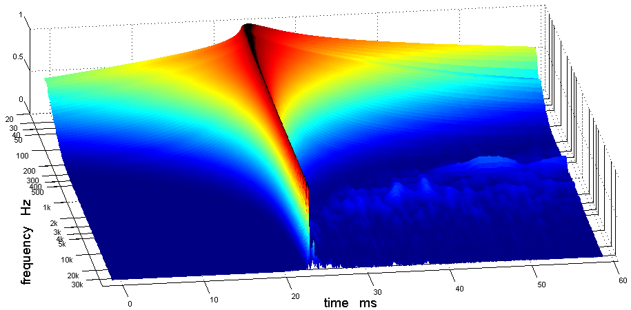

I rarely see CSD graphs... some people seems to have equalized perfectly their loudspeakers system but the CSD shows that their hear more resonances than audio signal.
Think can follow what you mean but can also follow what mark100 mean and actual pages back he shared nice CSDs, don't know if its rarely but up front below two-wayer correction clean up CSD.

Agreed, resonances will show as decays on a CSD, and as a bumps or dips in the magnitude response.
This is just a matter of using the correct visualization for what you want to show (or hide ;)).
You can't fix resonances, the only cure is to d'ont trigger them.

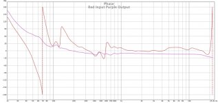

I have built a speaker similar to his and used a correction filter based very heavily on his where there is Excess phase correction up to 1K. The correction aims to follow the generated minimum phase of the frequency response at the listening position. There is a very audible change in the sound of the bass when changes are made to the amount of phase correction or if it is removed completely. This is more room correction (or room speaker interaction) than pure speaker correction. I have never tested the same sort of correction on any other speaker to know if the result is the same but on my line array the difference is clearly audible.

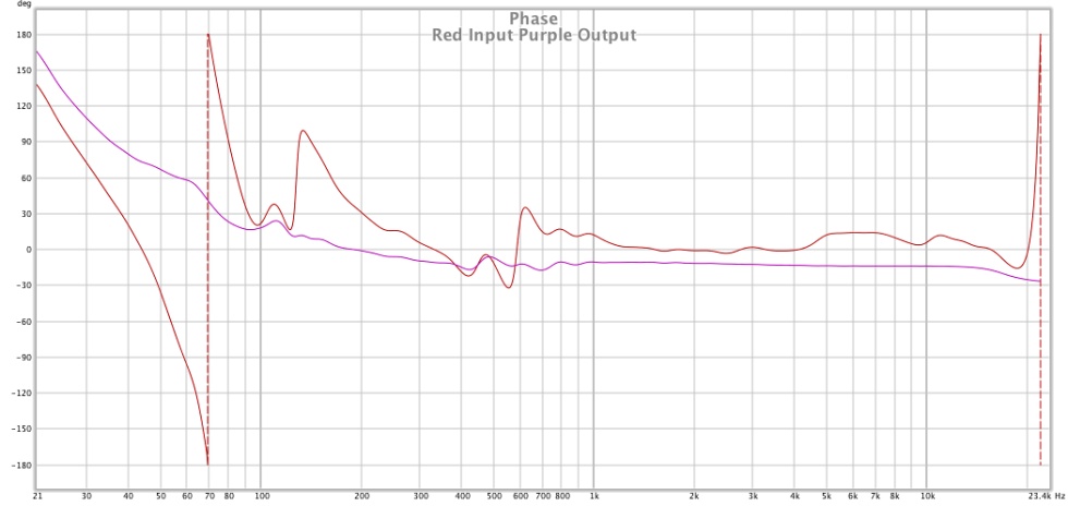

This is the change in phase when viewed through a 6 cycle FDW. There are always arguments as to whether this is the "right" way to go but I find it hard to believe that other's could not hear what I am hearing in the same situation.
attachment.php
Jim what does the phase of your speaker look like at your listening position with and without the correction? Testing at 1m metre might not help you because the room will mess up the phase and then it becomes hard to hear the difference between two different messes :)
I'm afraid I haven't taken any measurements of my main speakers at the listening position. My approach to this setup thus far has been conservative driver correction (derived from quasi-anechoic testing) + baffle step comp for the satellites, and room correction + Linkwitz transform for the 2 sealed subs.
Last but not least, a "room" curve, arrived at over time via subjective listening. This ended up being a gentle tilt downward from 32 Hz to 16 Khz @ -0.5 dB/oct, for a total of -4.5 dB using 3 cascaded low-Q shelving filters. Everything is IIR using miniDSP.
I've been so pleased with the sound I'm getting, and so busy with other things (stupid day job!) that I haven't gone any further down the rabbit hole - yet. But I do understand the "2 messes passing in the night" scenario you describe - I'll keep that in mind going forward.
Jim
Measurements at the listening position will be a good place to start to understand the impact of any changes you make. Even if a measurement might not tell the whole story its still a good indicator.
I have found that spatially averaged impulse measurements like those that were mentioned by Swiss Bear to be a good base for room correction.
Your approach sounds sensible. I have about twice the slope of yours on the arrays at near 1dB/octave but that is quite speaker (directivity) dependent as on LX521 I like less tilt.
