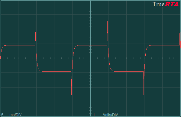

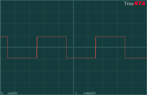

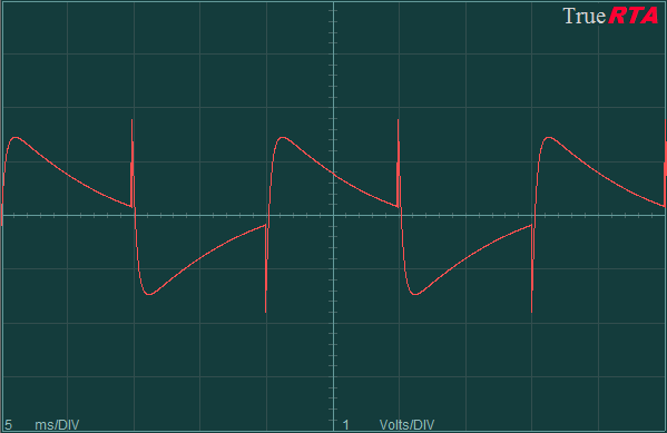

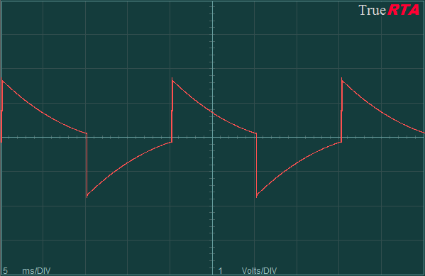

Right if its science for our hearing but that front also moves from time to time, regarding real world wave shapes i can do my own science and see output verse input is hopeless distorted no matter what we hear 🙂.
Wave shape output 50Hz SQ wave from a DC - light-speed domain:
Wave shape output 50Hz SQ wave from summed DC - 500Hz pass-band with a 2nd order LR XO point then 500Hz - light-speed pass.band:
Wave shape output 50Hz SQ wave from a 20-20kHz domain:
Wave shape output 50Hz SQ wave from summed 20 - 500Hz pass-band with a 2nd order LR XO point then 500Hz - 20kHz pass-band:
