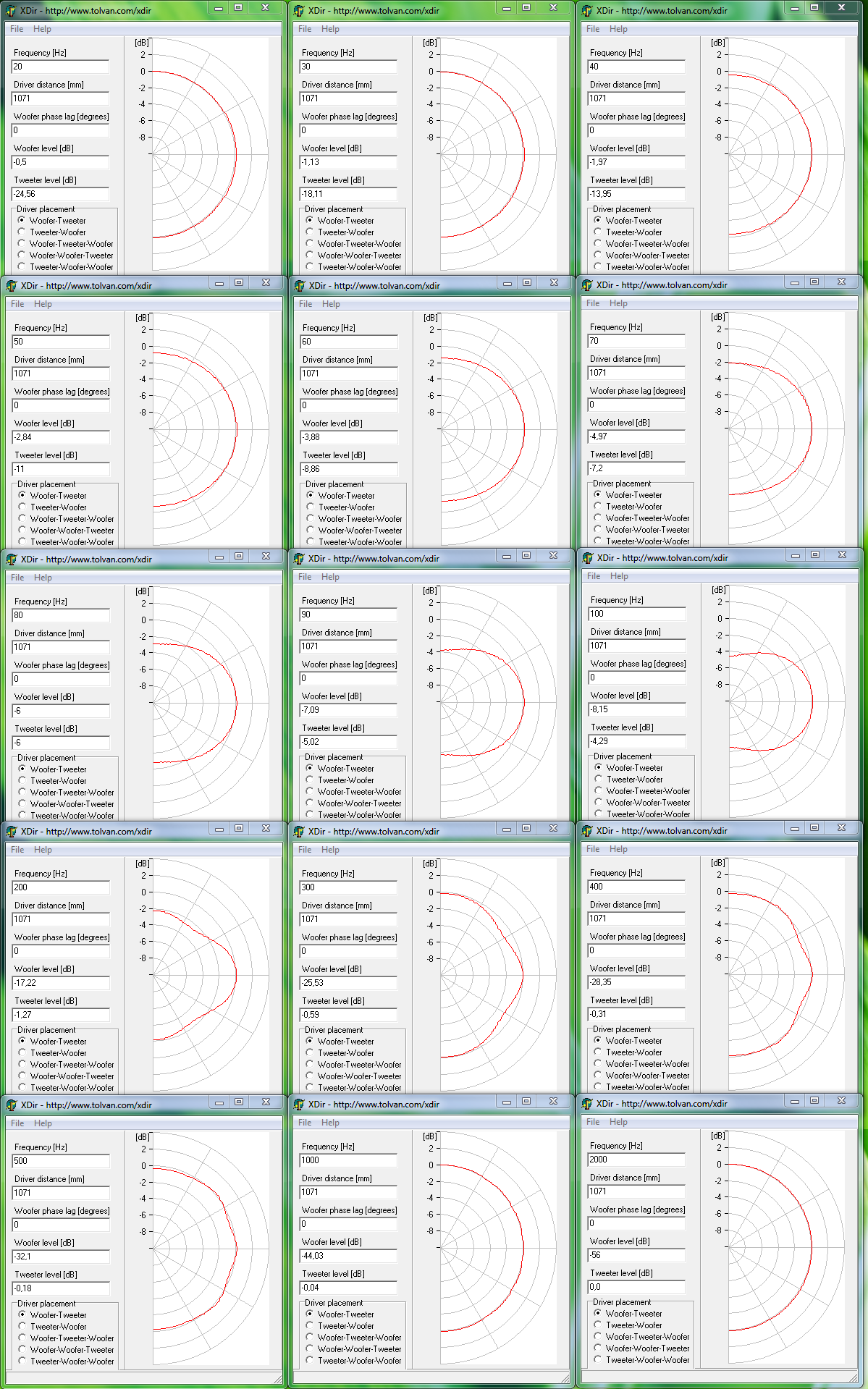

Sorry below vertical power responses is own simulations and not prepared to be easy to read for others but if you look at it info is XO point is at 80Hz (the one at left column in middle) then first four is within 1/4 wave length at XO point and fifth one is within 1/8 wave length and slopes are 1=LR2 2=LR4 3=LR8 4/5=LR16, think spacing distances are relative short so most real builds will be worse. If you direct compare the first four notice the one you recommend have worst and widest error, the steeper ones get less and less error except right at XO frq because they get faster over XO region, and fifth one being very steep and very short spaced is almost perfect as a one point source. Almost forgot tell configuration is WT in simulations and change it to WTW results will look different.
The problems with LR filters is of course where distance between drivers is comparable to wavelength of crossover frequency. As the low freq driver starts to beam of axis the LR requirements are not met any more. That is > 1000 hz or sub - satelite
At > 1000 hz the group delay requirements of the ear is quite tight.
Another point that Linkwitz makes himself of moreway filters >3 is that they can not be parallell as the phase of the filters will interact and LR is no longer possible.
So it must be a cascade of 2 way filters. Not all popular "DSP boxes" support this.

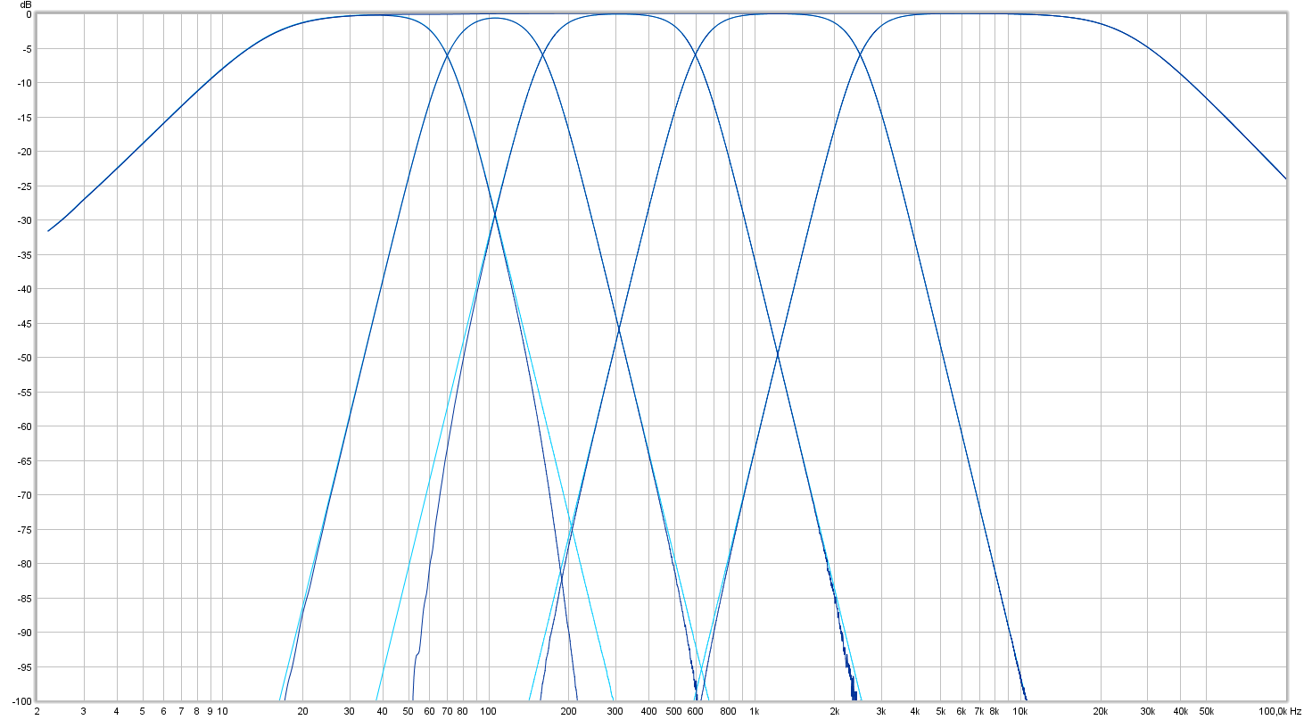

Speaking of fun. My fun system is:
< 70 hz: 4 x 12" + 2 x 15" peerless/scan speak + slaves
< 160 hz: 15" audax
< 600 hz: 10" seas
< 2500hz: 6" seas
> 2500hz: vifa ringradiator
All 48dB/oct and heavy EQ
Jimi is playing for me as it was meant to be. And yes it is fun!

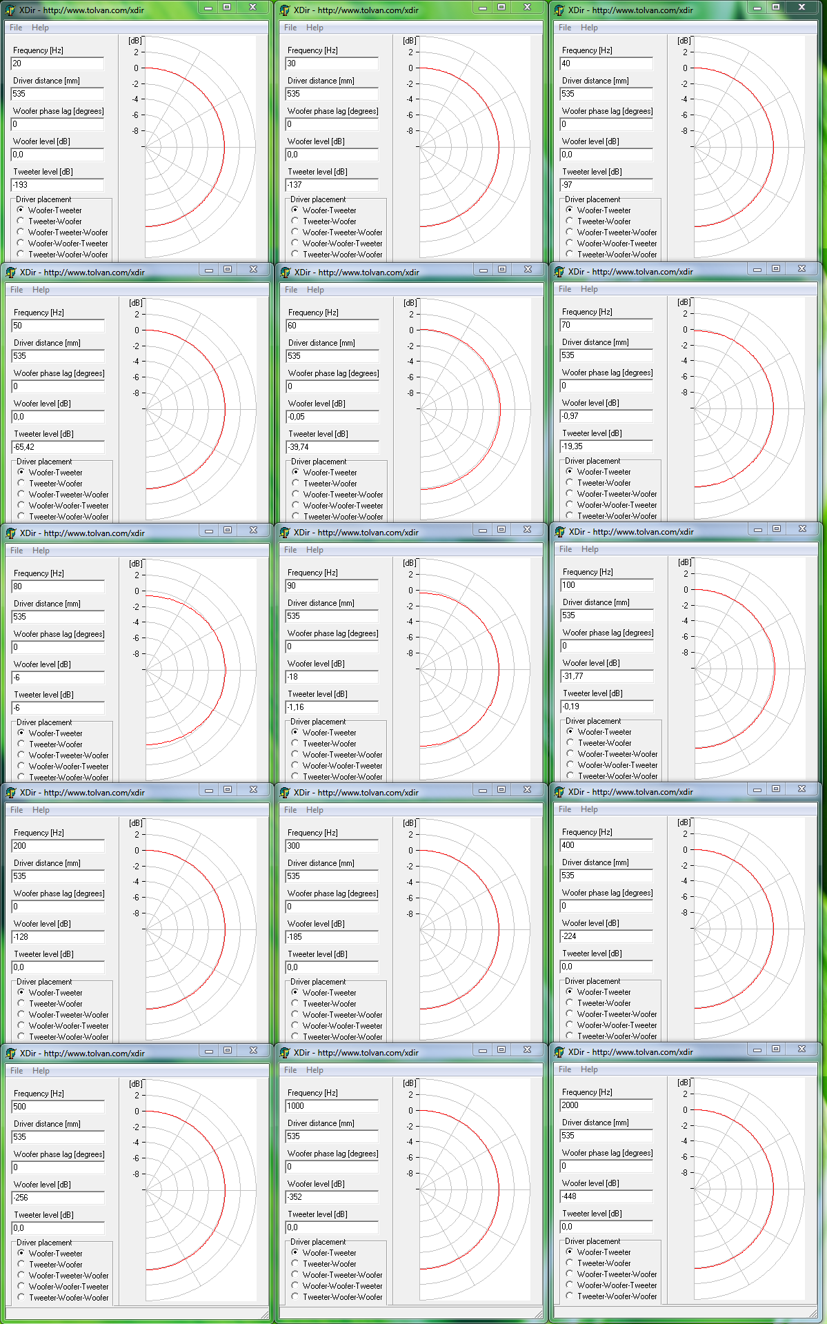

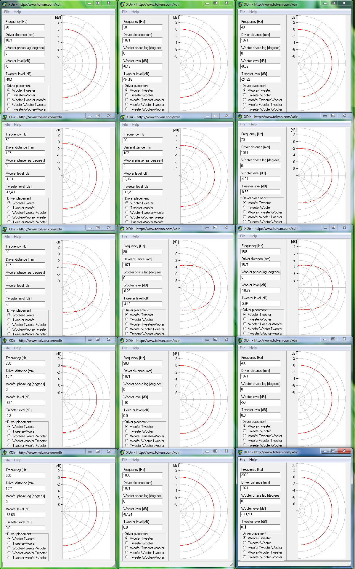

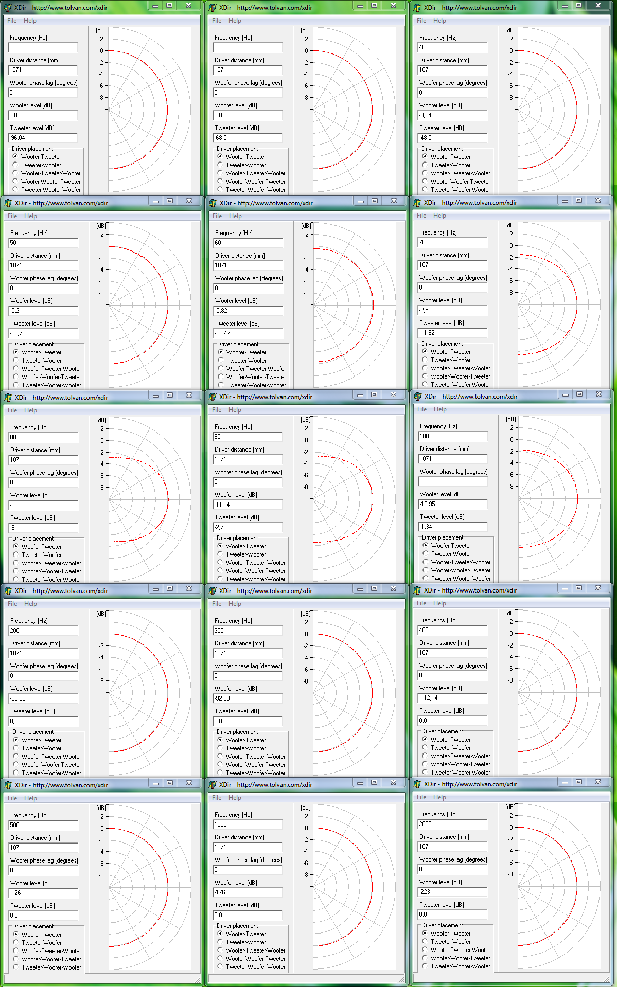

Hi torgeirs, think would take myself forever to calibrate a 5-way system : )

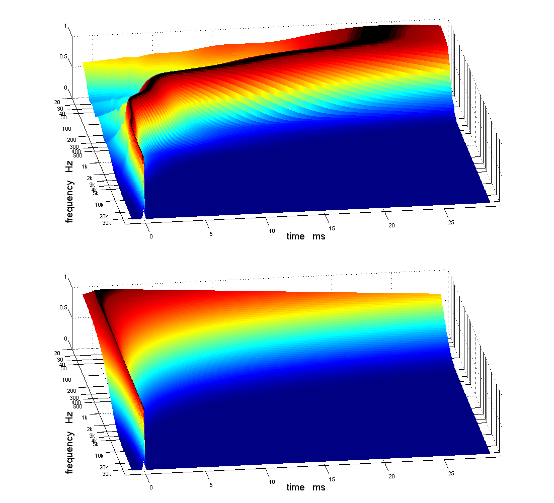

In you have 3060º phase turn distortion inside system stop band sure you will have big group delay, simulated comparison to head phones or chamber music instrument playing live in front of you show quite some difference.
Don't understand about not have constant phase difference inside the filtering bandwidth, difference is the confusing word used because aren't LR supposed to be in phase although a turning one.
Have you DSP power to time align and using most correct cascaded slopes as target curves shown as dark blue ones below based on 15Hz-25kHz system verse light blue single textbook ones.

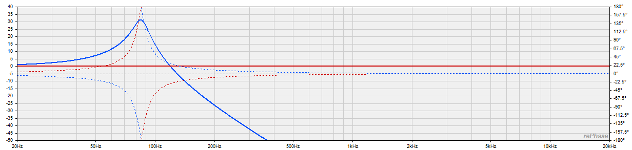

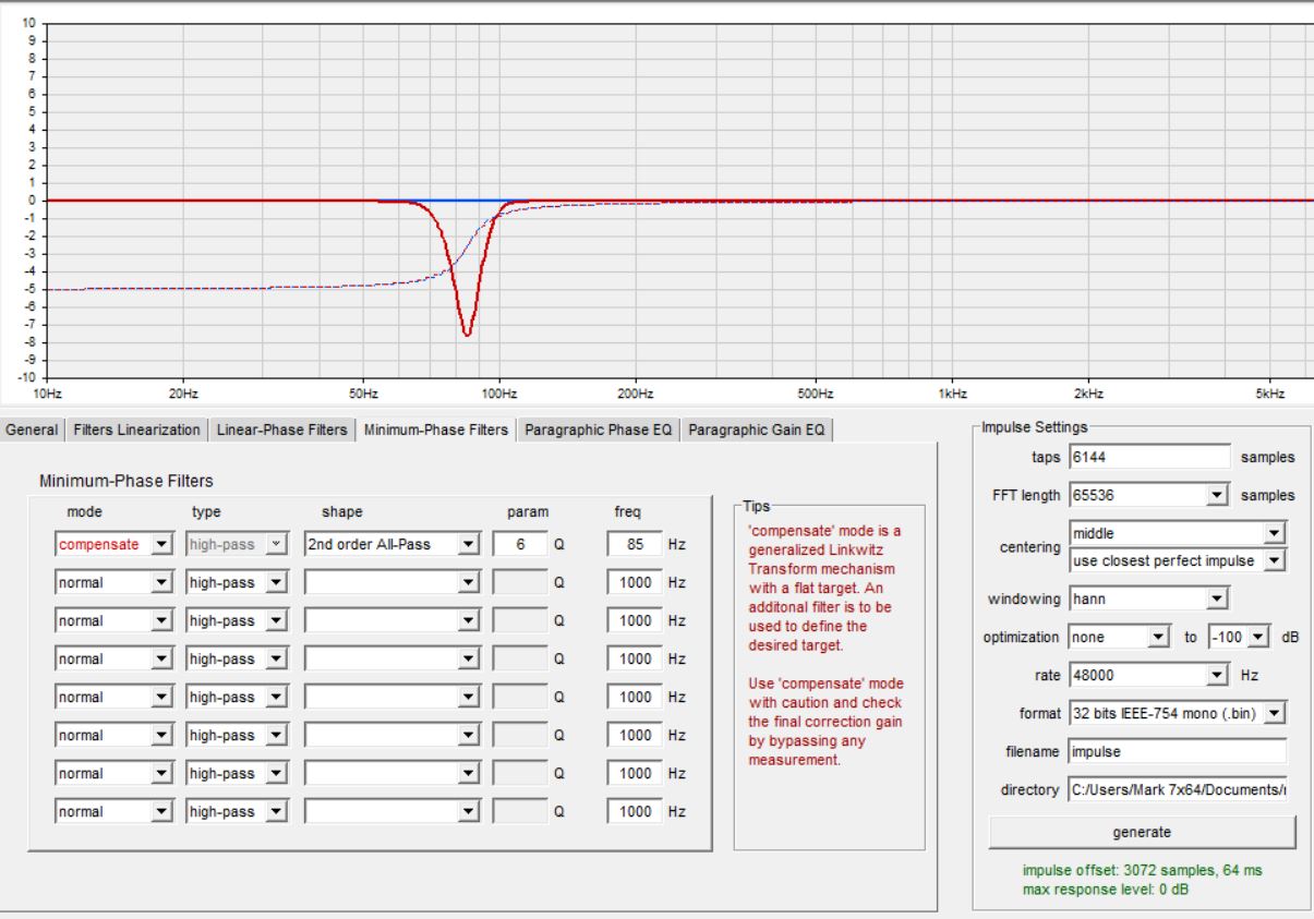

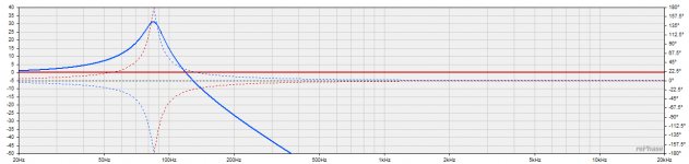

Hi Pos, hi all,
Beginning to play with idea of using all pass filters to help flatten phase on a driver-by-driver basis.
I'm particularly interested in 2nd order inverted all-pass, hopefully accomplished by using rePhase's 'compensate'.

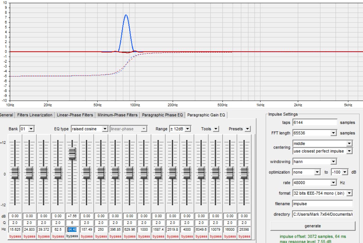

One thing I don't understand yet (among many!) is why I get a magnitude notch like the one below.... my meager understanding of all-pass is that it doesn't effect magnitude ????
(Second screen shows parametric eq to overcome the notch.)
Any help understanding this appreciated 🙂
Thx, Mark
Hi Mark,

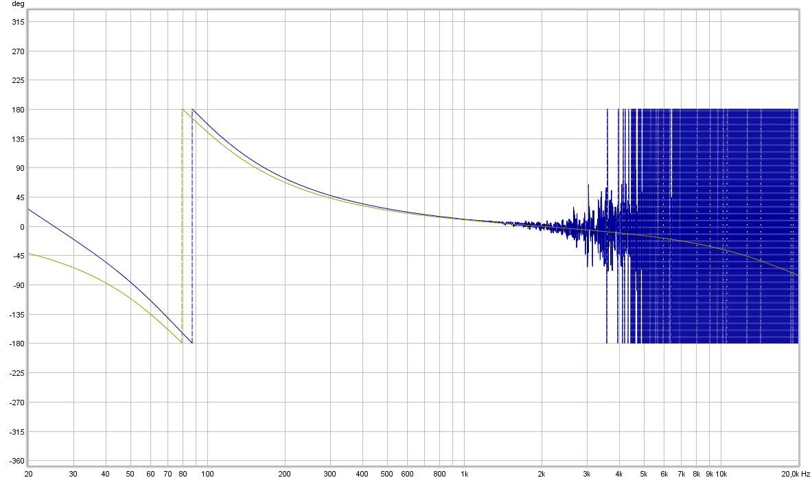

As BYRTT suggests 6144 taps is not enough for such an abrupt phase shift at low frequency (ie high group delay).
Your screenshot does not show the degree scale, but this is a rapid 360° phase shift.
(by the way you can use the "save graph screenshot" or "save window screenshot" functionalities in the file menu, and the latter will also anonymise the directory entry for you)
You would get a flatter magnitude response by setting centering to "100%" (peak on the right side of the FIR) and selecting a rectangular windowing.
But are you sure you need this correction?
This kind of phase shift is what you get when chaining two 2nd order filters with Q=6, and this implies more than 30dB of boost at the cutoff frequency:
attachment.php
If this happens for real (and is not an artifact of some comb filtering with reflexions in the measurement) then you have more to worry about the magnitude response, and this is better addressed using minimum-phase EQ.
Regarding the principle of using all-pass in reverse mode, this is in essence what the "filter linearization" tab does, but limited to known types (and realistic Q values 😉)
An "LR 24dB/oct" filter linearization is equivalent to a 2nd order all-pass with Q=0.707 in compensate mode.
Hope this helps 🙂
