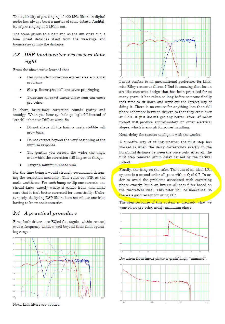

First pos say:
...An "LR 24dB/oct" filter linearization is equivalent to a 2nd order all-pass with Q=0.707 in compensate mode...
Second theirry38 say:
Hi Thomas,
You would say 2 2nd order all-pass ?...
So far only understand thierry38's point about the Q's when multiplied sum Q0,5 but is confused why suggest two of them all-pass when 2nd order all-pass have 360º phase shift and pos say one in compensate mode Q0.707 will repair 4th order LR, which below page 6 from Grimm AUDIO LS1 paper also suggest.
