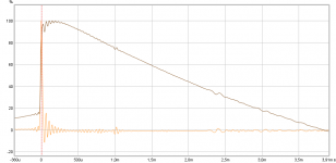

...Back to fig.3 Is it total impulse and stepfunction and not LP/HP impulses?
Yes its IR and SR for systems summing pass-band.

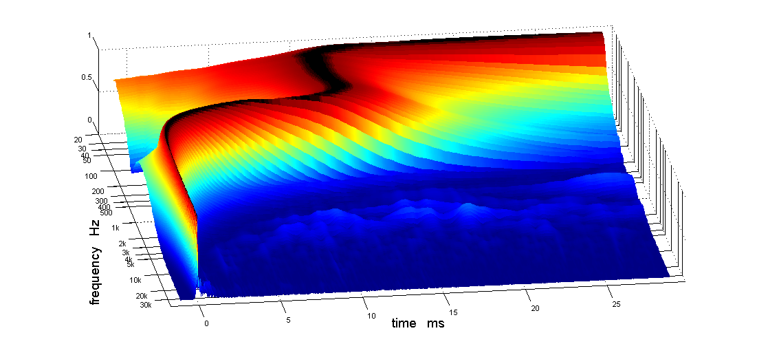

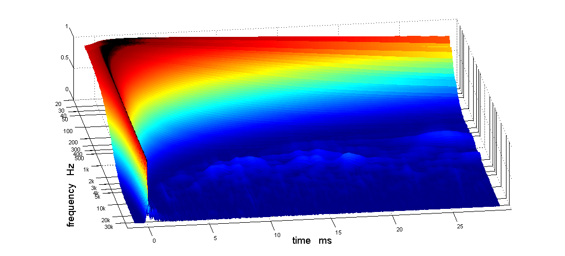

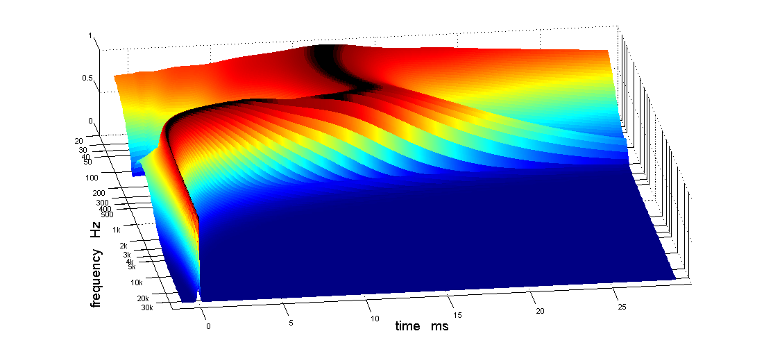

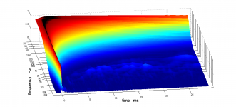

Ha ha talking nasty group delay i show you my SNAKE 96dB/oct before linearization, first one is Rephase created IR used as textbook target response, second one is real acoustics and third one is real acoustics after linearization but at the time when config was 48dB/oct.

Regarding the snake: Guess the group delay is only from the filter?
The woofer has also its own group delay because of HP nature. More group delay if ported.
I use the speakers with Xbox also so can't afford the delay of an "anti snake filter"🙂
