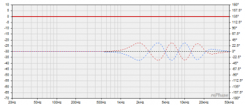

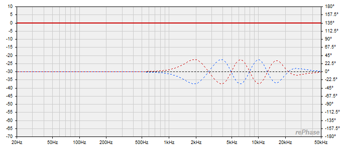

I tried with the Phase EQ but not so easy to get a nice sloping group delay.
I could be wrong if its use full for requested situation but as inspiration look the phase shufler Pano did over http://www.diyaudio.com/forums/multi-way/277519-fixing-stereo-phantom-center.html. Phase turn is not very much but just enough to hinder some combing cancelation, pos kindly build this shufler into Rephase as preset under "Paragraphic Phase EQ".
Using "Paragraphic Phase EQ" I guess a certain combination of Qs and phase change gives an resulting flat phase inside a freq. range, but I struggle to find the theory.

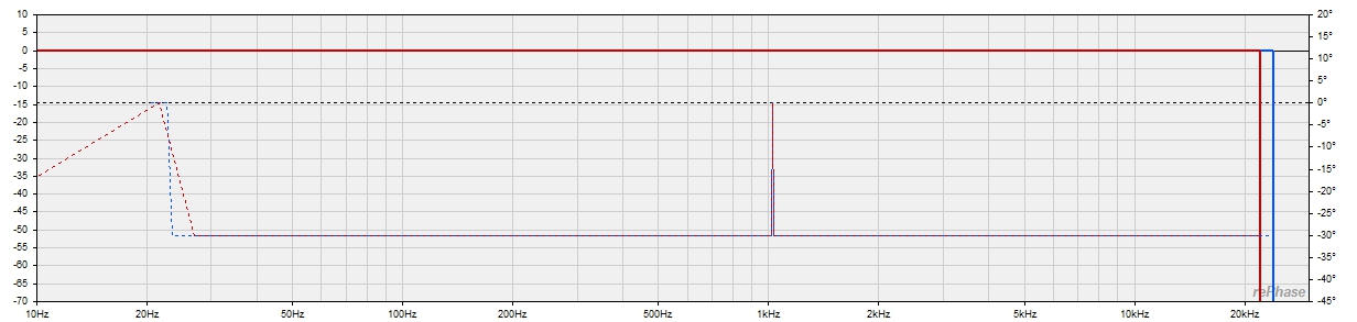

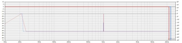

Tried to import an textfile of -36 degrees and 0 dB into rePhase.
The FIR was generated, but the constant phase shift disappears in REW so I don't know if it works? (as i can't check the groupdelay.)
The import measurement in rePhase is just a visual support.
You might do effective -36° phase shift ( +/- 1°) this way:
Ok, thank you wery much! Was fooled by the curve generated. Looked like a response had been generated. (Put in a ramp at 20 Hz and a spike in 1k).
