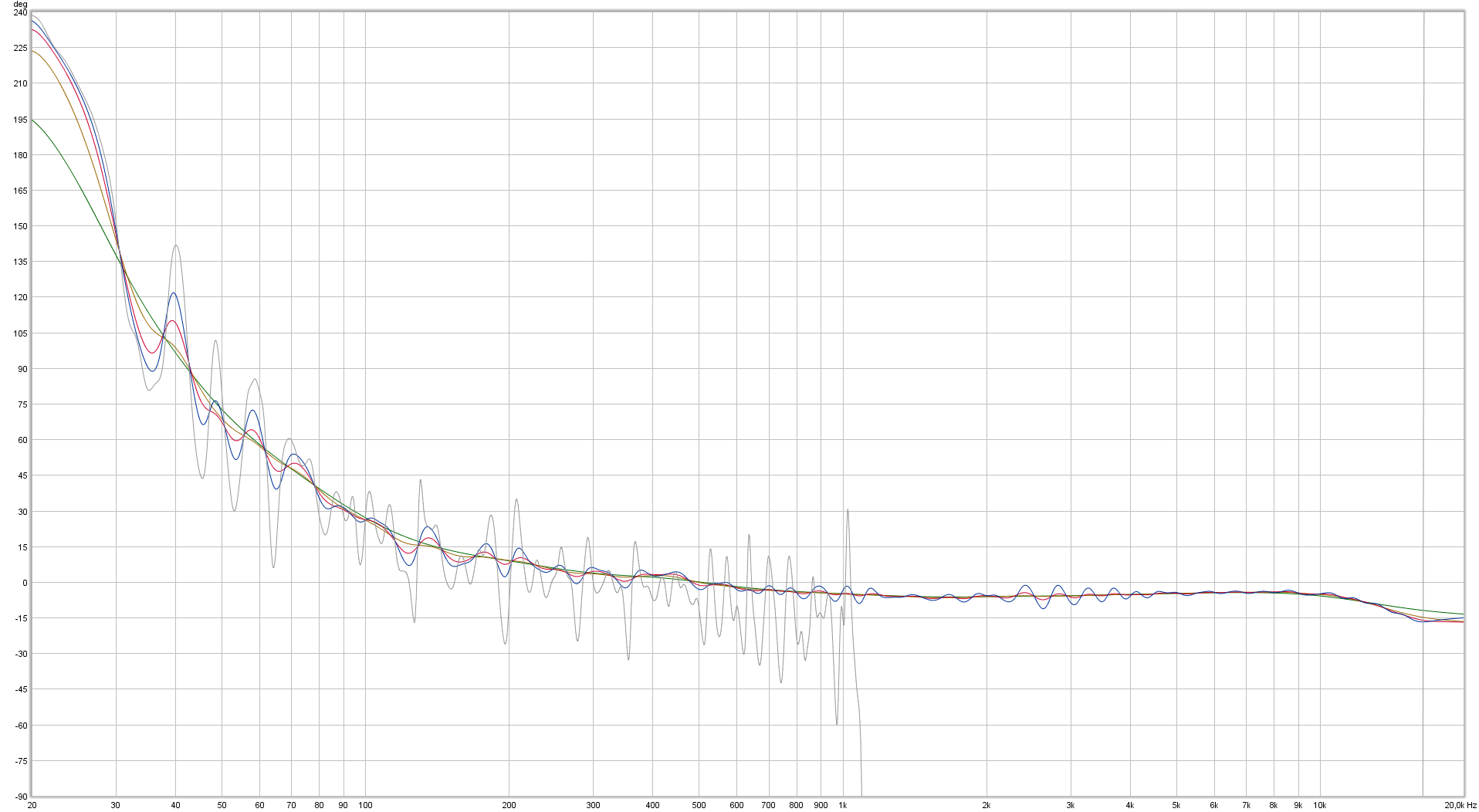

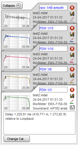

About REW before command export measurement as text to use in Rephase have IR aligned either manual or use "Estimate IR Delay" to have phase curve right and set some kind or gating. As a start proposal for all right universal gating (near-far field) to filter out most environment could be frq dependant window 1/6 as seen below and is probably also good setting before use of REW EQ menu.

If you fresh at it we could try a little study to investigate your environment influence and compare it to mine "Overlays" below which was microphone at about 0,9 meter having side wall 1,5 meter away. In REW open one of your previous sessions and highlight one measurement and then "File" "Save measurement", close REW and open it again to have a clean new session, open the saved measurement 5x times and with button "IR Windows" command first to be raw then FDW 1/15-1/10-1/6-1/3 as seen below and maybe save session "File" "Save all measurement". Think exercise will show that if yours in "Overlays" window vary more than below from filtered to non filtered then that sidewall reflect heavy and maybe it will make clues to where in frq its worst and what is best settings to FDW.

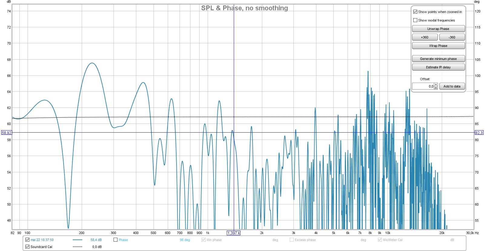

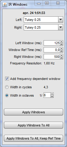

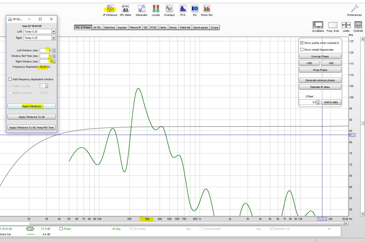

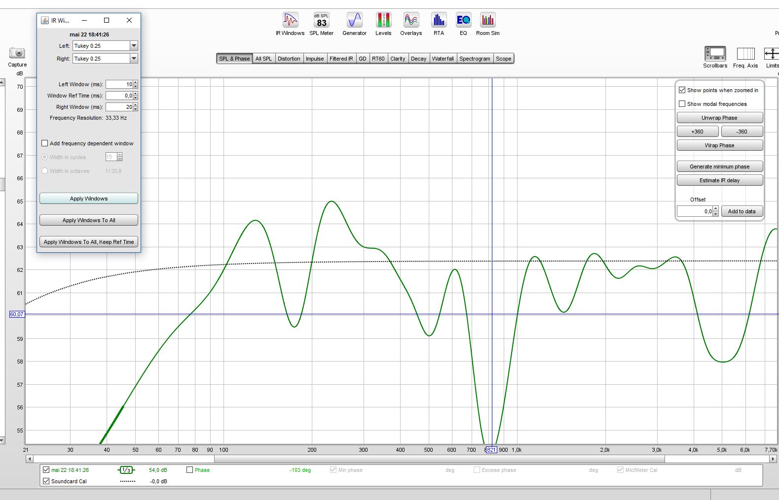

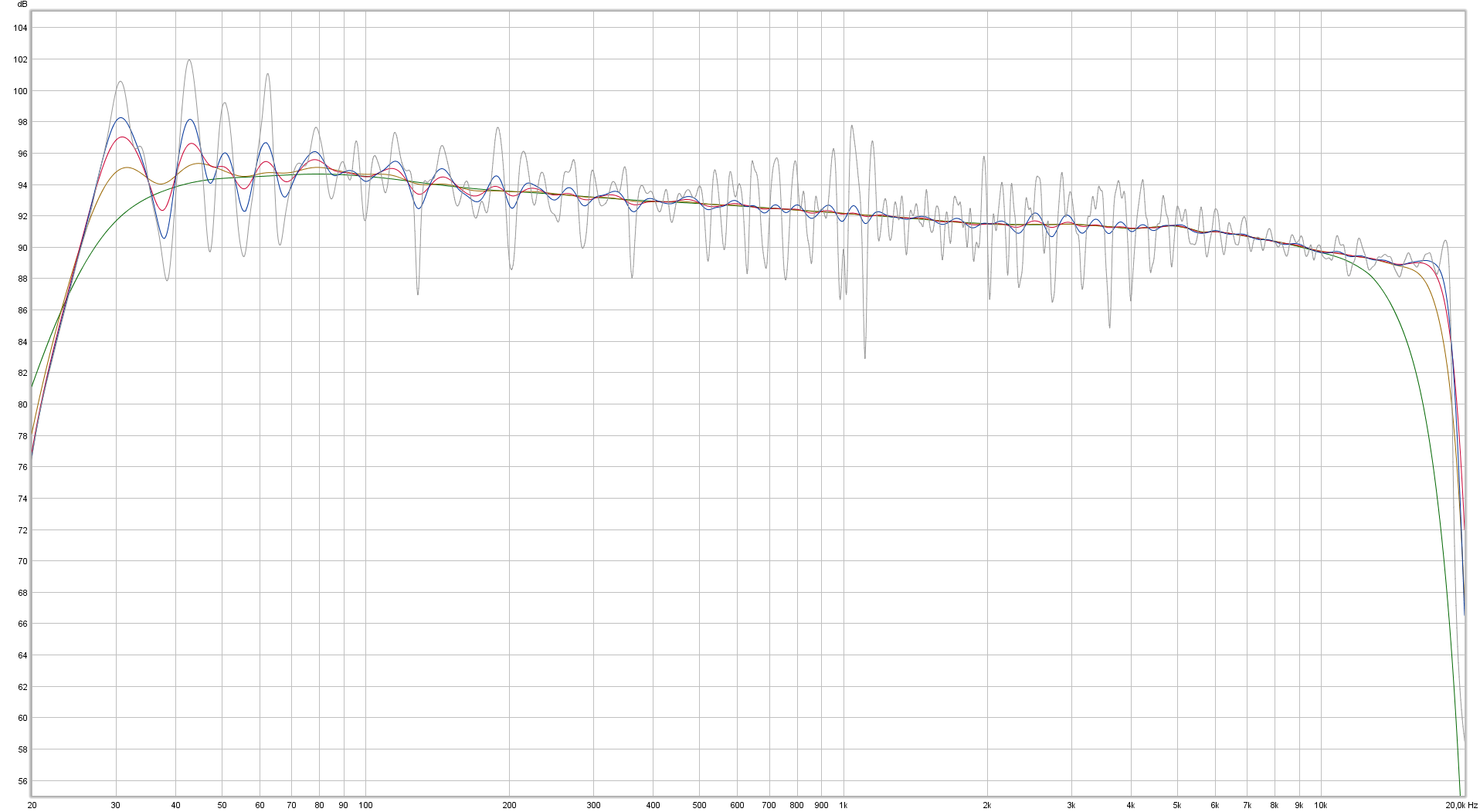

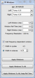

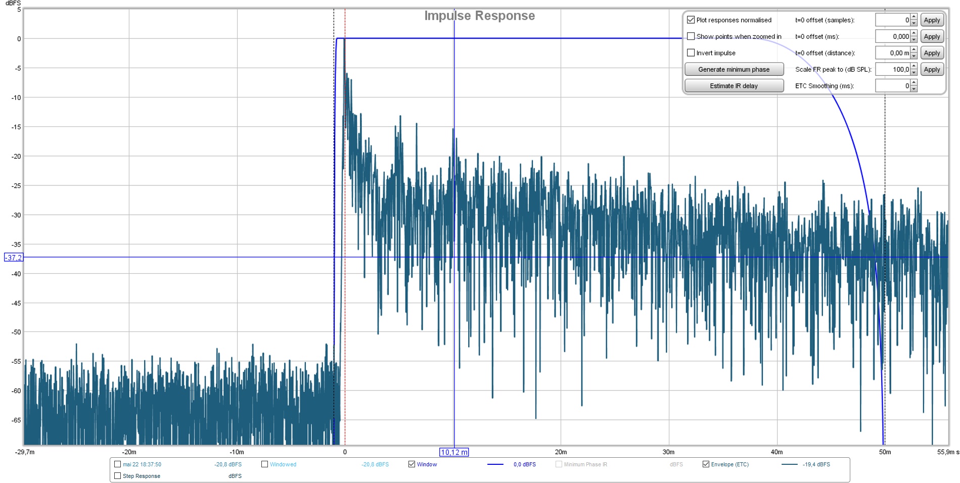

A method for checking reflections from nearby wall, celling or floor is to use the energy time curve, ETC
Add a window to the measurement to try to window out the direct sound. Picture 1.
It can only be used for frequencies higher then 1/T where T is the with of the window.
Then you might see the frequency content of the reflection. (picture 2)
Do a real world check with a measurement and try to see if the first reflection can be right. The reflection travels 34cm/ms. So 5 ms is about 170 cm. Use a flexible measureband to check.
The shifted window (remember to press "Apply windows") SPL measurement gives you an idea of the frequencies reflected the most. (inside the window)
I would be careful to correct those frequencies to much.
And you might have a suckout at half the main frequency

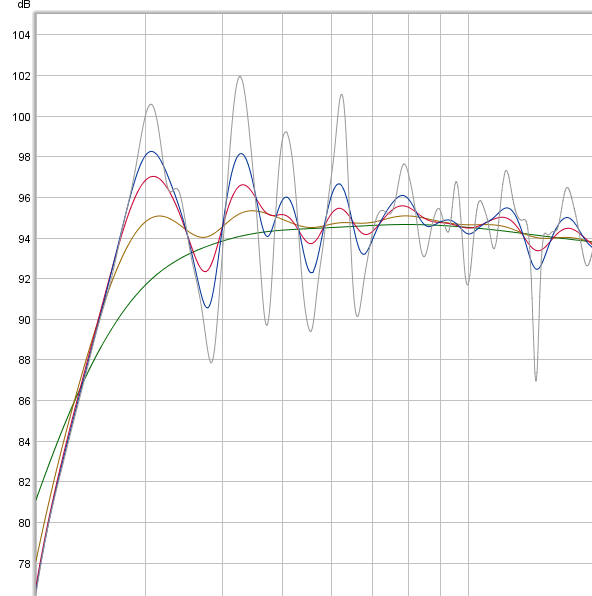

Picture 3 is 20 ms window starting at 0.
A suckout around 150 hz, maybe because of first reflection, can be seen.
Picture 3 is 20 ms window starting at 0. The suckout because of first reflection can be seen.

At second thougth the dip at about 180Hz is both in picture 2 and 3 so I think it is maybe a room node instead.
A measurement tape and ETC will give you good indications of where your most problematic reflections are caused.
But be cautious of roomnodes and misalignment/reverse polarity of speaker elements🙂

Great have fun down the road and its not necessary share your own results here but now you have mine to compare with 🙂 zooming into those at low frq show filtering helps for over correction in a home environment, maybe 1/3-1/6 is the best at low frq and 1/10-1/15 would work precise at higher frg but using 1/6 for hole audio band pass is probably a good start.

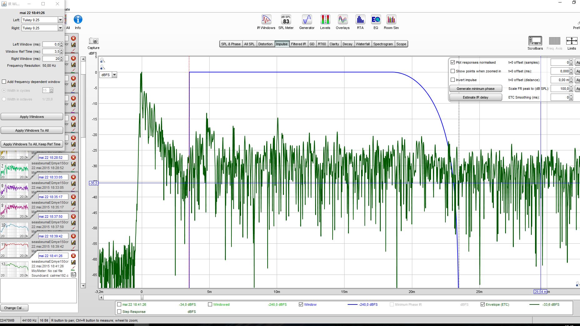

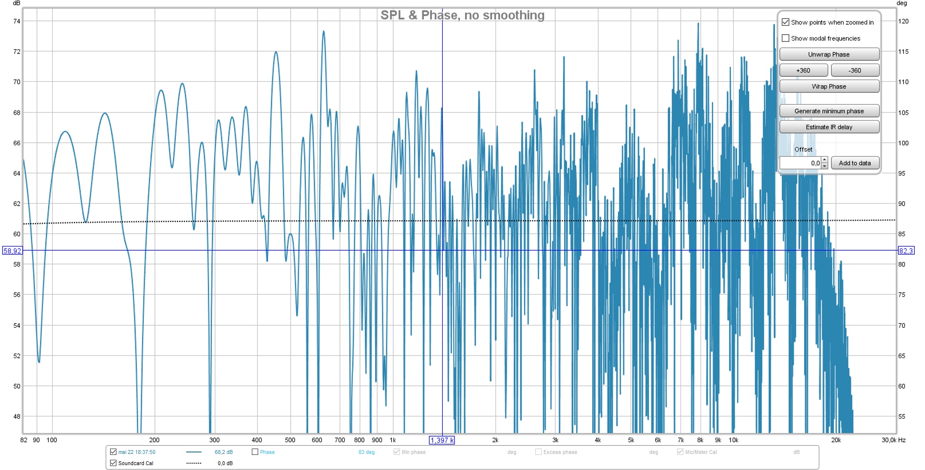

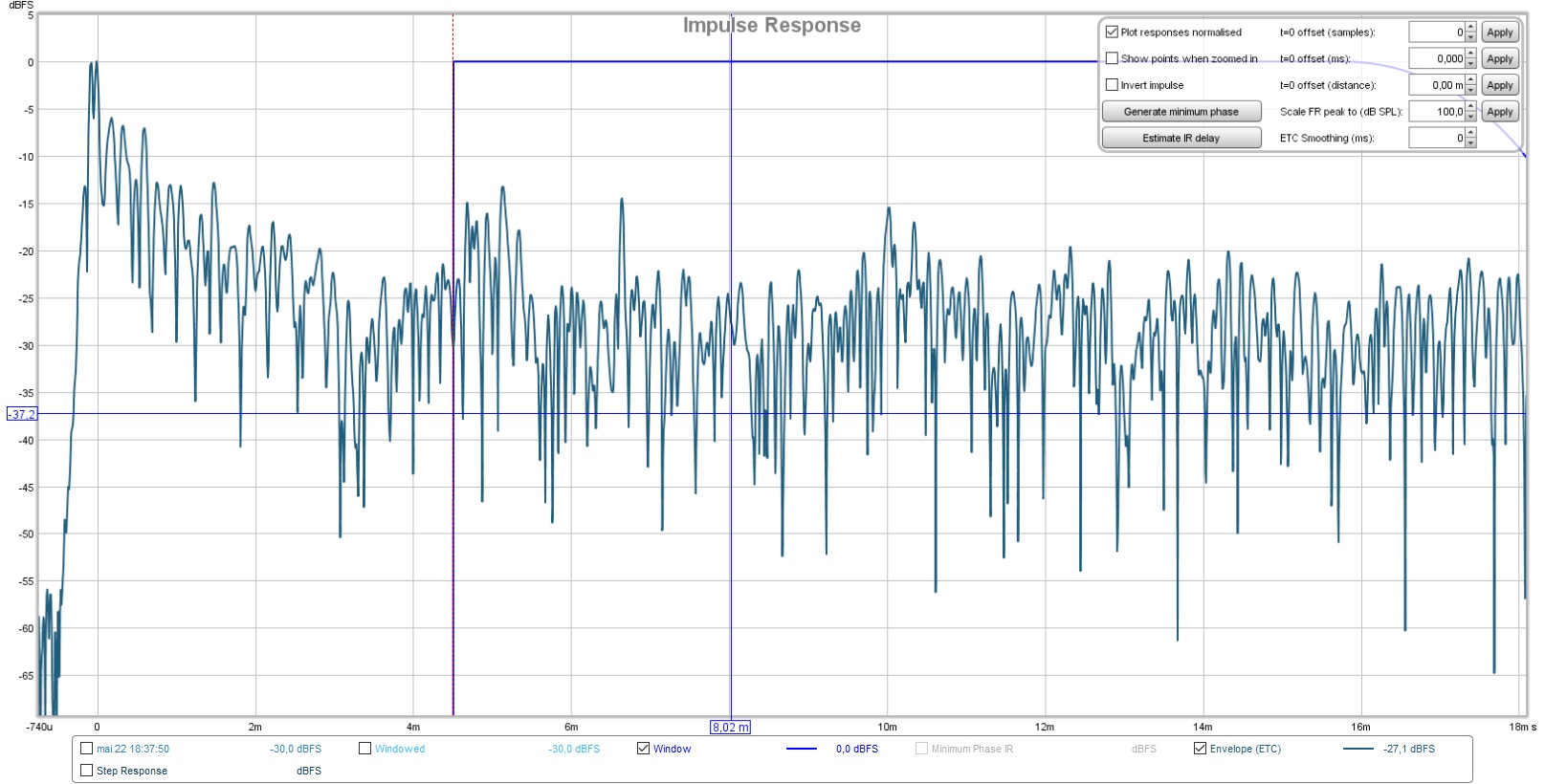

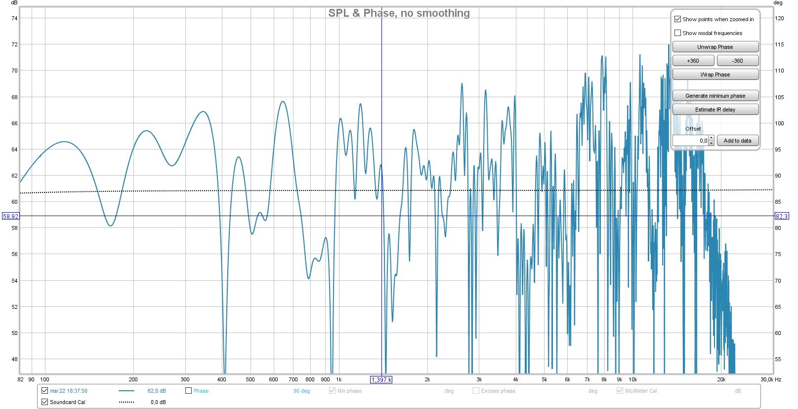

Argh. Had 1/3 oct smoothing on previous measurements.
Here are measurements without smothing.
50ms window
15ms window
15ms window shifted to first reflection.
15 ms is regarded early reflections in normal rooms. About 5 meters sound travel.

Yes, they require some experience to understand. But investigating what is going on in your own listening room is very good learning.
But the results are not crystal clear. So moving the mic around inside a square meter might help understand whats going on. (And you can also moddle the responses🙂)
If you have a small speaker with reasonably straight response you could try to measure the opposite way. The small speaker at the listening position and the mic at the speaker position.
The first reflections should turn up in both directions. (All other reflections and room nodes cause "noise" so the first reflections may be hidden in the noise. And that is good news if it is the case)
Actually if no reflections or room nodes, e.g free space, the mic and the speaker could change place without you noticing on the measurements.
Then you can correct with FIR filter.
Sadly it is not feasible in a active room because the reflections are added to the time responce and not convoluted..
