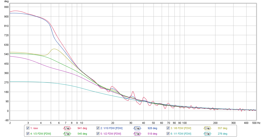

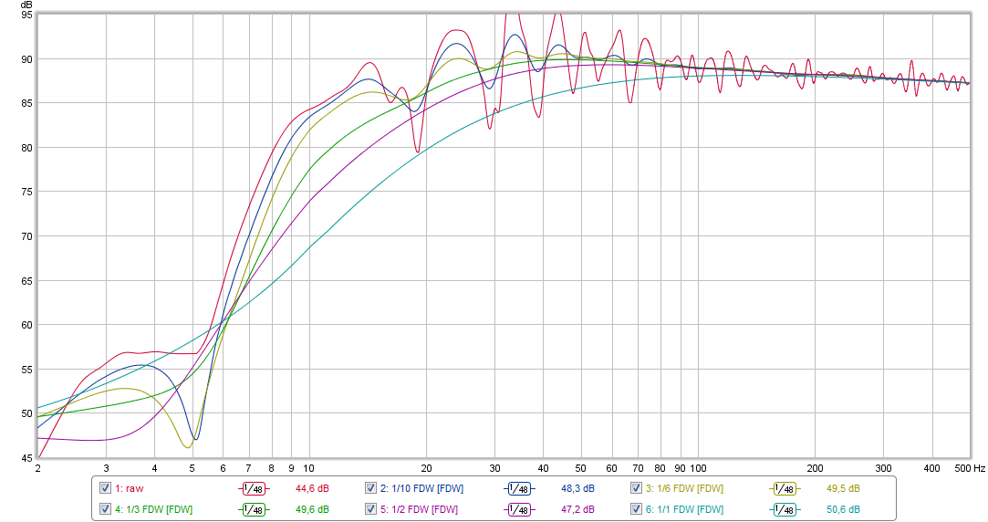

I did several measurements on my system in outdoor environment (echo free) no wind and dead quiet ��
Quad esl 63 ( modified..) has +/- 20 deg phase shift depending on mic position also. Pretty straight freq resp. But when i connect my active crossower 24db linkwits @ 150hz to my hommade dipole subwoofers it went messy with the phase. Between 17 hz hz and 150hz i got 5x360 =1800 deg phase shift just from the active crossover. I really hope to get the bass more tight then today. Qts of the dipole bass element is 0.65 so its a quite good start.
Then in my listening room i have a infra subwoofer playing between 15 and 28 hz. I will measure phase and delay later. Frequency response is ok... Its 4x15" 600w each woofers built in the wall, using my garage as box volume. 120 cubic meter or if it is my listening room 100cubic meter that is the box?? Anyway it moves a lot of air and its quite low distortion. Next step will be to use rephase even on ths infra sub as well. When i have learned it.

For inside environment measurements below 100Hz there is so much minimum and non minimum phase room response involved that it gives so much "Excess phase" when you in REW ask for "Min phase" curve of your frq response compared to measure absolute phase, so using some windowed settings to filter out room helps a lot. Below curves "Overlays" view is example same measurement inside a room system but one is raw, one is FDW (frq dependent window) width in octaves 1/10, one is FDW 1/6, one is FDW 1/3, one is FDW 1/2, and finally one is FDW 1/1, guess for your very low frq woofers use FDW 1/3 to base correction and from say 100Hz and up base your correction on FDW 1/6. I don't say this is the perfect settings for your room but try experiment and see the differences, its pretty easy when having one measurement to save it and then open it multiple times in same session and then set different window settings for each of them and toggle thru results, and to save that multiple session pick "Save all measurement".

Outdoors measure the sub without filter, then the software can more easily find "sync"

The excess phase can be confusing if you are used to normal electrical magnitude/phase plots.

If you ask me that will happen when you down the road have each pass-band set right and if ctc distance is fair good then linearize the excess phase from minimum phase (IIR) XO point. Generally XO points down at 150Hz and below is not easy in real world rooms so have patience and curiosity doing measurements to learn from, suggest for simplicity start with get ESL 63 to cooperate perfect with dipole bass element and forget about infra subwoofer until the other pass-bands cooperate perfect because it fast gets more complicated align 3 pass-bands than 2 pass-bands and especially at those low frq points in a real world room. As torgeirs showed Rephase is helpful for other than set the real filters in it can output target responses than when imported to REW you have the textbook curve to align up to in a overlay window when tweaking system response. To make textbook target curve for your dipole bass element look below visual example from Rephase, its relative important to set sample rate to same as measurement chain, and when file is imported or dragged into REW get IR (impulse response) zero aligned either manual or use button "Estimate IR Delay". Attach a couple of good documents from out there one about alignment for low frq and one for nearfield low frq measurement.

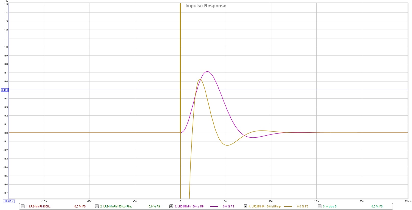

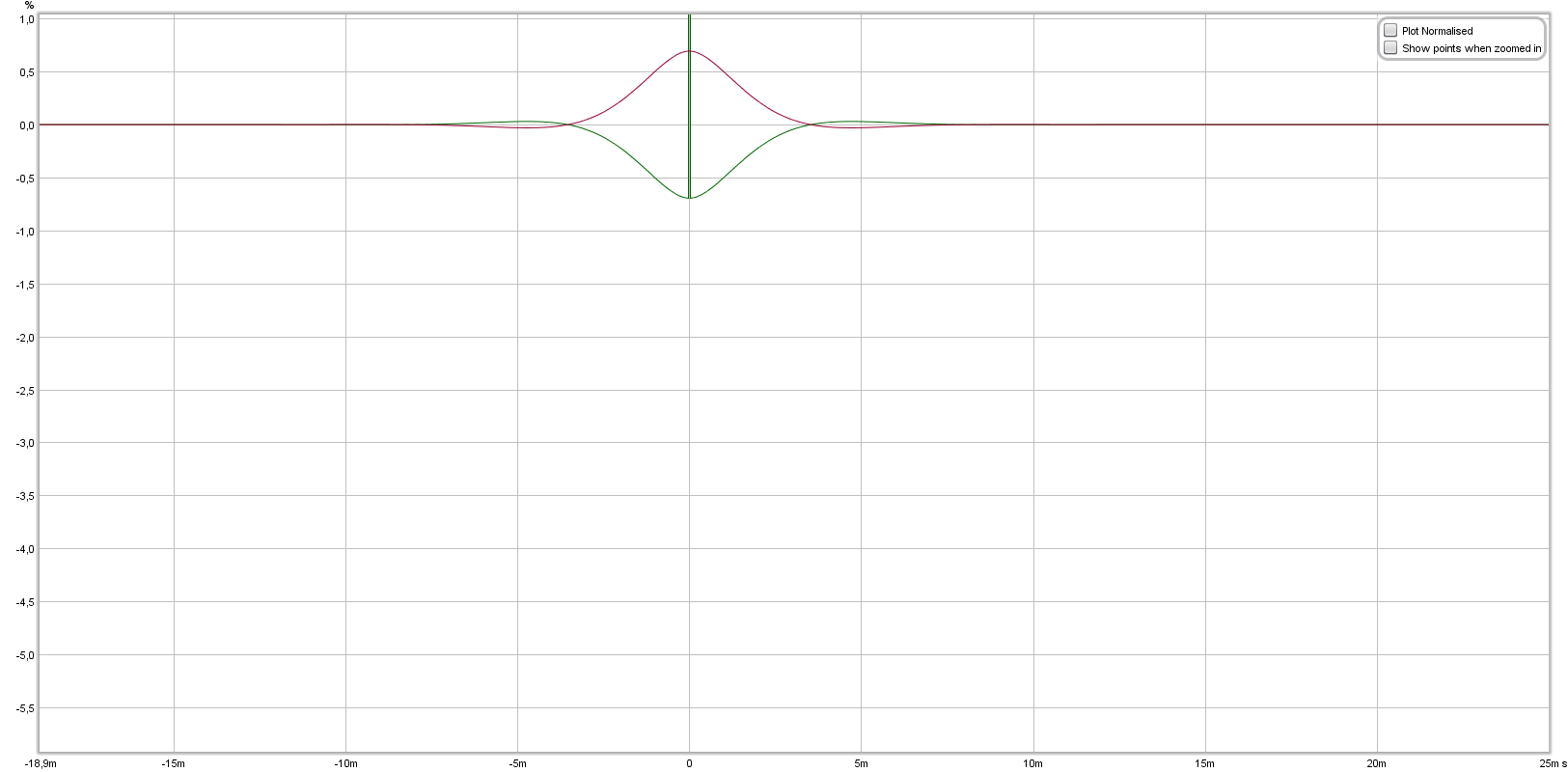

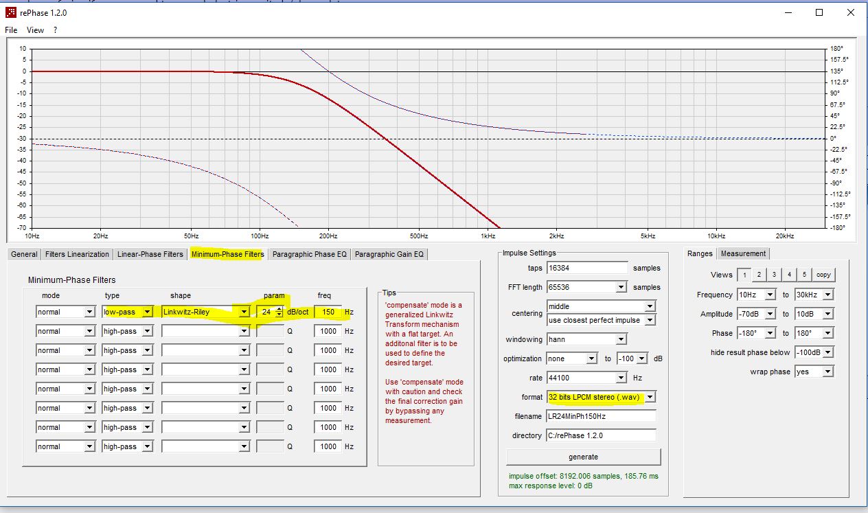

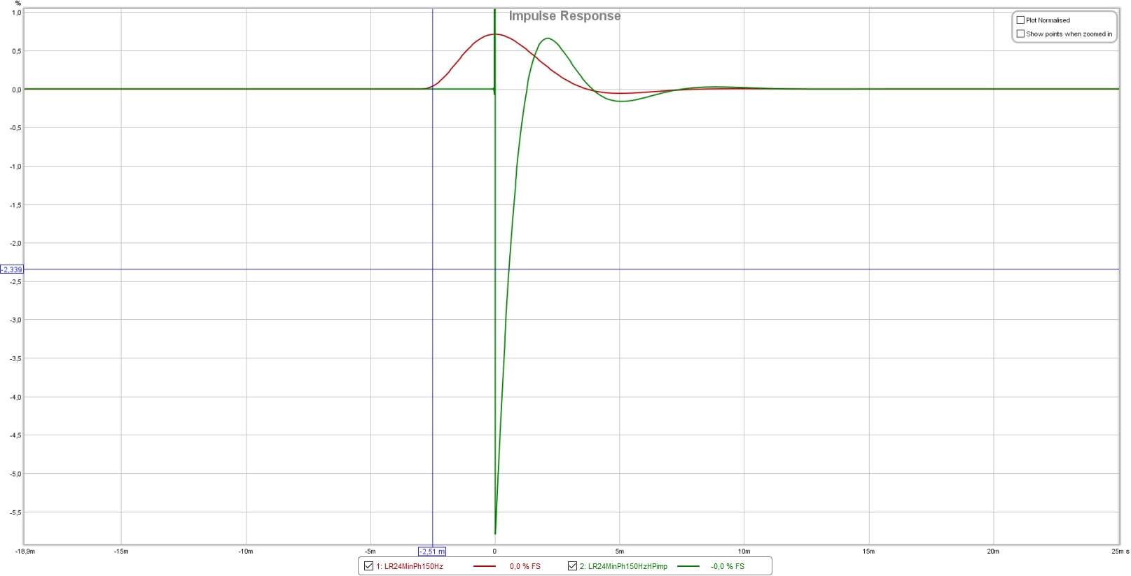

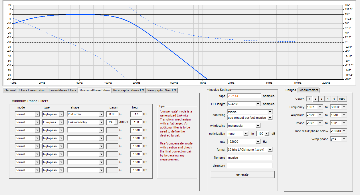

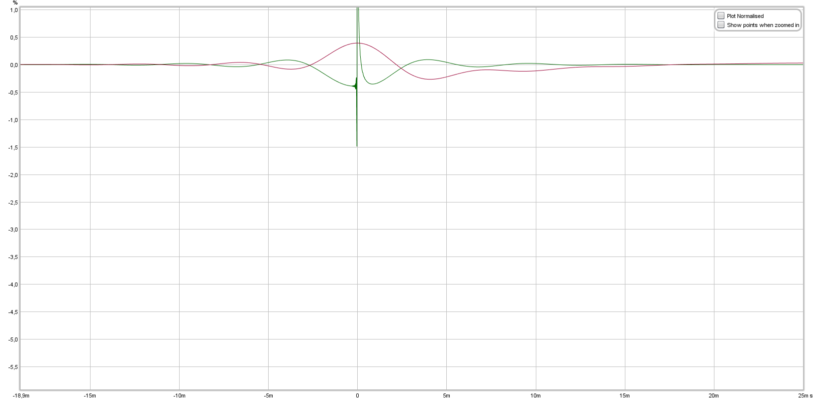

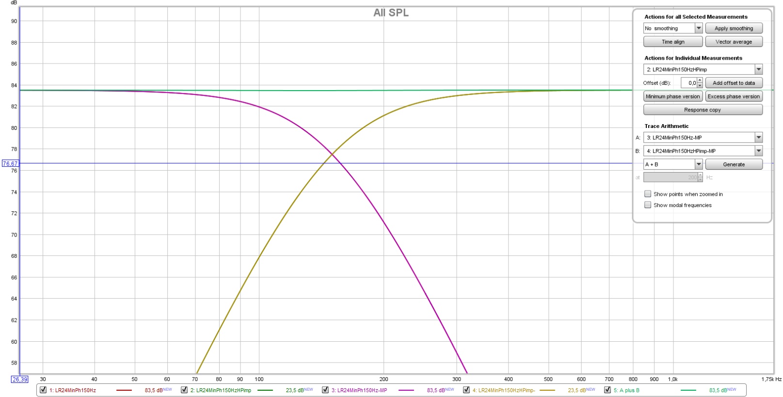

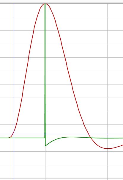

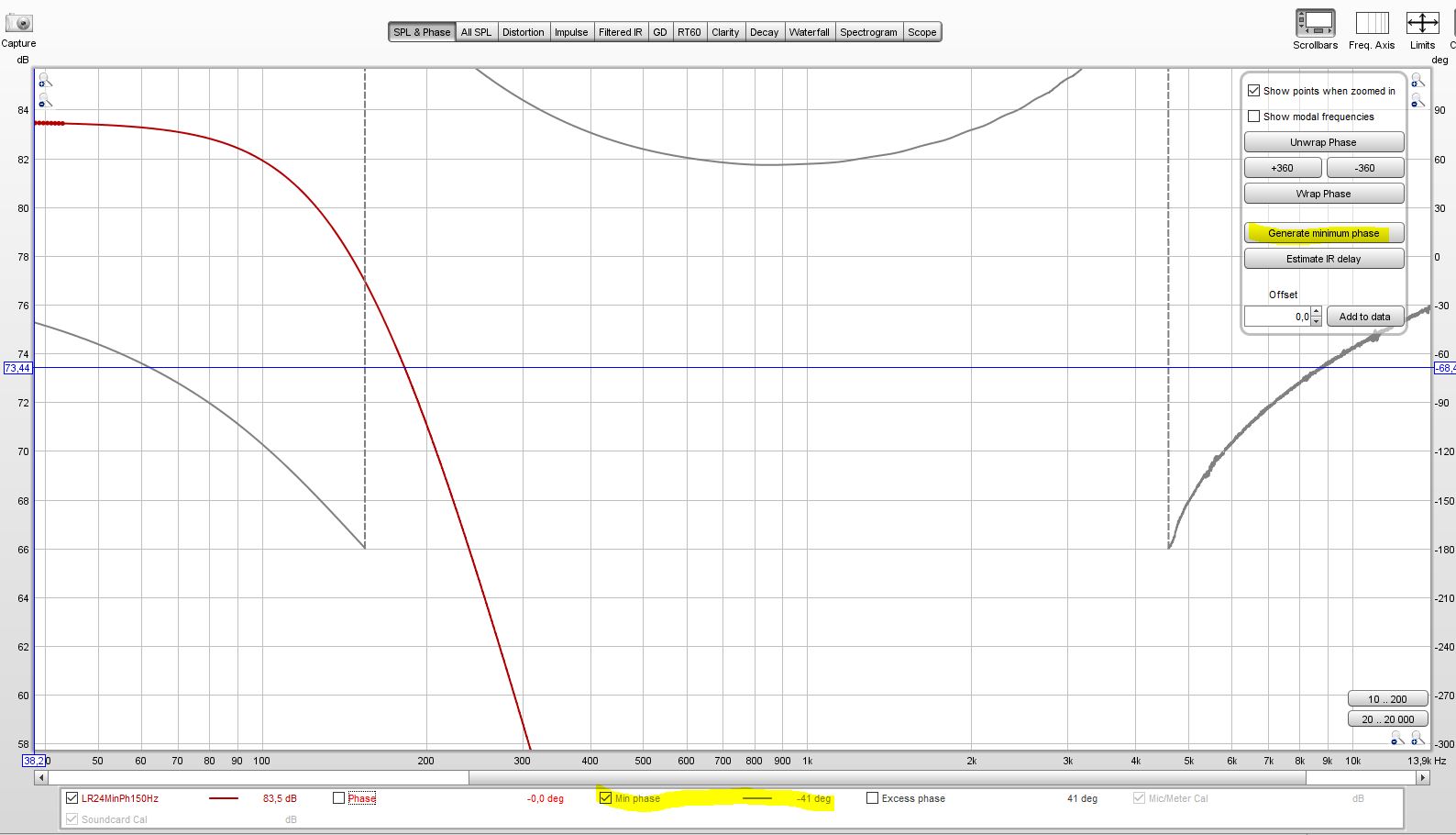

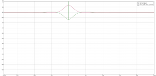

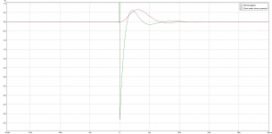

Have enclosed three pictures of Linkwitz reily 150 Hz, minimum phase, 24db/oct filter made with Rephase.
In REW the impulses can be imported can be seen in picure 1 to 3
- Both LP and HP scaled to 100%
- Scaling acording to energy in signal
- Zoomed to see 150Hz LP better
So the LP channel can not track the HP channel when rising from zero.
They are aligned at the top value of each impulse.
The LP filter has a lobe of about 6ms. That is 180Hz, so it is according to theory that shorter wavelengths are removed.

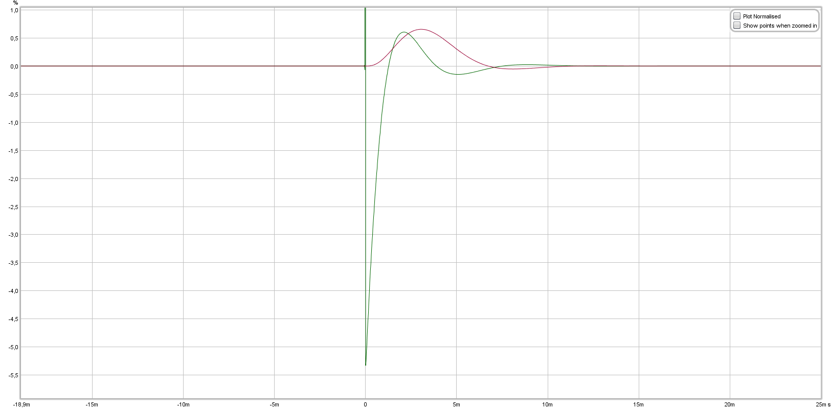

Argh forgot to make "minimum phase version" first.
And of course the a minimum phase filter is causal and LP and HP section time function starts at the same time.
Hi torgeirs,
Myself had not before looked at IR in that view mode before so to learn had to replicate your simulation.
From that can i friendly say 🙂 it looks you had to change assumptions how a summed system IR shall look like, reason is by mistake you take a minimum phase IR for woofer and move it forward to align IR top value with a minimum phase IR for mid-tweeter and that probably don't sum very good as a textbook linear phase XO point, in same scale as your visuals first one below is minimum phase version of 150Hz LR4 that align at attack of IR and second one is the linear phase version that align at IR top value, third one is textbook version how my exercise system including stop bands should look like.
