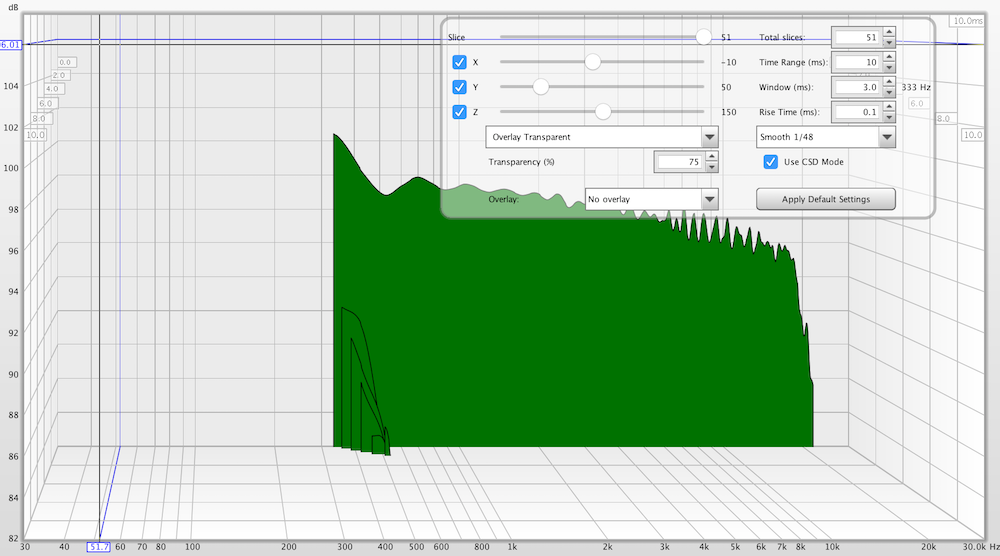

CLIO is different to REW and the window settings wesayso has used are causing what you see, I have not found a setting in REW that gives a similar type of response that CLIO etc. do when looking at the whole frequency range.
Here is the rest of the graph that you don't see in the screen shot from one of my measurements using the same window settings. See how the response ends at 333Hz which corresponds to the window setting, make sense now?
If you don't use REW and haven't looked at the manual section on waterfalls then I can understand your confusion.

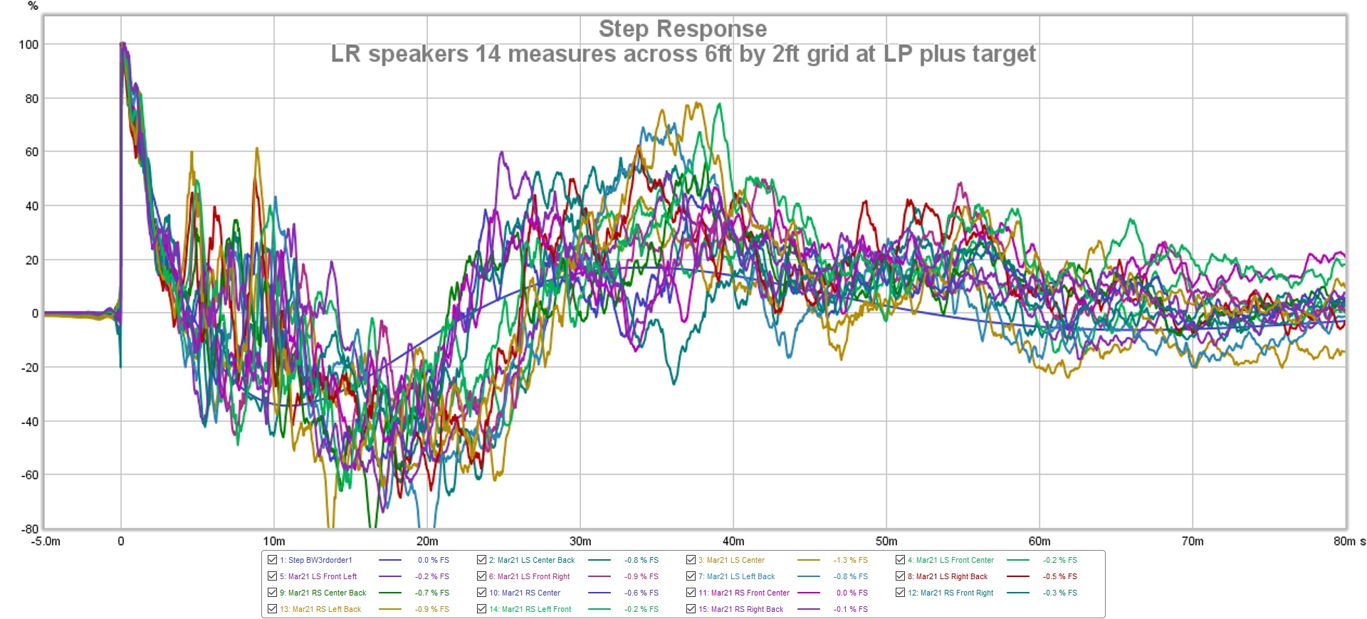

The time alignment listening window can be quite large for multiway's as well. Here is the step response of the same active 3-way I posted earlier, except I took 14 measures of both left and right speakers over a 6' x 2' grid which covers my couch area at the LP:
635126d1505271011-rephase-loudspeaker-phase-linearization-eq-fir-filtering-tool-rew-lr-speakers-step-14-measures-6ft-2ft-grid-lp-plus-target-jpg
The drivers are time aligned over the 6' x 2' listening area as indicated by the vertical "step" overlay at t=0. Moving the height of the mic up and down by a foot each way, produces similar results. I have overlaid the "ideal" step response as well. The peaks at 4ms and 8ms are the bounce off the rear wall from the measurements that were taken near the back of the couch area. i.e. the mic is (much) closer in distance to the rear wall versus the distance to the speaker.
Thank you for this measurement(s). It shows very well how the visuals of the time response measurements changes quite a lot inside the sweet spot. The sound is NOT perceived as very different inside the listening area, I guess.

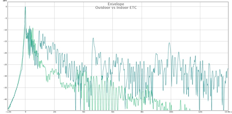

I have tried a variation of the spatially averaged measurements using a beamforming method: Quasi-Anechoic Measurement of Loudspeakers Using Beamforming Method (PDF Download Available) I got similar results to these published and does sound different. Does the spatially averaged technique you are mentioning produce similar results as in the linked article?
Hi Mitch, yes I did find the same result. It really works to reduce the amount of room influence in the measurement. It keeps the issues that are not position specific. The more measurements you use to average the more the room is suppressed. I have settled on Centre, 10, 30 and 50cm either side at ear level as being a good balance between room suppression and the time it takes to do the measurements. My first test had 22 in total and it took most of the day to do.
I posted an ETC on my thread here that shows the reduction quite clearly

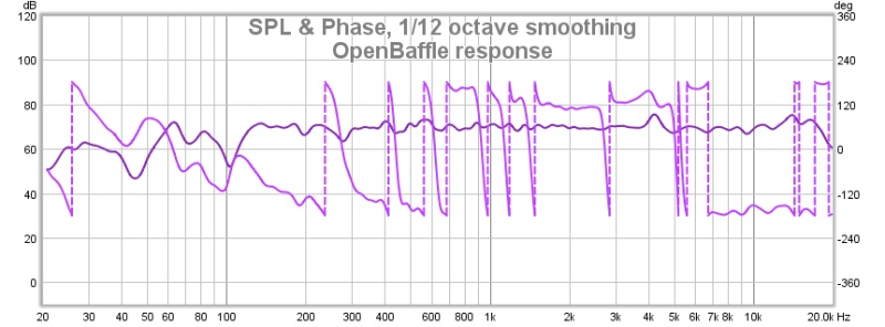

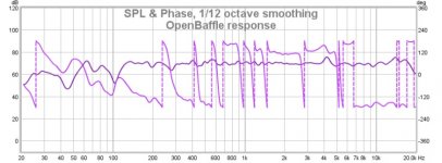

Everyone I am new to using the rePhase software for the first time. I will outline what I have and generated and many questions to ask but limit to asking what I need to know first.
Speakers: 2 way open baffle(similar to LX Mini, cross at 750Hz)
Equipment: MinidspHD 2*4 way
Software:REW via Umik and Rephase
I generated a x-over at 750Hz Using LR 2nd order, then I used the REW to equalise the output to relatively flat. I downloaded to Rephase software and was I unable(due lack of knowledge of rePhase) to make the phase flat. Attached is my freq response and phase outputs, I would appreciate for advice on how to make the phase as flat as possible.

Phase from an in room measurement will be a mess and you cannot flatten it or nor do you want to.
Try using a Frequency Dependent Window on the measurement the phase will look a lot cleaner. Go to IR Windows tab tick Add Frequency dependent window and then select the amount of cycles. 6 to 15 cycles will probably be best.
To undo the phase turn from the second order filters you can go into the Filters linearization tab in rephase select LR 12dB and your crossover frequency.
To remove the excess phase use a 6 cycle Frequency dependent window on the measurement and generate an excess phase version in REW from the all spl tab controls. Save that measurement as text, import the measurement into rephase and use the paragraphic phase EQ to make the phase closer to 0 avoid trying to get rid of the big jumps in phase because they will be due to reflections. Generate a filter as a wav file at 32 bit and load that into a convolver to test if you use a computer as a source, I can't help you with the best way to get that filter into a minidsp as I have never used one.
Swiss Bear wrote a tutorial linked somewhere in this thread search for his posts if you want to see some screenshots.
