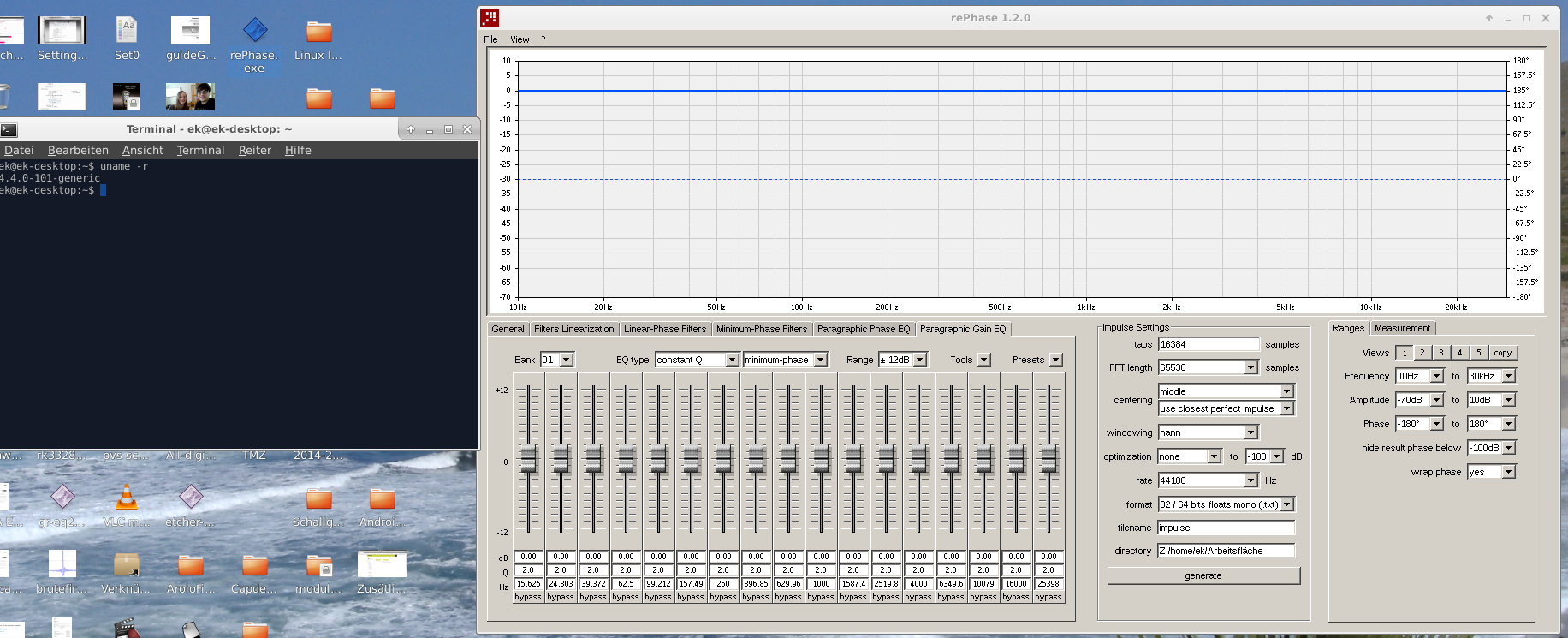

I am using Ubuntu 16.04 LTS and rePhase is working flawlessly with wine.

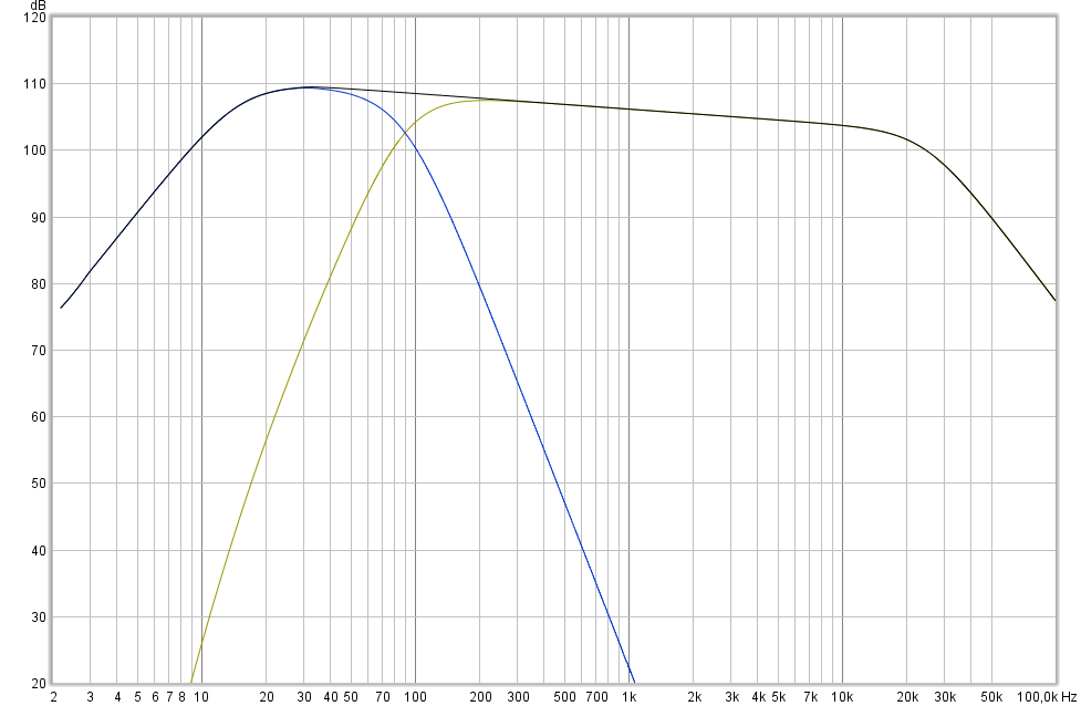

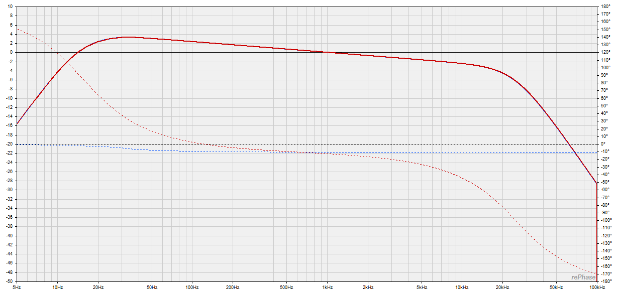

Okay when you have measurements then to find roll off Q export that measurement to Rephase and maybe its good idea in REW before export make a minimum phase version of measurement on "All SPL" tab, and after that into Rephase one way could be on "Minimum-Phase Filters" tab use mode "compensate" and for shape "2nd order" and try flatten response using right Q and frq to get number for Q, one other way could be use "box" method you show in post 2367 and find the Q and frq that makes phase flat, but a note is this above will only work for 2nd order slopes, if its anything else then try in compensate mode to use other shapes.
That said understand you have got good results linearizing phase of crossover points so if this last step is to linearize phase down to DC potential will say have some serious critical listening session looking for if rhytm from music performers gets a bit spoiled because that's what some observe when trying to linearize phase much further than track material was mixed at, below is example of what i mean where red is final system response and belonging minimum phase for a 15Hz-25kHz domain decreasing as frq goes higher and XO points are linearized, the warning above is about blue phase seen below that you have to assess yourself if it sounds good plus rhythm and natural.

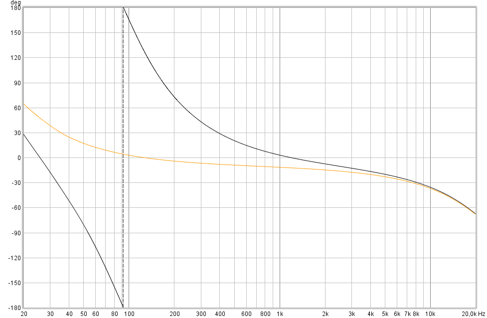

Yes its correct to measure each speaker without any electric filters to get overview of combined box and mounted drivers summed output and notice they can end be a bit different in F3 point, that said for your front speakers case you need their measured acoustic high pass slope to be of a kind that sum well with measured acoustic low pass slope of subwoofer and that known slope is the one to linearize in Rephase at "Filters Linearization" tab so that XO points phase distortion will be neutralized flat and only amplitude will roll off. For example if you use whatever numbers and type of minimum phase EQ filters in DSP to get front speakers have a smooth correct acoustic LR4 high pass slope at 90Hz, and use whatever numbers and type of minimum phase EQ filters in DSP to get subwoofer have a smooth correct acoustic LR4 low pass slope at 90Hz, then in Rephase on "Filters Linearization" tab under "Crossover" pick "LR 24 dB/oct" at 90Hz and load that FIR phase correction into DSP to get a linear phase XO point, for the latter you could also in "Box" set "closed Q=0.707" at 90Hz twice times and thats because LR is always a cascade of two half the order BW filters.
Low end slope roll off for sealed box is 2nd order butterworth Q 0,7071, and for bass reflex box its 4th order butterworth and think Q is 1,31, and for info most drivers natural acoustic low pass roll off is also 2nd order BW but for tweeters because we so high in frq it often looks like much steeper because microphone plus analog stages and ADC/DAC converters also push their low pass roll offs into picture.
Black phase track below is how it would look sum two divided LR4 smooth slopes minimum phase pass bands at 90 Hz, and orange trace is after FIR filter phase linearization.

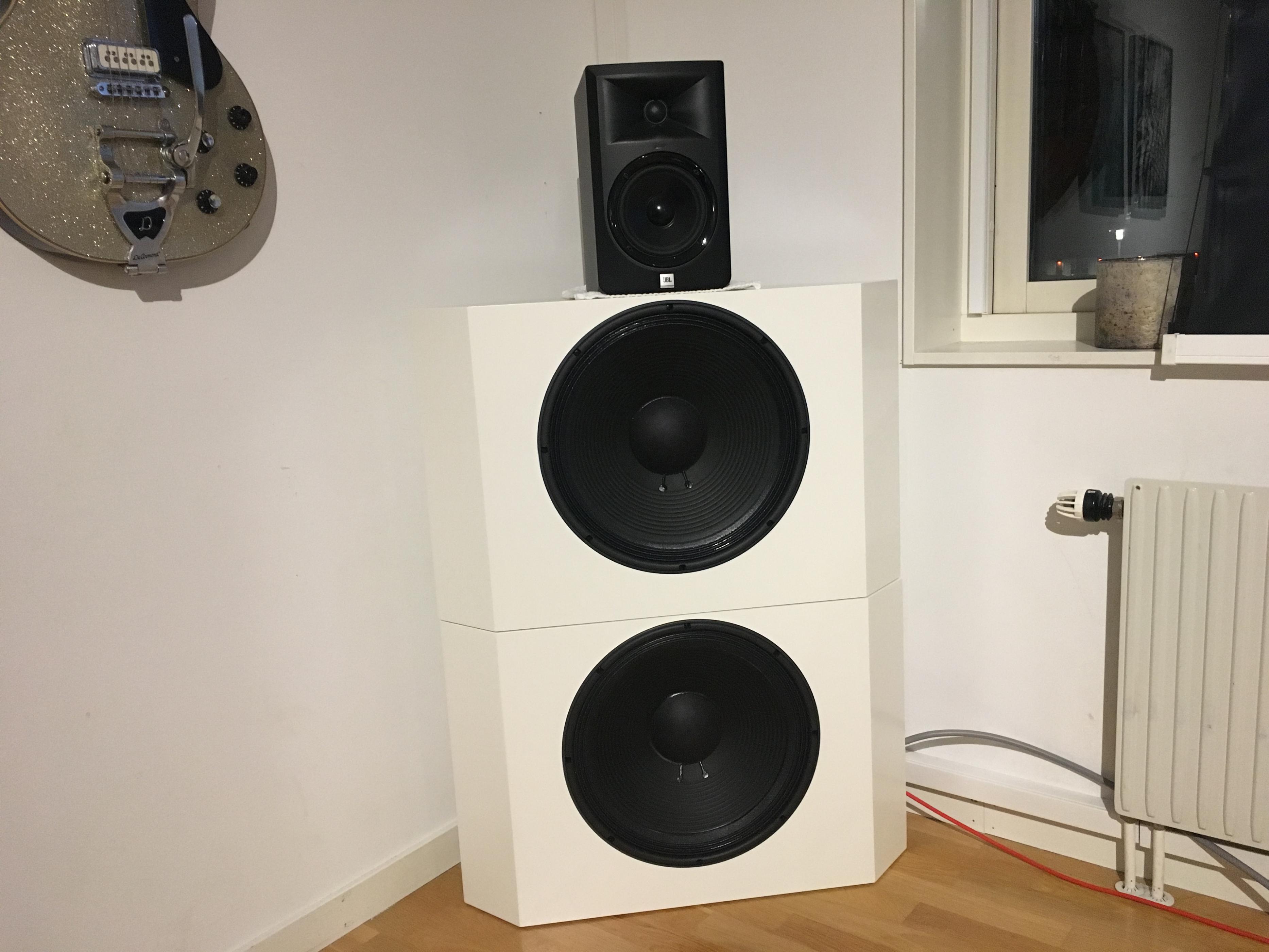

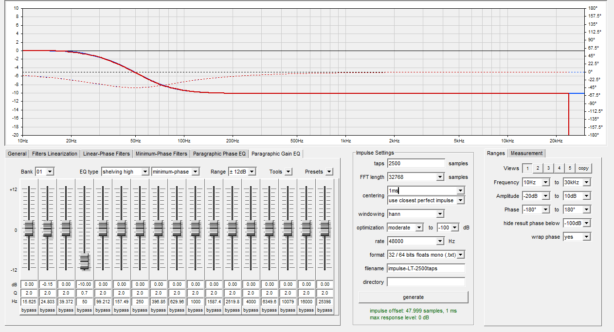

I did a kind of Linkwitz-transform yesterday in rePhase. Loosely based on the simulations of my LF-boxes. I will use this now until measurements begins.
I am in the middle of a DIY-project. LF-boxes are done. Waiting for HF-boxes to be ready. Using JBL LSR305 as top temporarily. Sounds pretty great actually. LSR305 really benefits of not having to play low frequencies.

You can do a real LT with rephase: first compensate the estimated natural filter of your box (high pass minimum phase filter in compensate mode) and then "replace" it with whatever high-pass filter you want: minimum or linear phase, any slope (preferably equal or steeper than the compensated one), any frequency (caveat emptor of course).
Just make sure you do not exceed 0dB: lower the level in the misc tab at the end.

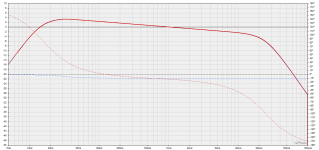

Hello, It would have been nice to have the option to import amplitude and phase traces from Rational Acoustics Smaart (.trf files).
My aim is to generate FIR filters to import to Powersoft X8 dsp amplifiers, which accepts .csv files. I've found a way to generate those by importing rePhase .txt files into Excel and saving as csv, than it could be imported to the X8 and that seems to work - now I'm looking for a way to import Smaart traces to rePhase and so far I can't find a work around.
I've been thinking of using REW for this purpose but as i'm already familiar of using Smaart that seems silly to me.
Hello udigur
If I can have access to a format description for the trf files then I should be able to implement them into rephase.
Regarding csv file export, Rajapruk made a similar request a few posts above.
Is the csv you need a single line with comma separated values? No spaces?
I am going to work on it, and send you a test version along with the one I will send to Rajapruk.
Thanks for the quick respond pos!
I think Powersoft requires csv with comma seperated values, which seems to be csv initials :)
maybe you could include other options for csv exporting if that would make any sense. I'd be happy to test them out and come back to you with results.
regarding trf files, i'm not sure how to acquire the format's description but here's a link to one and if no other software is able to open it other than Smaart than that's the way to go. Tell me what I can do to help!
Dropbox - 770 250ohm.trf
That should give a frequency and phase response that looks as in this photo:
