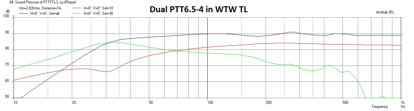

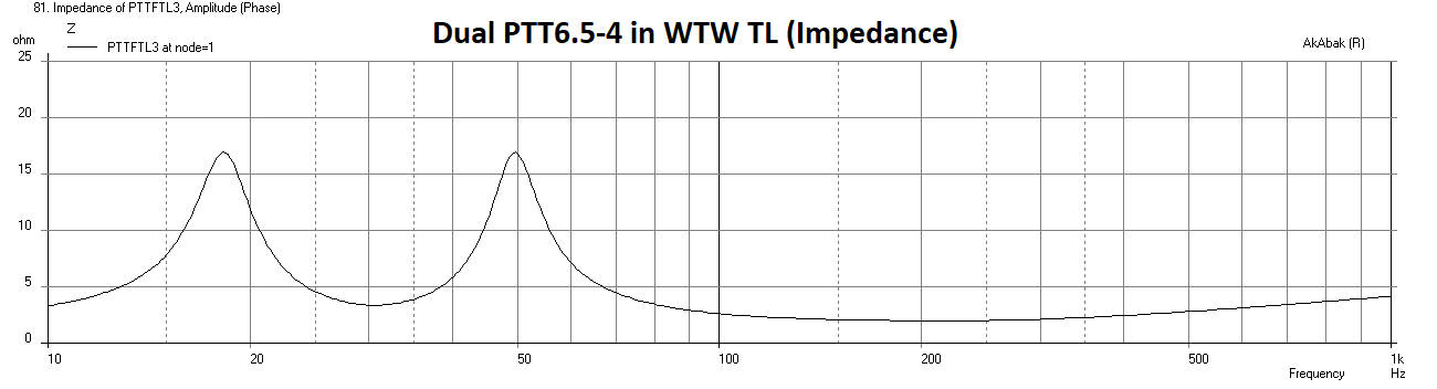

I got a request to see how this TL would work with dual PTT6.5-4 (4 ohm drivers). The person requesting this says that they have a 2ohm capable amp.
It still works quite well with no changes to the TL design. The sensitivity will be about 89.5dB at 2.83v (nominal 3.4ohms and minimum of 2ohms at 200Hz) with -3dB at 35Hz and -6dB at 29Hz. Max SPL of 105dB (1m) at Xmax of 10mm and 18Vrms.
Here is predicted freq response at 2.83v:
Here is predicted impedance:

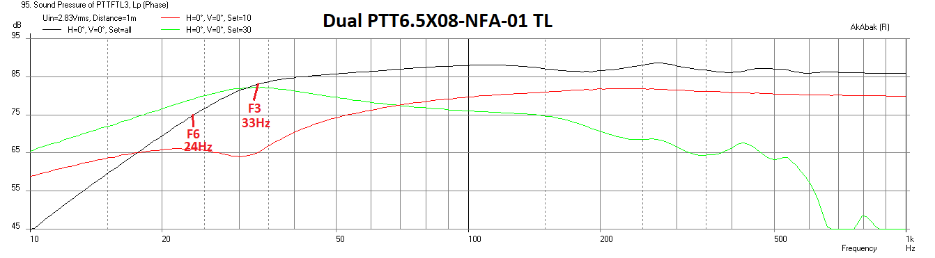

I just redid the simulation (same cabinet dimensions and plans) with the PTT6.5X08-NFA-01 Driver. It apparently is tuned a bit lower and got some really good results. The sensitivity is still 86dB but F3 is now 33Hz and F6 is 24Hz.
I would say that this is the driver to go for.
Predicted Freq Response for 2.83v at 1m:
