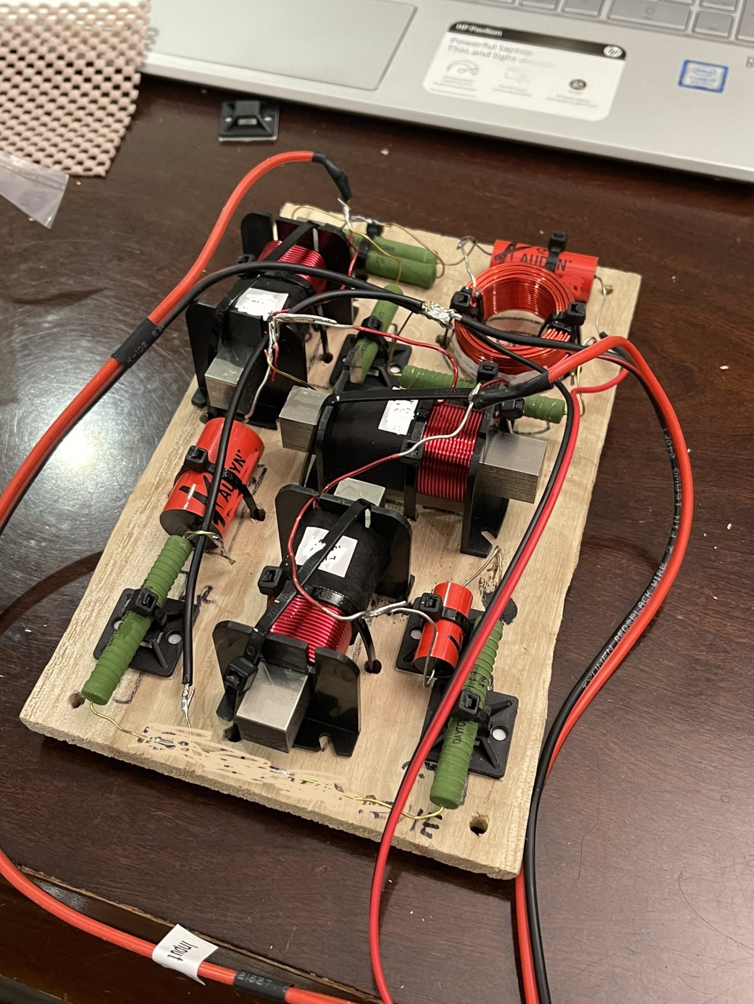

Resistor was before the 2.2uF cap. The cap and RAAL with its built in transformer were measured as one unit for the FRD.

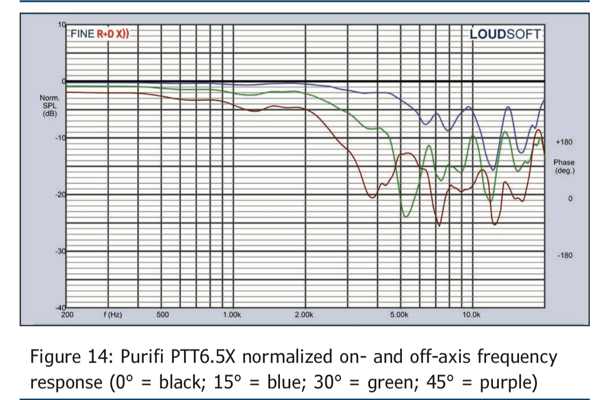

XRK, based off the Voice Coil measurements (below), it looks like the PTT6.5 is 6dB down at 45° at a frequency of around 2250Hz. If a waveguide was used on the Raal to both boost the low frequency SPL on axis as well as delay the Raal relative to the woofer, could a Harsch crossover still be implemented at a 2.25kHz crossover frequency? Also, how would you feel about crossing the 70-20XR that low?
The Harsch XO requires that the tweeter be delayed by 2xTau where Tau is the characteristic period (in seconds) of one cycle of sound at the XO frequency. The difference between 2500Hz and 3500Hz is 200 microseconds. Multiply this by the speed of sound (342 m/s) and the extra delay needed for a 2500Hz XO is an extra 2.7in deep setback relative to where it was for the 3500Hz crossover. So if your new 25000Hz waveguide is 2.7in deeper than the one I used (which I got lucky with how everything lined up, then it can work.
I think I RAAL 70-20xr should be ok at 2500Hz. Specs say it can be crossed 4th order at 1800Hz. Only a single cap is needed as the inductors are already built into the signal transformer inside.

I’ll have to review what your original offset was. It would be nice if a waveguide could provide both the optimal offset for the xo frequency as well as match the off axis response of the 70-20 to that of the purifi at xo as well.
It’s was 2.1” (at 3500Hz) plus the additional 2.7” you quote to XO at 2500Hz is a total of 4.8” Z offset. Not sure a OS waveguide will give me that offset for a 90° waveguide that holds pattern to 2500Hz but I’ll cross that bridge when I get to it.

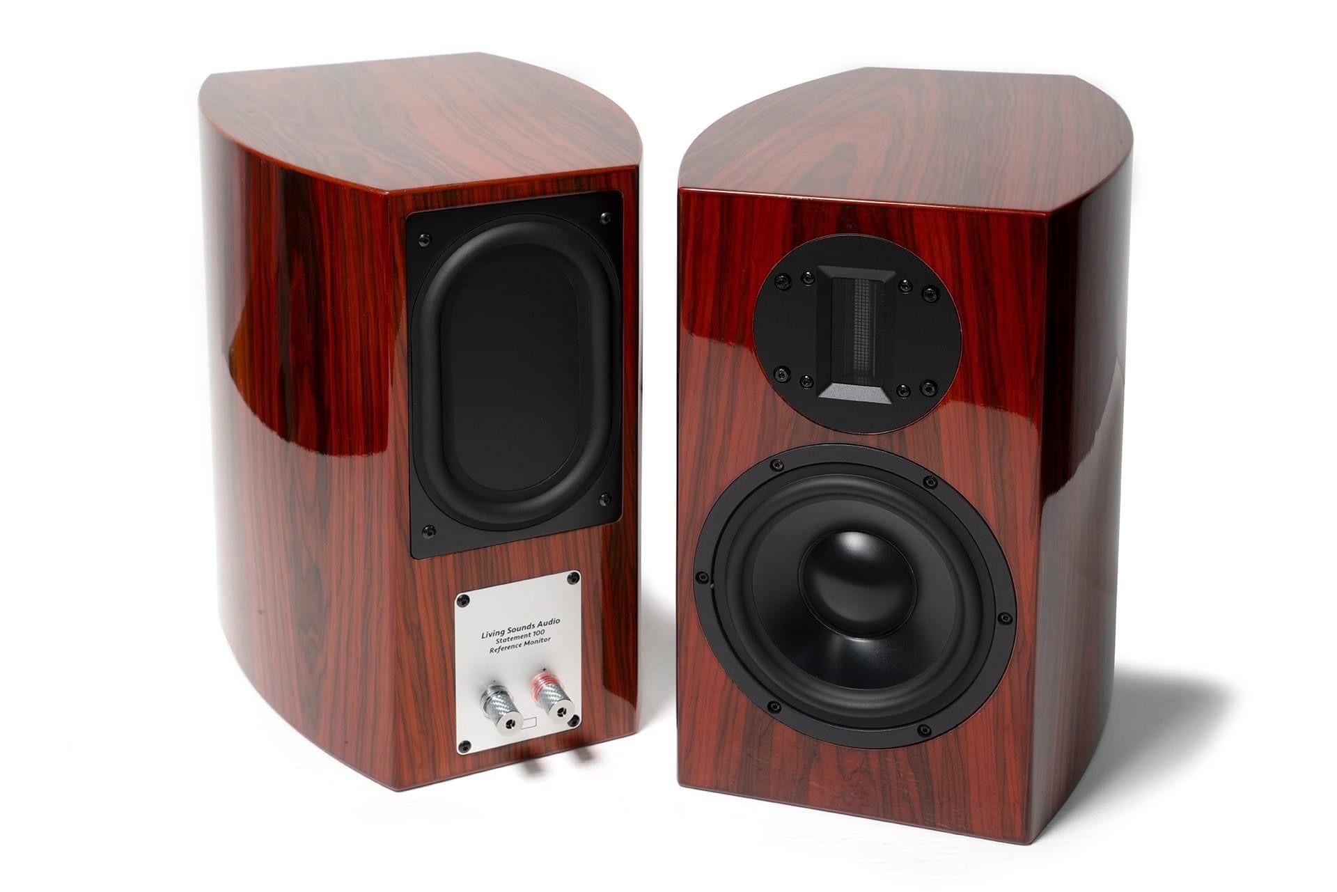

I sold my PTT6.5 woofers and waveguide dome tweeter in TL to a friend - never got a replacement, just seems too expensive. I have the RAALs still ( on loan from friend who hasn’t had a need for them back. )
In the meantime, I found a great alternative woofer - custom OEM Wiggins XBL technology. 10mm xmax, linear BL motor. Custom OEM ribbon. My own crossover. It became the LSA Statement 100
Having listened to both woofers, I can say the Wiggins is almost as good and at a fraction of the cost. I just can’t justify spending $400+ on a 6.5in woofer anymore.
Those look really nice! The finish on them looks really good too.
