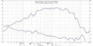

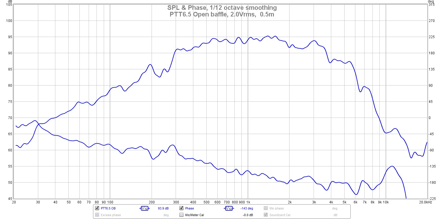

Here is the PTT6.5 response measured in the narrow OB at 2.0Vrms and 0.5m on the woofer axis. The signal seems high, and I was never able to debug what was going on - but sensitivity seems about ~5dB too high as it should be 88dB at 2.0Vrms and 0.5m (same as 2.83vrms and 1.0m). But there is no OB overshoot peak. It is quite well behaved and would be very easy to integrate to a woofer at 300hz to 400hz.
Thank you! Yeah, that looks really promising for a simple 1st order to the woofer, maybe it's even possible to just LP the woofer and offset the OB for phase. Either way, should be fun and I'm finally ready to purifi my wallet and jump in on OB experiments with them.

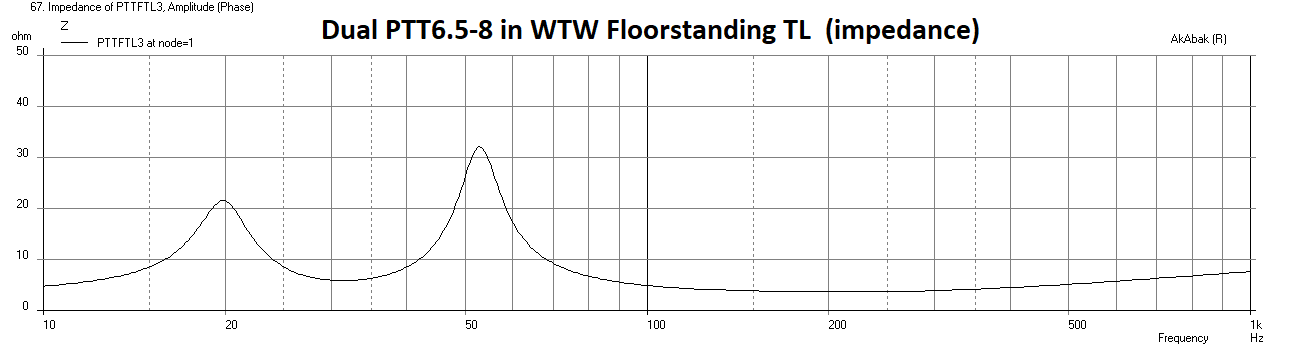

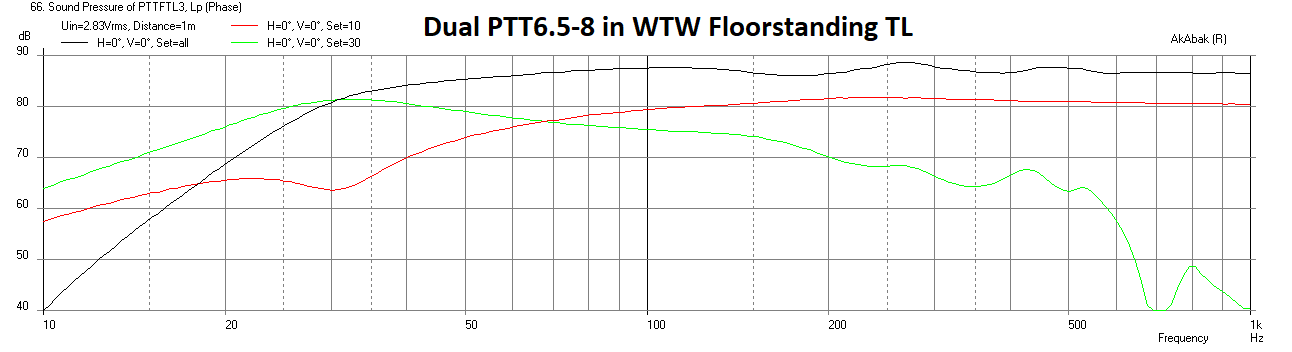

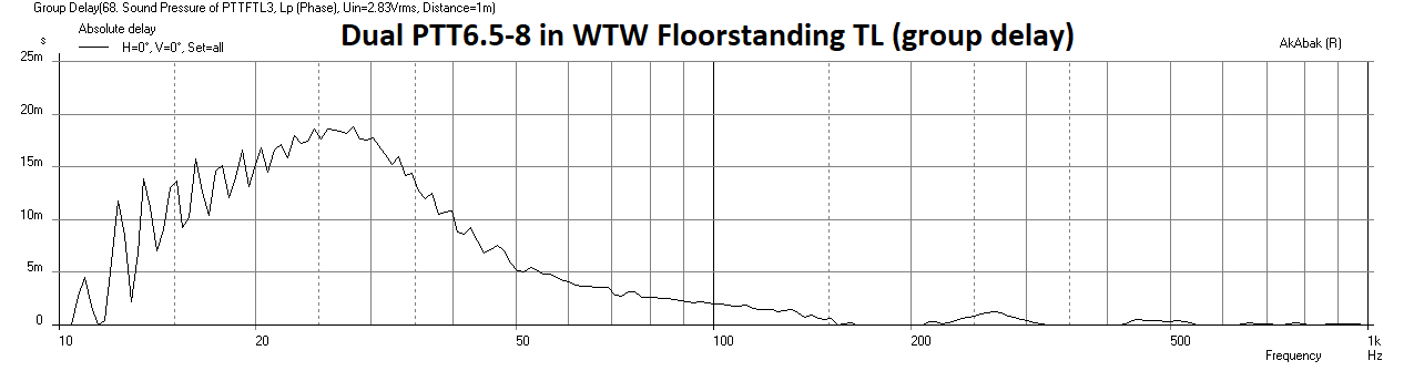

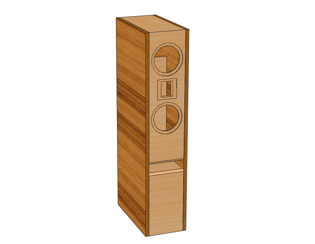

Floorstanding Dual PTT6.5-8 and RAAL 70-20xr TL Design
I just completed the design of a dual Purifi PTT6.5-8 (new 8ohm variant) with a RAAL 70-20xr tweeter in a WTW floorstanding TL. The 8ohm woofer is a tad bit less sensitive so two in parallel only buys about 2dB more sensitivity after baffle step losses. Howver, they can achieve higher SPL's before distortion sets in. This tapered TL is based on a similar design used by my 10F/RS225 FAST TL speaker.
The speaker is 45in tall x 9.5in wide x 18.5in deep. The TL achieves 86dB sensitivity in 4pi space at nominal 4ohms with -3dB at 36Hz and -6dB at 28Hz. Group delay at 50Hz is only 5ms (same as a sealed box).
Predicted Freq Response:
Predicted Impedance (woofers only):
Predicted GD:
I think the woofers will integrate perfectly with the RAAL using a similar XO to what is discussed in this thread. If you interested in this design, send me a PM.

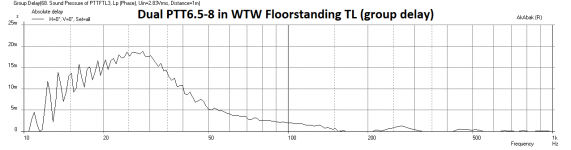

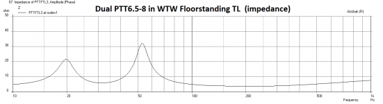

Predicted GD:
