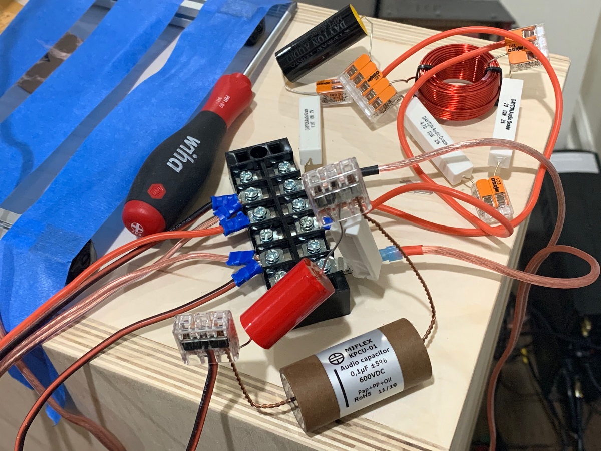

Added a Miflex KPCU-01 0.1uF 600v paper/PP/oil cap bypass on the 2.2uF RAAL tweeter cap. Listening now - subtle but nice improvement in detail over a no-name 2.2uF film cap. A RAAL definitely deserves the best caps you can afford.
Only a bit? Try with Hotel California (Eagles). In my small coaxial the difference between the two loudspeakers was overwhelming.
Maybe the RAAL tweeter is not so good 😛
That red no-name cap looks very much like Chinese "Audiophiler" caps that are the worst sounding PP caps I have ever encountered. They were sonically behind even MKT block caps in my comparison. Miles under Miflex league anyway...
Those are temporary development kit caps. I have a set of Clarity 2.2uF 630v CMR caps on the way - should be here soon. The red Chinese caps work for temp duties - they were ranked a 7 out of 15 by Humble Homemade HiFi:
Humble Homemade Hifi - Cap Test
These are the new Clarity that are on order:
ClarityCap Capacitor 2.2uF 630Vdc CMR Series
Bypass caps have different effects in different crossovers and systems. In your case, it is for a KEF 1st order filter in a coaxial, here it is a 2nd order filter and at a different frequency and with a riboon vs a dome. Lots of different things at play. A RAAL certainly sounds better than any dome tweeter I have heard from a standpoint of resolution transient effects.
Logically, fewer components needed in the filter, more the differences in the quality of the components, if any, should be noticed. So I am resisting increasing the complexity of the KEF Q100 crossover, maybe the woofer section.

"The red Chinese caps work for temp duties - they were ranked a 7 out of 15 by Humble Homemade HiFi:
Humble Homemade Hifi - Cap Test"
I know 😉 I was shocked to see 7 there... my guess is that their production QC varies and I got a real bad batch. Good thing you got Claritycaps
