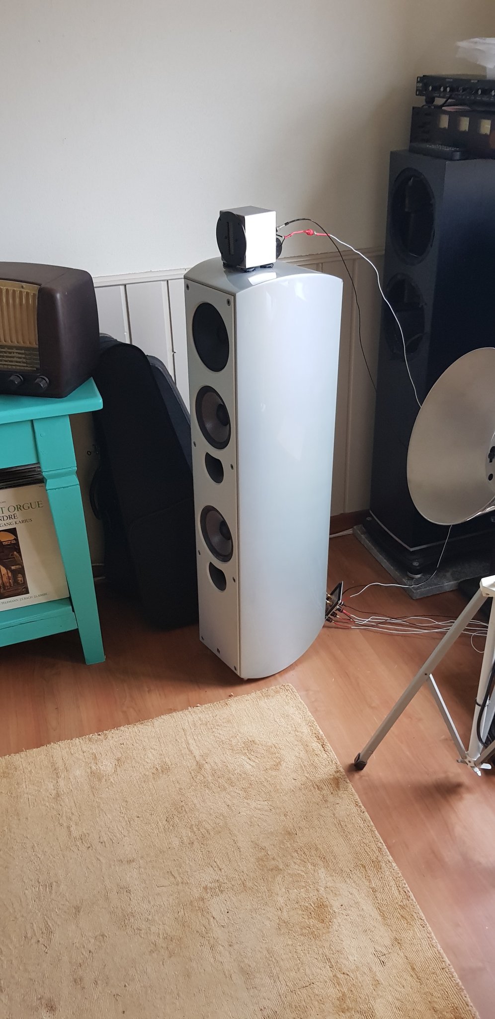

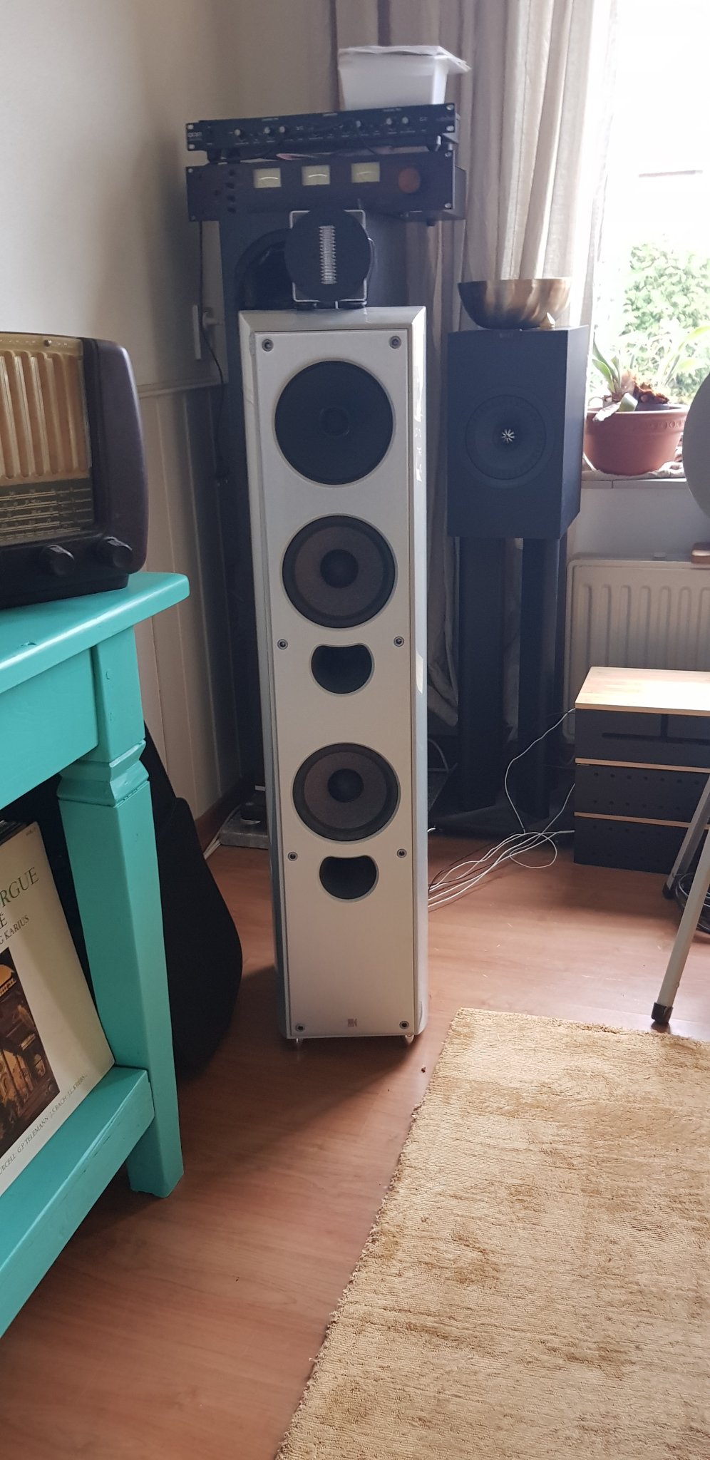

Thanks for your support, I'll did the RAAL as supertweeter on top of the speakers, and it was like everything opened in the whole room. What an delight!
