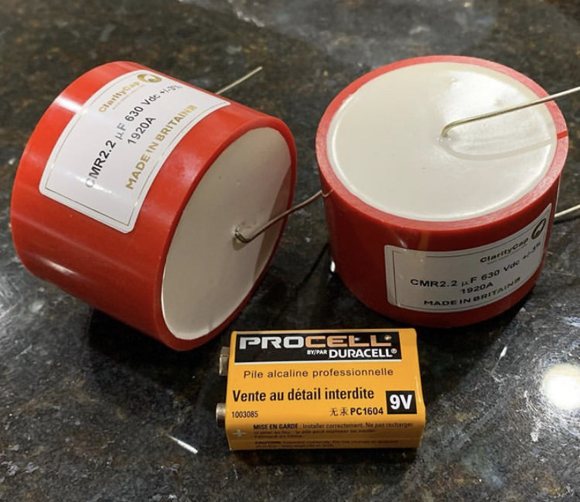

I recently got the 2.2uF CMR Clarity cap. It’s huge, about same size as some 50uF MKP caps.

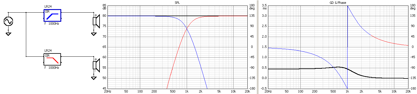

Sum is not always greater than individual - depends on phase. Look what happens at XO frequency when an LR2 has drivers of same polarity. You get a deep cancellation notch.
For Harsch XO, there is a slight dip to the left of the XO frequency and this is one of the tell tale signs that the Harsch XO is being implemented correctly.
S. Harsch XO

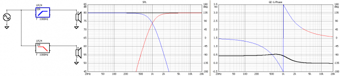

Here is the present XO (small dip to the left):
S. Harsch XO

You should read up on the Harsch XO. The Harsch XO has obligatory 1dB dip on left of XO freq by design, but that is one of the compromises to get a flatter acoustical phase. Look at acoustical phase - flat with 55deg rise and no wraps. Compare that to acoustical phase of LR2 or LR4 crossover.

Sure. What’s the step response on your crossover with a “non-messed up” phase look like? Is a right triangle or a messed up cacophony of up and down pulses? Outside of the Harsch XO, the only other XO that is flat phase is 1st order transient perfect. I like those too.

From a technical point of view an improperly designed 2nd or 4th order crossover, with wonky phase integration can show similar properties. Sure the phase isn't flat like with the Harsch, but it shows points of destructive interference at some points and constructive at others (like the Harsch shows). This sounds bad. Bad at least vs the correctly phase aligned system.
I cannot see why this wouldn't sound the same. And what does the response look like if you invert the polarity on one of the drivers?

Some people are more sensitive to transient perfect speakers than others. I can hear the difference in drums, guitar, piano, and stand up bass very clearly. Having both woofer and tweeter of the same polarity is important for this effect and with LR2/4 the tweeter is always inverted. On an LR2, the phase varies 180deg over the audible range, it is always changing and never flat. Maybe some people have grown accustomed to that sound? For me, once I heard a full range driver I knew it was right and then pursued multi ways with a similar flat phase. This included 1st order, the B&O hole-filler XO, and now Harsch. But to each his own. For me it sounds more “right” than LR2/4.

But if the acoustical phase (as measured by a mic or heard by our ears) is flat through this “messed up” region, how do you hear it?
I agree that an improperly designed crossover that may be flat by has tons of phase shift sounds bad - I call it “phasey” and it is more apparent when I rotate my head at an angle.
I have tried this with DSP by adding lots of phase wrap but keeping response flat. It’s audible and annoying. However, here, the phase shift is a gradual 55deg rise and fall. Not so audible.
