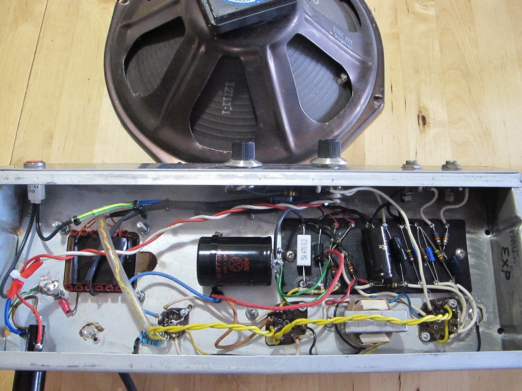

Here is what I think I would do next fwiiw.
(Before starting something like this I would print out the schematic, measure all the existing actual voltages and write them on it)
- unsolder the wire to the screens (pins 6) from the junction of R12 & R13. (Personally I would just cut 5mm in to give me an easier soldering point)
- I would then solder in a 10k 1w resistor from the junction to the screen wire
- then measure screen voltage. If voltage 300 or less go to next step, if not, replace 10k with something bigger.
- next jumper/short out the 470R cathode resistor - reducing the total cathode resistance from 1110R to 640R
- measure all the voltages again (anode, screen, cathode, both ends of R12)
- calculate anode and screen dissipation
If all good unshort the 470R and short the 640R. Repeat the 2 steps above.
Take it slowly, take good readings, think about what the results mean.
The goal is to eventually get as close to the stock value of 220R as possible without melting your amp (or yourself) and learning as you go.

Ok, got the voltage down to 307v using a 33k resistor
With the 680ohm cathode bias resistor these were the bias calculater numbers:

With the 470 ohm resistor these were the numbers: Not real sure what this all means so I'll leave it to the experts [and do some reading on the topic]
But this looks too high, so what bias resistor value would be ideal?

Oh, got the screen voltage down to 270v with a 47k resistor.
Also, my 22uf filter caps arrived and I tacked em in just to hear it. Still power supply noise so I ordered a dual JJ 50uf + 50uf cap.

That's great progress.
Are you learning using the online calculators?
The reason I suggested measuring voltages/currents - make a change-re measure the v/I was so you could learn the relationships.

So 65% Pd is looking good. Dropping the screen voltage will let you reduce cathode R some more if you wish.
But you still haven't told me how the plate voltages move with each change.
The trend is as important as the absolute values because it will show how the replacement transformer behaves under different loads.

Well, I'm still trying to wrap my head around all this.
But I am measuring the voltage with each change and observing the differences.
Priority #1 right now is to get the amp in gig condition as if all goes well I'll give it a go saturday!
Do you think the 270v on the screens is a good voltage?

The layout diagram in post #48 indicates that there should be a ground connection on the vol. pot - on the terminal where a wire links across to a terminal on the tone pot. Where does that ground connection go to, and is it making a good solid connection.
Also the grounding scheme seems to rely on the input jacks making good mechanical contact with the chassis - might be worth unscrewing the jacks and cleaning the chassis and the jacks (where they touch) with some emery cloth.
A minor thing - but it might just help. I think your new 50+50 cap has two green wires and one black wire coming out. Try bending both the green wires over to the other side so that they are close to the black wire.
The current in these wires is very 'buzzy' and by minimising the 'loop area' we can minimise the amount of interference radiated out from this circuit.
Another thing - comparing the photos in posts #89 and #110, it looks like you have moved the black wire coming from the PT to a different connection point. It should be on the connection point where the cathode resistor connects to the 50+50 cap, not where the 25uF cathode bypass cap connects.
I know it looks like an insignificant change, but the current out of that 50+50 cap back into the transformer is part of the loop with the biggest buzz current in the whole amp. Even the very low resistance of that short section of ground wire, which now 'shares' that buzz current with the current coming out of the cathode resistor, could be significant.
Definitely worth a try to put that wire back to where it was.

Another thing - comparing the photos in posts #89 and #110, it looks like you have moved the black wire coming from the PT to a different connection point. It should be on the connection point where the cathode resistor connects to the 50+50 cap, not where the 25uF cathode bypass cap connects to ground.
Malcom, good looking out! You are absolutely correct! I'll pull the chassis tomarrow and check that out.
