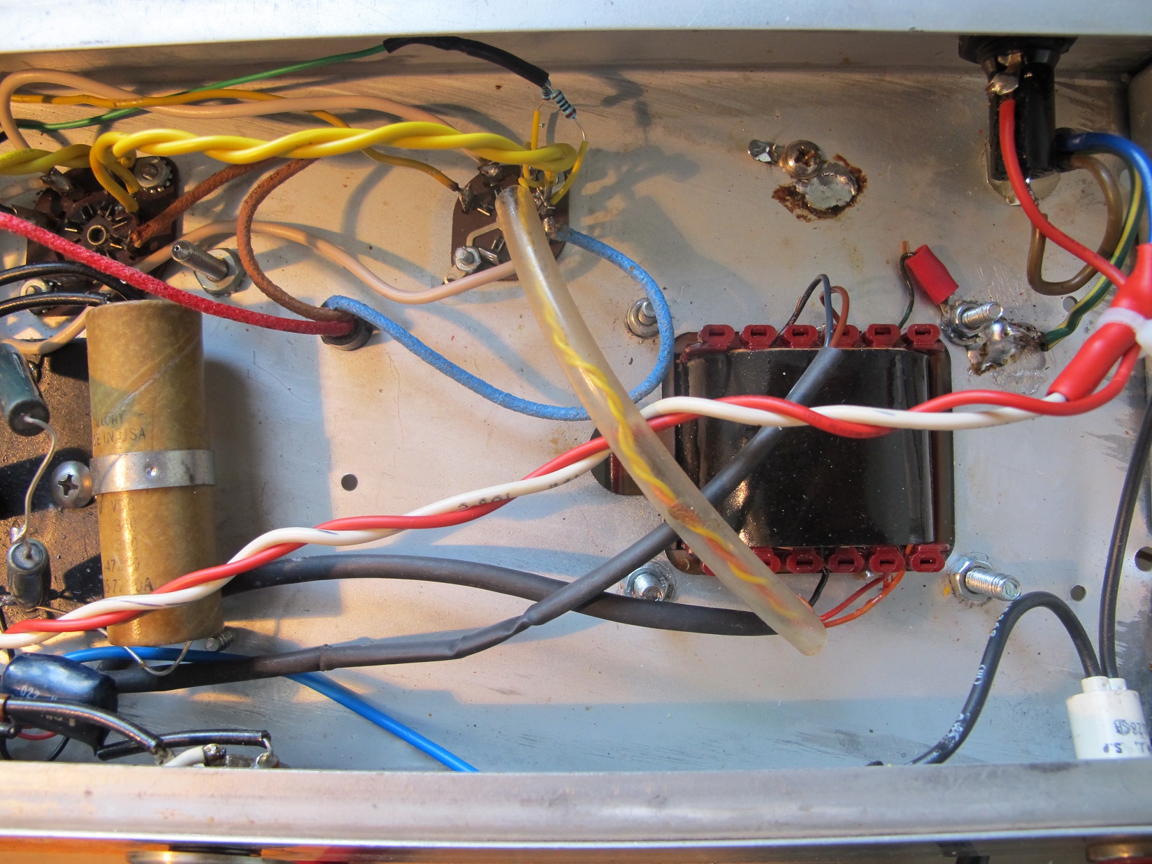

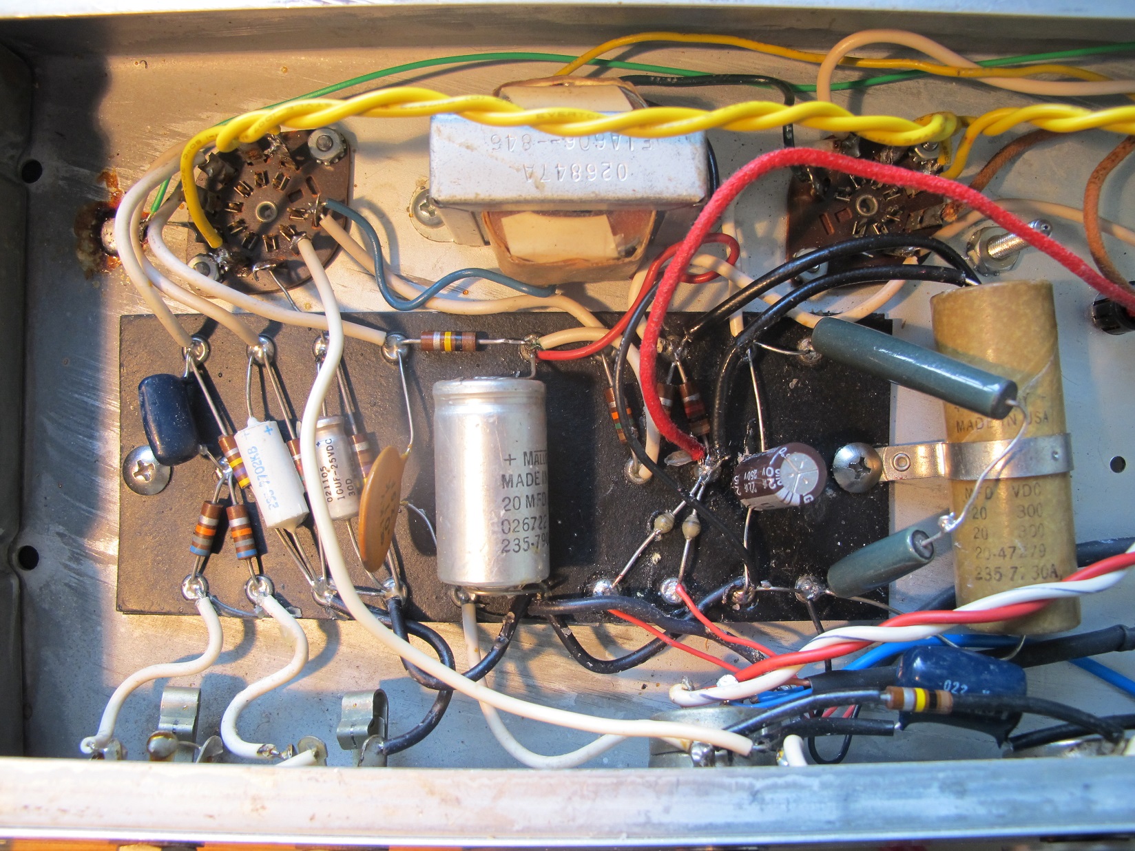

A couple photos for reference if that helps:

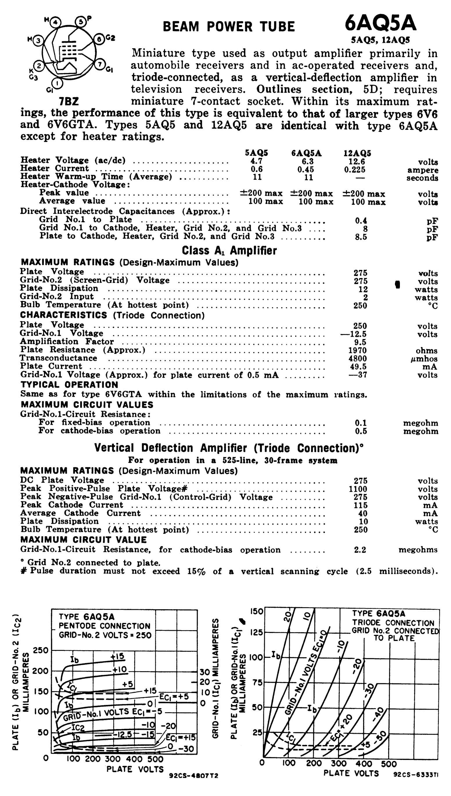

And the 6AQ5's will be fine...
Can you confirm what pins 4, 5 and 9 of the 12ax7 are connected to? It's hard to see for sure in the photo, but it looks strange to me.
4&5 heater wire to chassis ground, 9 heater wire. Maybe you are seeing the small socket on the right as the 12ax7, its actually the first 6AQ5.the socket was replaced by a previous owner.
Pins 4 and 5 should be connected together and to one heater wire (but not to ground). The other heater wire should connect to pin 9.
It won't work properly if you ground the artificial centre tap and ground anywhere else in that heater circuit at the same time.
(I'm looking at the socket at the extreme left.)
But Fender wired it that way, one heater wire goes to pin 4, threads through pin 5 and goes to chassis ground.
So I should un-do the Fender ground scheme? Its a much more robust ground than my 1/4watt resistors and long run of thin wire?
You can choose either way. If you go for the 'stock' Fender option you need to remove the artificial centre tap resistors altogether.
Or, you can keep the artificial centre tap and remove the ground on pin 5. This (more modern) way will give you less hum. The 'robustness' of this ground is not really an issue since there is only a tiny current going into ground.

Outstanding! Re-did the center taps with 1/2 watt resistors [and a bit thicker wire] and grounded them where the preamp pins 4/5 were grounded. Removed that connection to ground.
Noticable buzz reduction! Still a good amount, but much better.
