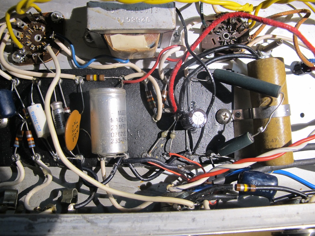

Not really clear at what junction of the diodes and the 1st 20uf cap the 1k 10w resistor should go?
image of the 1st 20uf and diodes

Pin 7 is not spare. You can see on the data sheet that both pin 1 & 7 are connected to the grid (G1)
See if you can connect the 100R resistors (value not critical) to the start of the yellow wires. Ground to somewhere handy in the circuit.
The circuit should attach to the chassis at one point only for least amount of hum (a whole new subject) 🙂
In your photo it looks like each diode has a one end each connected to a separate red/orange wire. The other ends of each diode are connected to each other and the 1st 20u cap.
My suggestion is to unsolder the cap ends of the diodes, and insert your voltage adjustment resistor(s) in the new gap between the diodes (still connected to each other) and the cap.
You may have to change this several times until you get the voltages you want. So don't cut any leads off short until you settle on final values.

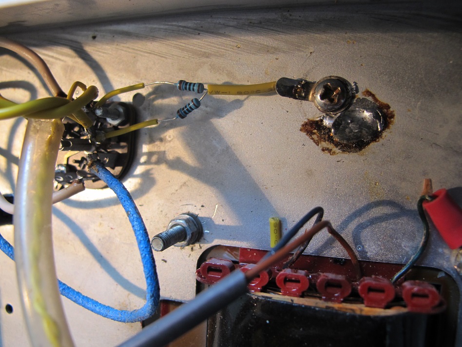

Trying to figure out where best to ground those 100ohm resistors.Would a small wire 'O' terminal on each tube socket mounting screw be adequate?
Also, I will be mounting a speaker jack instead of attaching the OT speaker wires directly to the speaker. As for the location of the jack, does it matter on a noise/RF interference level where I put it [should it not be near anything] or can I simply find the most convenient location?
You should only provide one artificial centre tap (with the pair of 100 ohm resistors) per heater string. The two 100 ohms resistors are best placed near the PT. The connection to ground (from the junction of the two resistors) only carries negligible current and can be to your main signal ground. The speaker jack is usually placed close to the OT. Twist together the wires from the OT to the jack.
You should only provide one artificial centre tap (with the pair of 100 ohm resistors) per heater string. The two 100 ohms resistors are best placed near the PT. The connection to ground (from the junction of the two resistors) only carries negligible current and can be to your main signal ground. The speaker jack is usually placed close to the OT. Twist together the wires from the OT to the jack.[/QUOTE
Could I put them at the end of the string off of the 12ax7? Theres a chassis ground next to the 12ax7 preamp tube, but its on the opposite end of the PT in the chassis.
Or I could extend them off of the first 6AQ5 and ground them on the power plug chassis ground.
