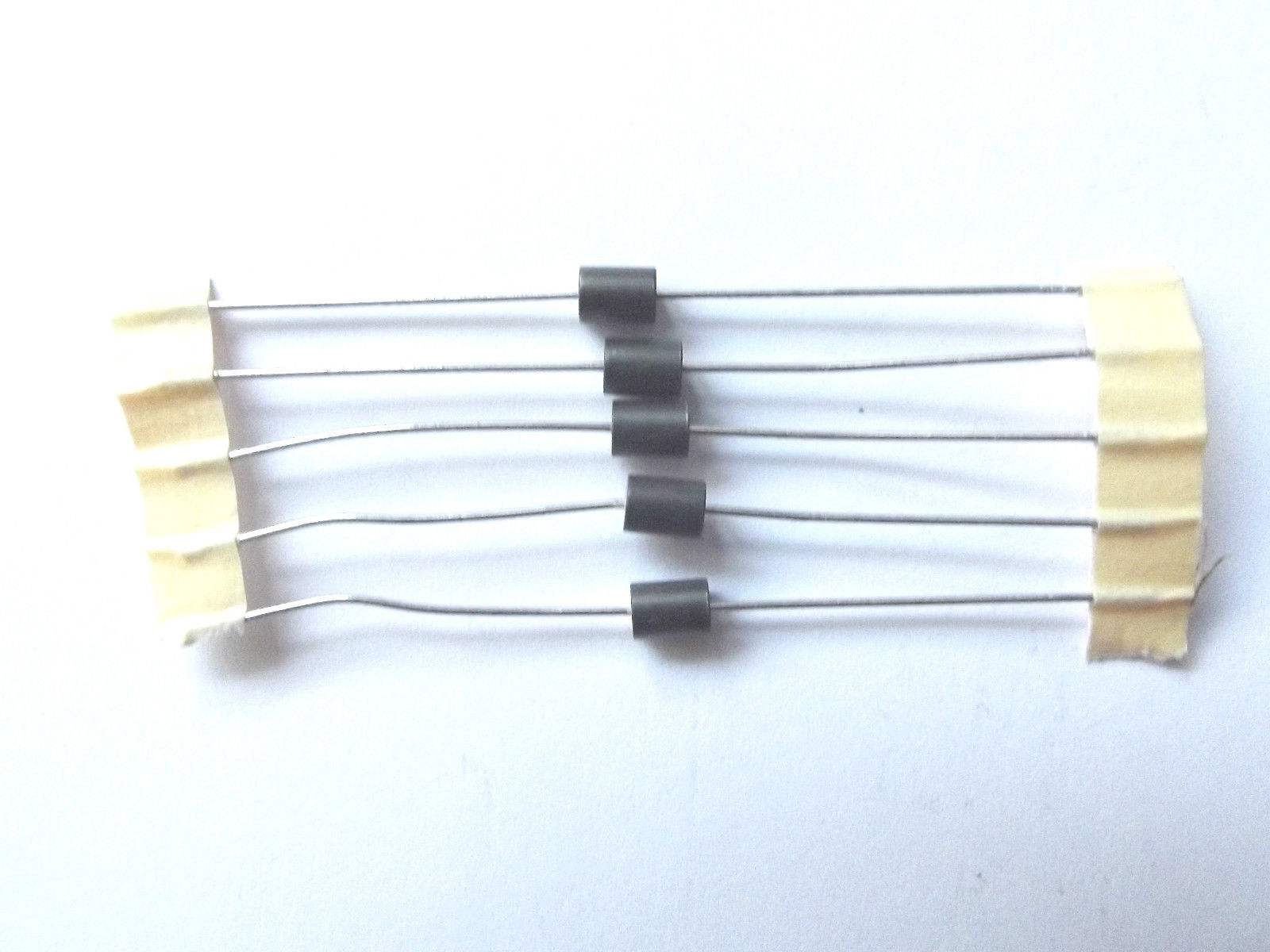

Alot of folks say to jumper that .0047 input cap as its not necassary for a guitar signal.What about using an axial errite bead for the jumper, wouldnt that help with the RF protection?
I too have one incoming in the mail. I'll be watching this thread closely for ideas from you more knowledgable than I on this topic!
RF protection?
The design calls for specific valves that work best at audio frequencies, the transformer cuts off at 20kHZ so RF is not an issue here. Most solid state amplifiers and consumer devices use RF blockers.
