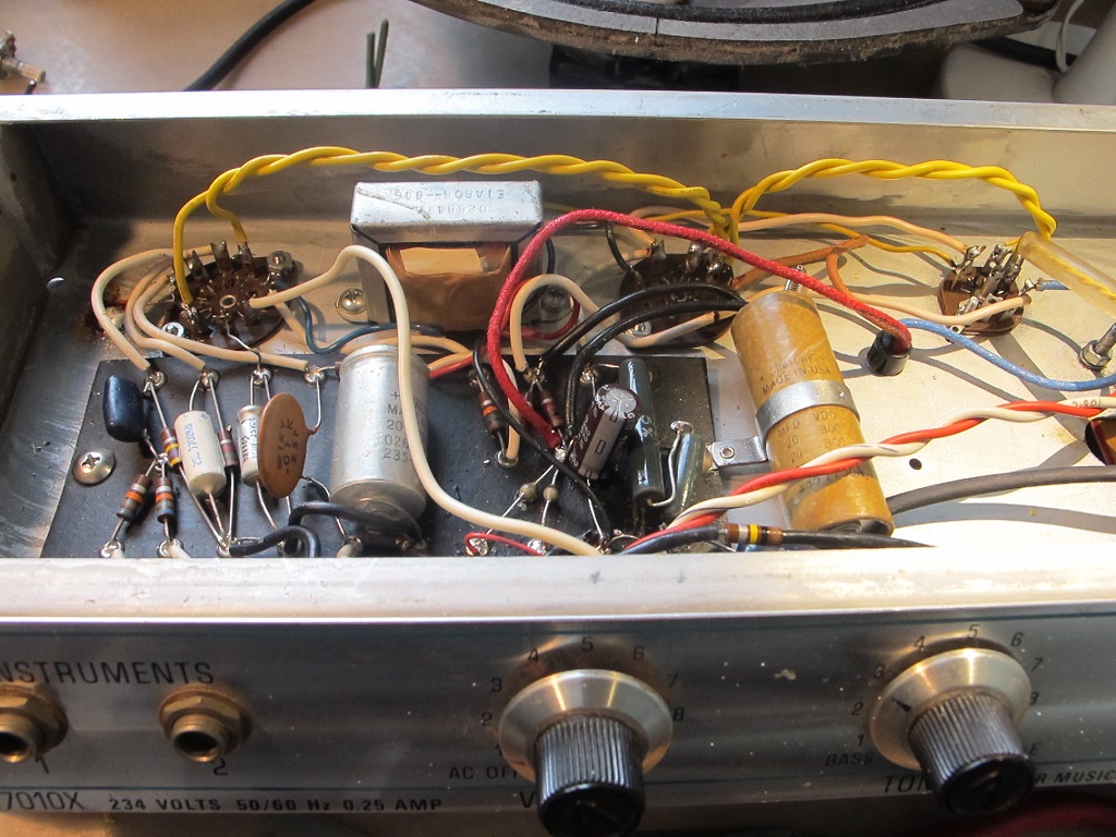

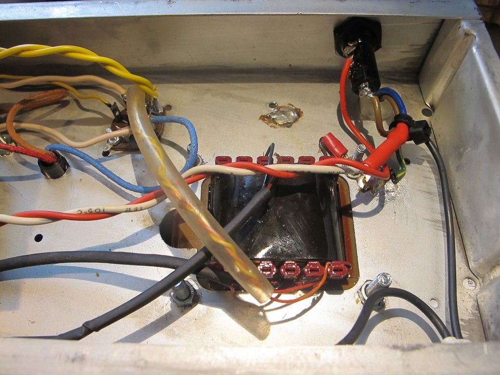

Ok, the amp arrived and she works great.Instantly greeted me with a beautiful Fender clean tone. I thought I would be doing a bunch of the recommended mods like the tone control mod,hasselbrock mods,jumpering the RF blocking cap etc. But I kinda doubt it now.Really a great,clean little handwired Fender amp.😎
There is some power supply noise that remains constant regardless of the vol/tone settings. I'm hoping that new filter caps will help here.

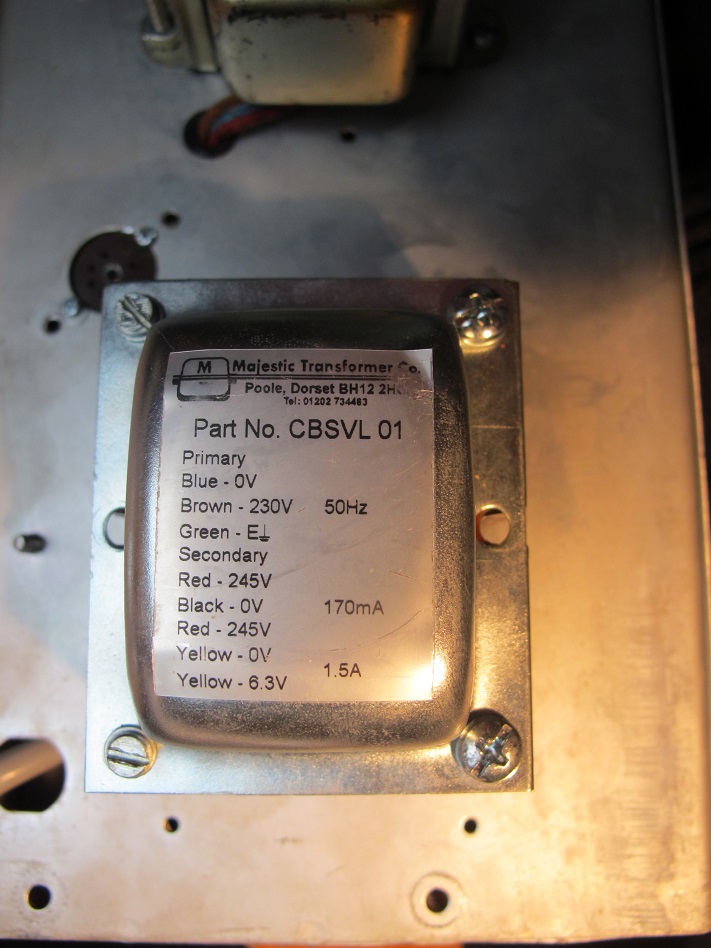

There is a new PT in this thing,I'll include a photo of the specs. Looks to be the same specs as stock but its much thicker [2x more layers] for better cooling?
Question #1:Is this a good,suitable PT for this amp?

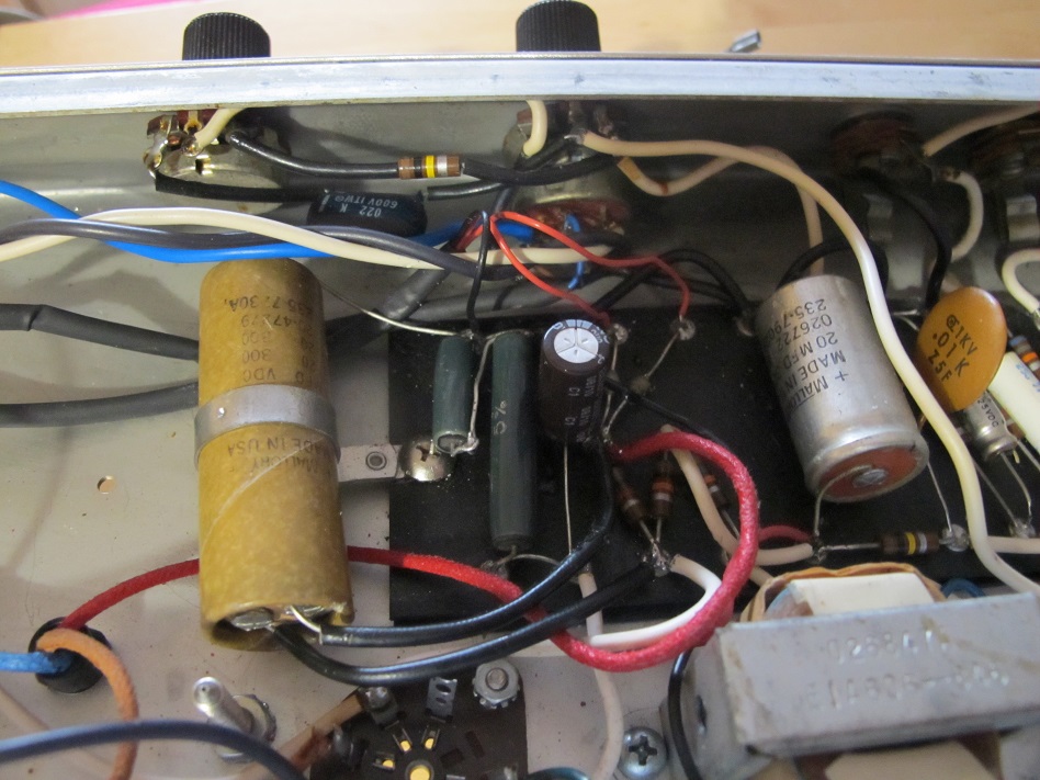

3- Question # 2 why has the 220ohm restistor been replaced with those green ones? The large one is 640ohm and it is in series with another one that is unmarked? This is not original and I have a 250ohm block type on hand to replace those, but I would like opinions first as maybe there is a reason that 640ohm was chosen with the new PT?

Ok, new fuse installed but I've encountered my first minor problem. I had to extend the wire from the fuse to the switch so I loosened the vol/tone assembly to get at it. Works great but now my switch doesnt click on and off, its just always on when I plug it in now. I guess I could live with this as the switch isnt a standby so the tubes get slammed anyway once you plug in,but it would be nice to get the 'click' on off back.

Someone changed the 220 ohms to something else in an attempt to bias the amp differently, either to accommodate a particular tube or to change tube types. The new PT may or may not be the cause of that adjustment.

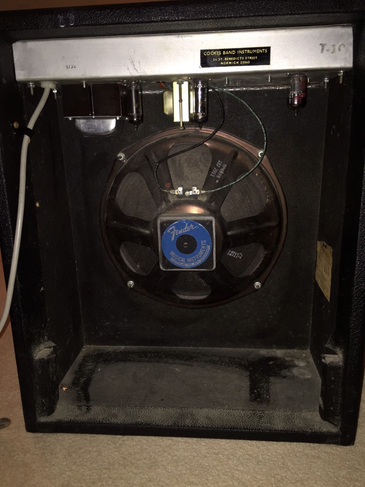

But those use 6V6. Yours has 6AQ5s??? Looking at your chassis I see the two power tube sockets are different sizes. The smaller one nearer the power transformer looks to have been mounted in a larger hole: note the empty mounting holes next to it, and the screws are notched into the edge of the chassis hole. The 6AQ5 is equivalent to the 6V6, but not identical. I would wager that someone rebuilt the original 6V6 amp into a 6AQ5 version. But I could be wrong. I myself have never seen a 6AQ5 version of this model, but that doesn't mean they don't exist.

Ok, I found the value of the second bias resistor,its 470ohm. So what is 470ohm + 680ohm in series? I'd like to replace it with one of the correct value.The seller included a repair receipt from the tech who installed the PT. It explains alot.Aparrantly what ever value this is has biased the tubes at 40ma.

Good news, I re-did the heater wires and it cut the noise in half at least already,so I feel positive about the new filter caps solving the rest. We will see!

The resistors are 680ohm + 470ohm in series, so a bit over 1k.

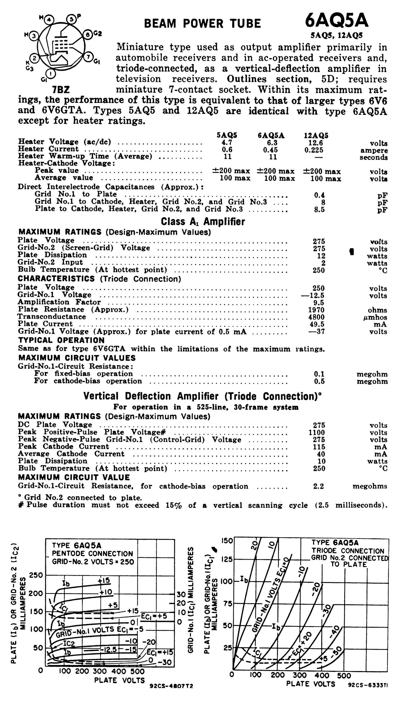

The data sheet for the 6AQ5 recommends these not exceed 250v.
If the new PT is designed for a 6v6 circuit then your power supply will exceed this and the tubes may have been biased cold to compensate - maybe 😕
