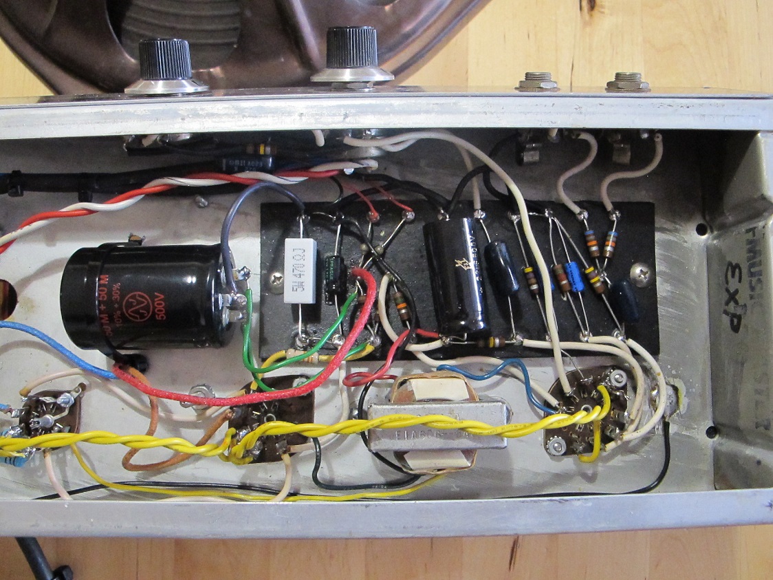

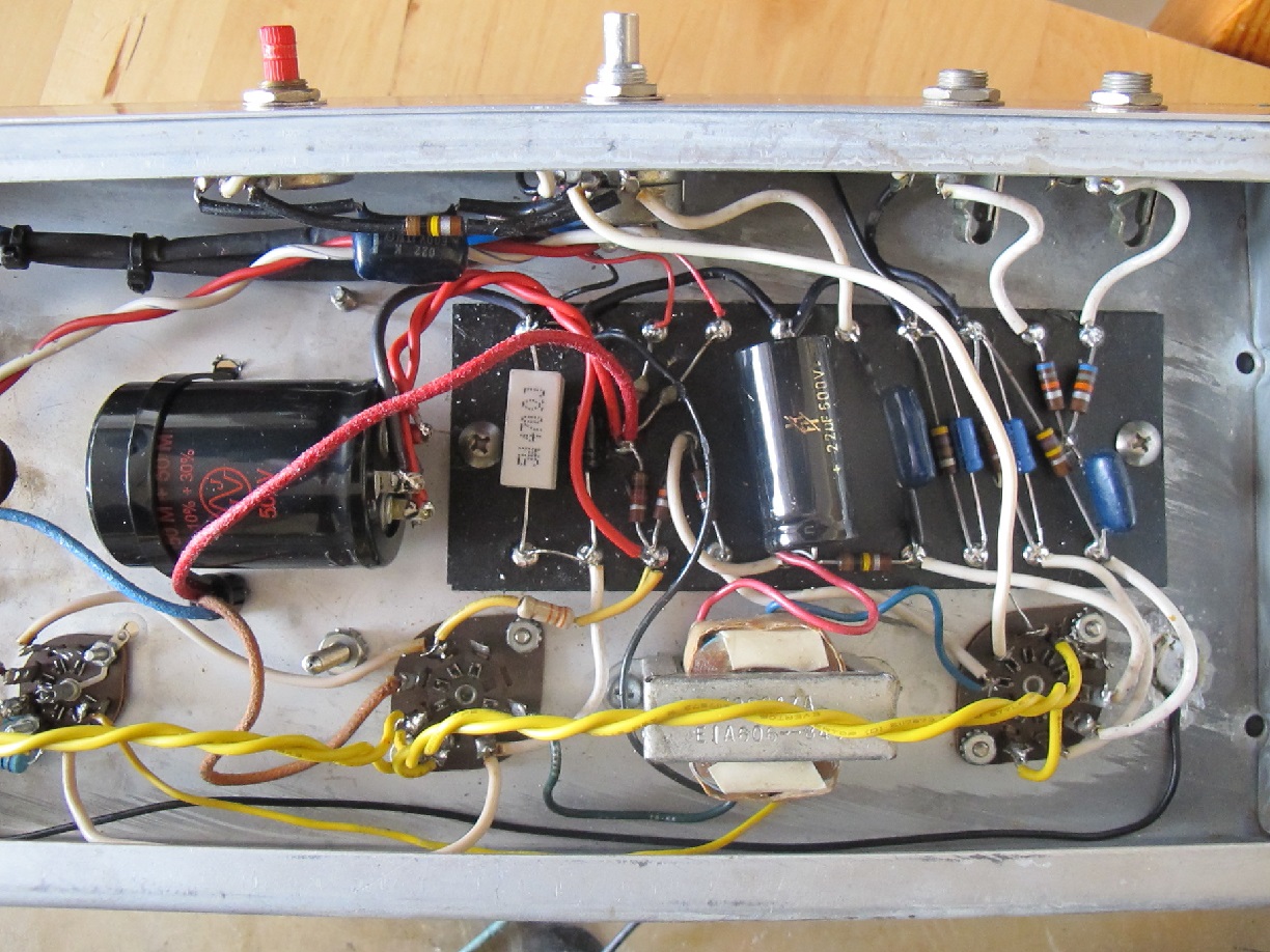

There are 2 ground connections in my amp. The volume/tone pots which ground all the board connections and the heater wire ground by the preamp tube. Of course the power plug is grounded to the chassis as well.
Regarding that wire in the wrong place-I guess I was assuming it shares a common ground on those 2 terminals? I'll swap it over today regardless!

It is a common ground, but with grounding we have to pay a lot of attention to where various currents flow. Even a short length of wire has some resistance and a 'dirty ground current' will create a buzzy voltage across that resistance. If that voltage then adds to a signal voltage (into a grid or a cathode) then we can get an audible buzz.
How is the ground connection to the vol. and tone pots made? I can't see it in the various photos.
That ground goes to lug 1 of the vol pot, then on to lug 2 of the tone pot. Giving this area the emery cloth/toothy washer treatment as we speak..
That seems OK, but where does it go from lug 1 to reach ground?
It goes to the base of the F&T board mounted filter cap.
Good news, After giving the pots the same treatment as the jacks its definately quieter.
Bad news, that wire was in the correct location [ground of the bias resistor] but in the photo it looked deceiving. It still buzzes a bit but we are getting there!
Actually, it may be fine as before the noise from turning up the tone pot was drowned out by the power supply buzz. Now it appears much louder so the PT buzz is way below that! Hard to tell with it out of the cab but Its a definate big improvement.

Next I'll move the two + wires to the dual cap. I'm going to redo that whole area cause those thin green solid core wires make me nervouse,dont want one breaking during a gig.😱
Its just hard to stuff a thicker wire in that one junction so I'll have to thoroughly de-solder that junction.

OK, good news. I think I would have put that ground return from the vol. pot to the base of the 10uF cap which is the cathode bypass for V1B, but it would probably not make much difference. (Can try it if you want.)
I'll give it a whirl! Thanks everybody for walking me through this!
Ok, moved that wire over to the 10uf and didn't hear much change. Its back in the cab now and maybe the vol pot is creating more noise now so I'll move it back next time I remove the chassis.
The power supply noise has been reduced probably 80% from when I received the amp. Probably cant reduce that much more and its probably just normal PS noise now. Very happy!
