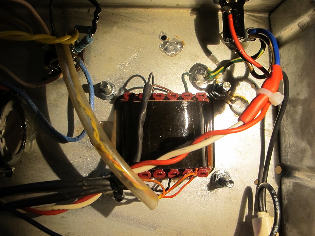

Don't forget to ground the metal part (cover etc.) of the transformer. Put a shake-proof washer and one of those 'washers with a tag to solder to' touching the metal of the transformer and run a short wire from there to any convenient point on the chassis. By the way, those aren't cooling fins. They are the transformer core laminations.
(It's a safety requirement and also it can only help to reduce hum and buzz.)
Well Malcolm, I always get excited when improvements are made, but when I put it all back in the cabinet its still humming too loudly through the speaker to be a gig amp miked in the house.:µphone: I'm at a loss now cause I've done everything I can short of replacing the PT, which it appears I'm going to have to do. It will cost more than half of what I paid for the amp so its back to the Roland JC120. :-(
If anybody has suggestions for an upgrade PT [must be QUIET!] then I'd be grateful for any advice. I'm getting outside of my technical ability here so I might have to go with a fender Princeton OR Deluxe PT where the wires are color coded the same as the layout diagram.

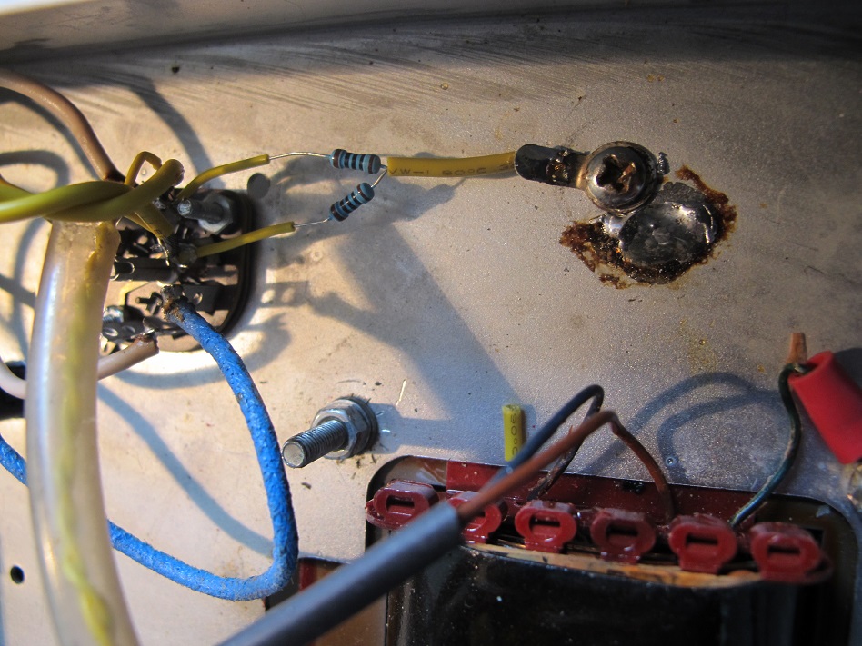

I believe its already grounded to the chassis inside on one of the mounting bolts [older photo before the heater center taps were installed on the cathode]

My hum is not affected by volume/tone adjustments. It's a low hum that comes on instantly when the amp is switched on and gradually gets louder for five seconds, kinda the same amount of time it takes the tubes to light up. I really thought it was the tubes, but tried 4 nos GE 6aq5's and that didnt change things.I've cleaned and re-tensioned the pins.If my pot cleaner is conductive,that would be a bummer. Can I use acetone on a q-tip to clean the tube sockets?
The PT has very thin wires, unlike any fender unit I've ever seen. Could that be the issue or did the tech who installed it screw something up with the wiring? He's the guy that put the 1meg resistor inline with the pilot lite I presume. Again, I'm not well versed on transformer wiring so this may be out of my reach and over my head...😱

I was thinking you had something like this (in order):
bolt head, metal washer, nylon washer, transform cover, transformer laminations, nylon washer, chassis, grounding tag, nut.
If it is like that, there is no electrical contact between the transformer metalwork and the chassis (or the grounding tag) except for possible accidental contact with the threaded part of the bolt.

Its like this-
bolt screw head-nylon washer-transformer metal cover-laminations-rubber washers-chassis. Inside the chassis the nuts are all contacting the chassis.

No, that’s no good, as the metal parts of the transformer are electrically insulated from ground at present.
It’s a safety issue, because if there was fault inside the transformer, the metal parts could become live and they are easily touched by the user. By grounding them, the fault would cause a fuse to blow instead.
What you need is something like:
Bolt head, shake-proof metal washer, metal cover, laminations, nylon washer, chassis, nylon washer, metal washer, grounding tag, shake-proof washer, nut.
Shake-proof washers give a ‘bite’ into the metal ensuring a good electrical contact.
Malcom, I went ahead and decided to mount this thing properly....😱
Went out and bought the fattest bolts that would fit, properly sized star washers and nylon washers. Removed the old ground lug and all the old solder from the chassis,then cleaned and scuffed the ground area on the chassis.Added a new ground lug for the mains and transformer ground,then bolted it down TIGHT and evenly with the suggested washer pattern.
Finally,soldered the ground lug with a 300w iron to the chassis.
Guess what? NOW IT IS SILENT...no...REALLY!
There was a bad ground connection,probably the old solder lug. Honestly,its quieter than all my other amps! [JC120/Roland Bolt 30,Fender champion 600.]
