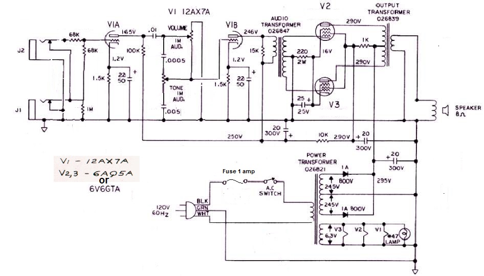

I thought I would share a revised schematic from a respected amp builder who knows his way around these MMB amps [Winfield Amps].
He drew up a schematic for me with changes to the front end for reducing V1 noise and using fender 'blackface' values on VI.

^ That was the stock values , heres the revised schematic...
I'm going to try these values and shield the input wires as well as the long V1 to Vol pot wire. The tone control gets a bit hissy so this might help in that area.

On the bias calculator with my 470ohm resistor the plate dissipation percentage is 119.4%. Shouldnt I try to get that under 100%? With the 680 ohm the plate dissipation percentage is 97.1%. That looks better to me but is it ok to exceed this percentage?

Big success today regarding PT hum. The transformer itself wasn't tightened down very firmly and was vibrating. Tightening the 4 mounting bolts really quieted this thing down.
Second success, removed the 1meg resistor from the pilot light and its nice and bright and when the amp is turned off its also completely off. Cant figure out why that resistor was there at all?
I swapped the 470ohm cathode resistor for a 330ohm and got 9.3 watts and 77.7% dissipation.

Hum? To start with
- Bigger smoothing caps than 20-22u. (There is no magic in the stock specs)
- A 100R resistor on each leg of the heater supply with the other end(s) attached either to ground or the output tube cathodes. (Reduces heater hum like magic 😀 )

One more question, currently Ive got the 2 heater 100ohm resistors going to ground. Would it be an improvement if they went to pin 2 [cathode] of one of the 6AQ5's? And if I were to try this, does the original chassis ground from the 12ax7 go back to its stock location?
The reason I ask is I still have a bit of hum [too much for recording] but live its not a problem. [just irritates our sound man] lol. Its a good 80% quieter than when I got it and its a great gig amp.
The idea is to reference the heater artificial centre tap to a higher DC level than ground, which can reduce hum transfer from heaters to cathodes.
You just disconnect the junction point of the two 100ohm resistors from ground and re-connect that junction point to the power tube cathode.
Don't reconnect the 12ax7 back to ground.
Outstanding! The cathode method removed ALL the noise from the tone control! It didnt affect the PT hum but made the tone pot silent.BIG IMPROVEMENT! For some reason they used an audio taper for the tone pot and it bunches up at the end. Next to change that to a linear CTS pot.
