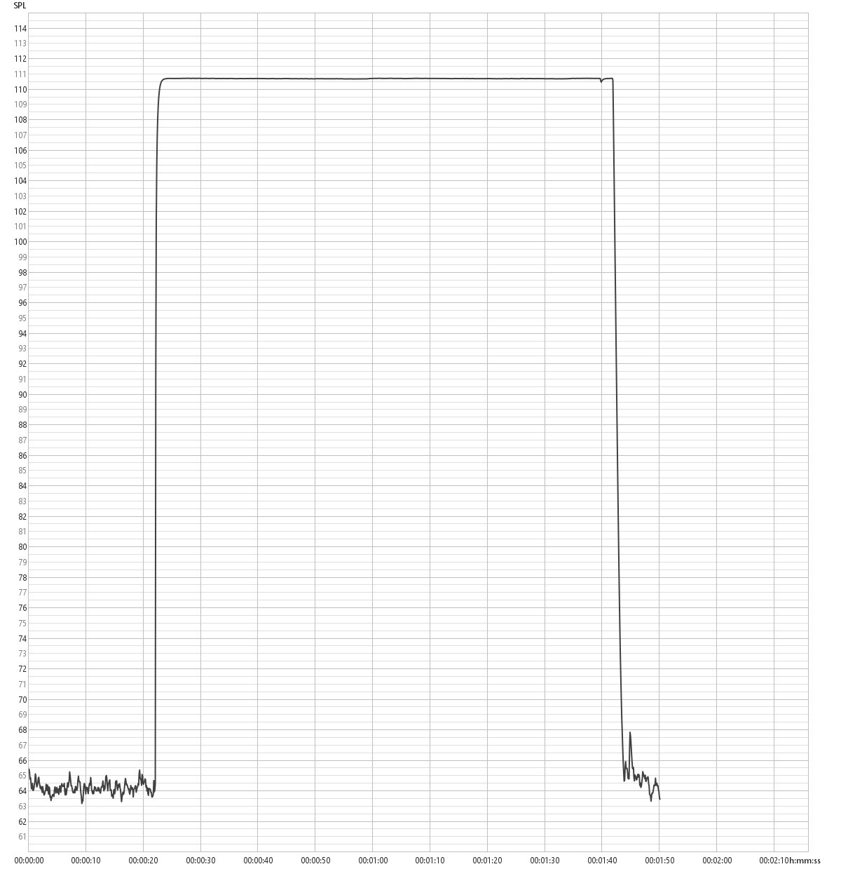

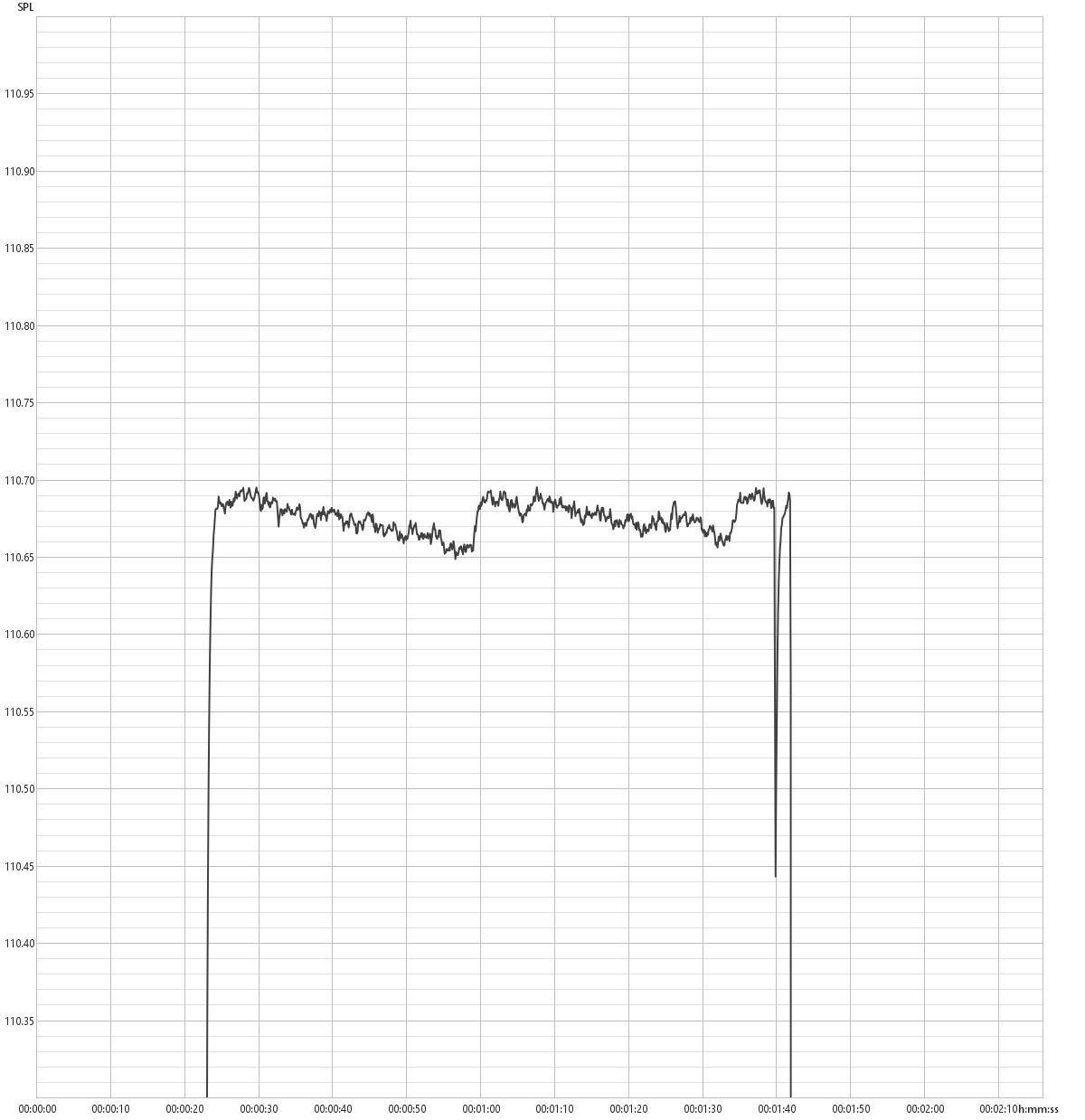

A 50 V peak-peak, 0.05 Hz ripple on a 5250 V high voltage supply should make the volume go up and down by a bit less than 1 %, or 0.08 dB, every 20 seconds.
You might be right.

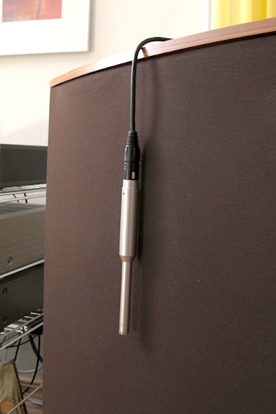

I fed one of my Quad 63 with a sine of 1.5kHz. In order to enhance the S/N ratio of the measurement, I added some matching DSP peak filtering set at 1.5kHz at the mic's input. While measuring, the neon bulb was flashing at a rate of every 33 seconds plus/minus. The -0.25dB notch at 00:01:40 is an erratic soundcard output signal artefact.
Impressive measurement confirmation of a subtle effect! Thanks for Sharing

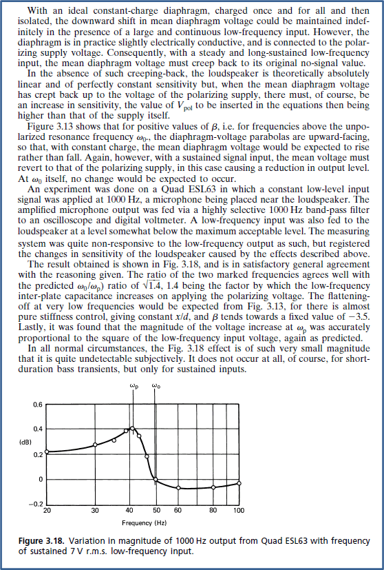

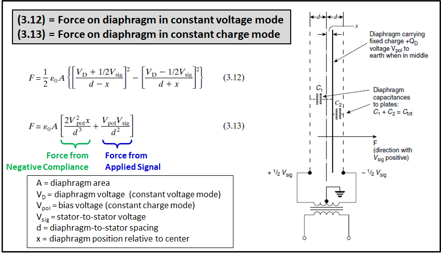

Another less known fact is that sustained LF tones near the diaphragm resonance frequency will increase the sensitivity of the ESL by a measurable amount.
From the Baxandall ESL chapter a plot shows roughly 0.4dB increase from 7Vrms input.
Text mentions that the sensitivity increase effect is proportional to the square of the LF tone magnitude.
Reference:
P. J. Baxandall, “Electrostatic Loudspeakers,” Chapter 3 in Loudspeaker and Headphone Handbook, J. Borwick, Ed.
(Reed Educational and Professional Pub., Woburn, MA,
1998), pp. 106–195.

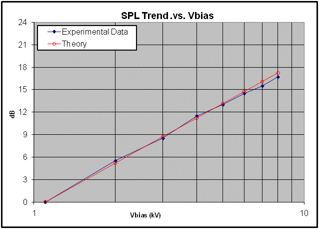

...How much does the bias have to change for a 1dB sensitivity change, is it a linear law (1dB being ~12%)?
Yes it is a linear law. Looking at the Force Equation above(from Baxandal ESL chapter), the sensitivity is directly proportional to the bias voltage and applied signal voltage.
So dB(Change) = 20*LOG[ Vbias(new) / Vbias(reference) ]…as you say changing the bias voltage by ~12% produces a 1dB change.
A plot comparing measurement and theory for bias voltage change from an old thread:
https://www.diyaudio.com/community/...nance-change-with-hv-bias.147801/post-2378013
Note the other term in the Force equation is the negative compliance or stiffness which is proportional to the square of the bias voltage.
Quad designed the ESL63 panels such that the mechanical tension is roughly 3.5x larger than the negative stiffness.
Running thru the math for the ESL63 and a ~12% change in the 5.25kV bias voltage, the diaphragm resonance frequency will change about 5%.
Increasing bias voltage results in resonance frequency decreasing.

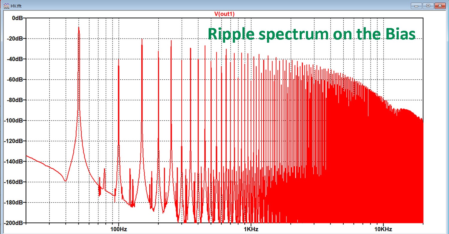

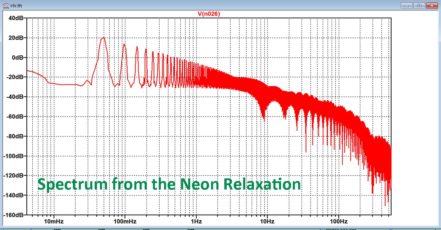

To get a feeling about what we are talking about, good old LTSpice can give us more insight.
The Neon relaxation will give a contribution in the audio range that's indeed below the 50Hz induced ripple on the bias, see below.
I'm surprised how slow the decay of al the harmonics on the Bias is, so Demian might be right that a tightly regulated Bias voltage may be produce a cleaner sound.
Sorry Demian for not having believed this as being a possible improvement.
Hans

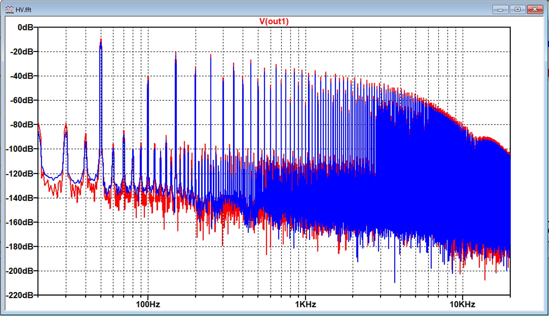

Please keep in mind that your simulation doesn't include the frequency conversion that you get due to the multiplication with the desired signal, nor the filtering due to the distributed resistance and capacitance of the diaphragm.
I simulated the bias ripple spectrum and not the signal's AM modulation due to multiplication, but it's obvious that the wider the spectrum the farther the modulated sidebands are from the audio signal and the more likely it becomes that it can be perceived.
But including the capacity that the diaphragm is facing is a good idea.
See simulation below.
When loading the bias with a 2nF cap, difference is only a few dB's.
Hans
