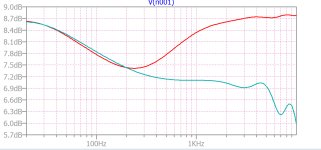

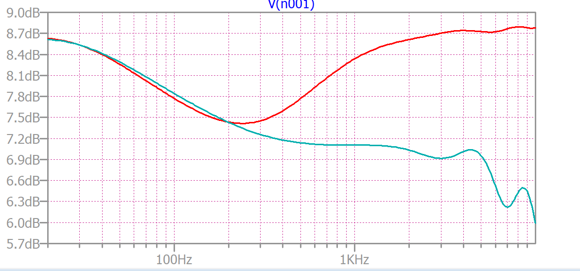

A follow up question: I looked at the 1.5R//220uF at the primary.
I wonder what the purpose is, is it a measure of protection for the driving amplifier, to avoid too low impedance at the LF end,
or is it to correct the speaker response?
That response gets much flatter if the R is deleted (and also the elcap of course)
I do my correction with Acourate and would like to get rid of that electrolytic if feasible.
RED with 220u // 1.5, TEAL with 1nF // 1.5
Edit: Hans, there's a 1.5uF cap across the two primaries in your sim, what does that represent?

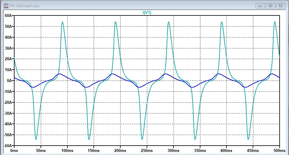

Jan, the 1.5R resistor should limit the current through the transformers at LF that could cause the transformers go into saturation.
When you simulate the model, you will notice this.
The 1.5uF across the transformers that Quad inserted is to correct the impedance at HF.
Hans

See what the current does without the 1,5R when putting a 10Hz signal on the transformers, clearly showing the saturation.
Hans

Thanks Hans, that's clear!
I think I will leave it out as I plan to cross over at about 200Hz not using the bass panels.

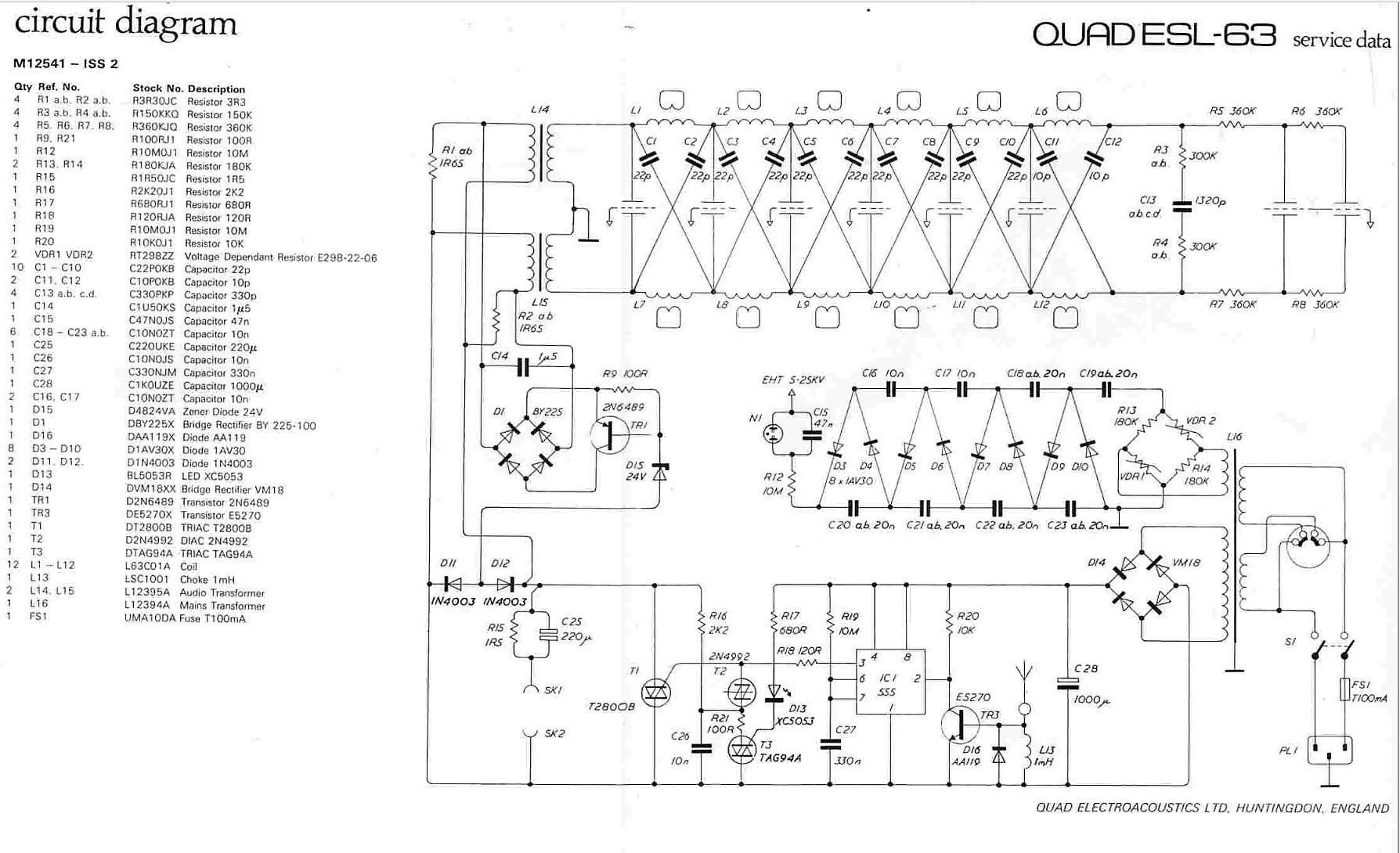

I don't see that 1.5u at the QUAD factory drawing from '89. Was that added at a later time?
Jan
Jan
In '89 it was definitely there, I think it was always there, but not all circuit diagrams are complete.

Jan,
I forgot to mention in #603 that the blue line represents the transformer current for a low level 10Hz signal, already showing its non linearity at this frequency and that the teal curve is the current for a higher amplitude 10Hz input signal, suddenly showing these huge current peaks.
Hans
Hans
That was clear Hans. I didn't have this diagram, thanks for posting it.

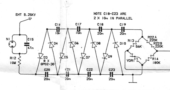

BTW, I initially thought that 'C21 ab 20n' stood for 'about 20n'.
Now I know it's two parallel caps, C21a and b together being 20n.
Funny guy, Peter Walker 😎

Jan,
Looking in the partlist I see 6 pieces of 10nF capacitors for C18 to C23.
So to my belief he used 20nF caps in series to get this 10nF.
I may be wrong, but 10nF is the value I used in my simulation.
Hans
Hans

Very confusing, in my (an official QUAD) schematic there are some 10nF that are in parallel to get 20nF.Jan,
Hans

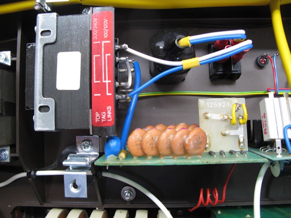

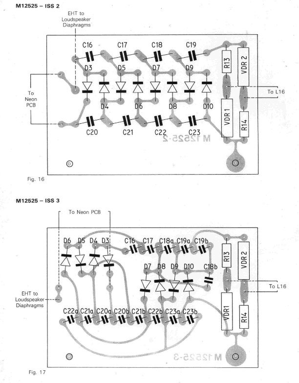

Two revisions of the HT Board from the Quad63 service manual: On ISS 2 caps are single, on ISS 3 twin caps are parallalled:
Mine, SN 023810 and 023809, have single caps:
In the board I have there are a grand total of 14 caps, each 10nF/2kV, and several are in parallel to form the 20nF caps showed in the circuit in post # 611.
So that appears to jive with reality, both value and number of caps.

My board looks exactly like the lower, Fig 17.
Jan
Ghirlande ghirlande ... The layout of C-parallelization in Fig. 17 does neatly match your former statement about P.Walker ... assuming he was the designer of this board also. I think he must have been a really creative out-of-the-box thinker and enjoying amusing himself while designing.
