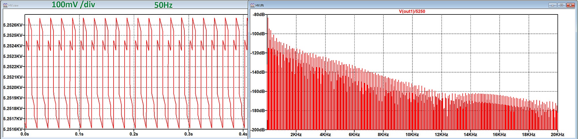

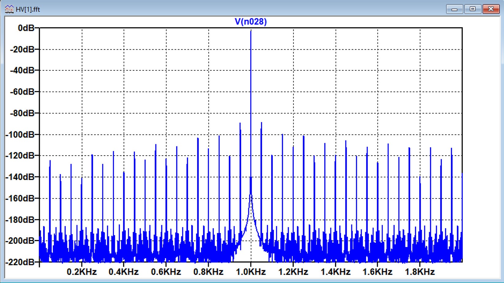

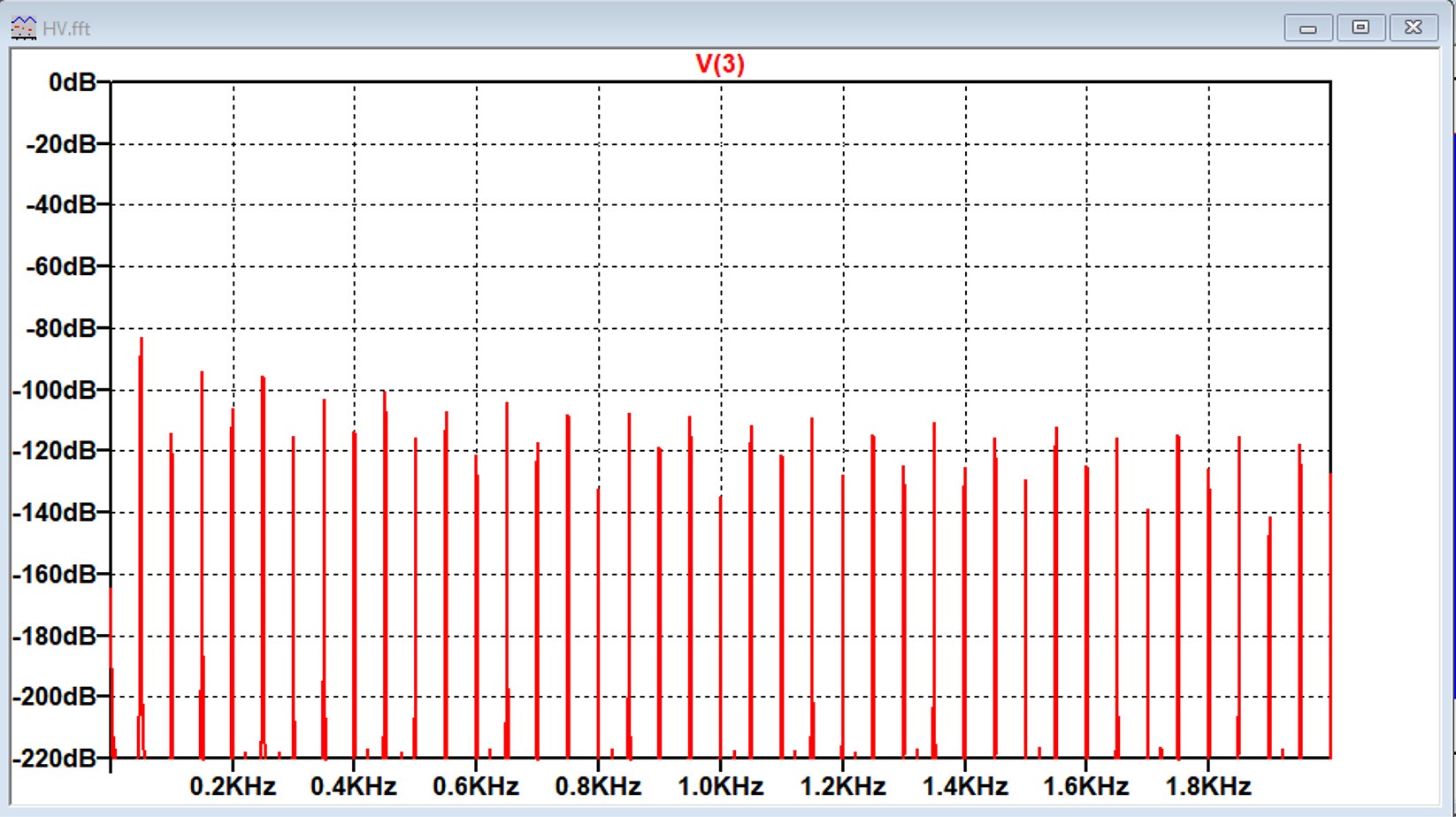

Here is the simulation I promised.
First image is the ripple's spectrum on the Bias voltage, for clarity from 0Hz to 2KHz on a linear scale and divided by 5000.
Second image is a 1Khz signal AM modulated by the (Bias Ripple)/5000.
You can see that the spectrum of the first image is mirrored on both sides of the 1Khz signal because of AM modulation.
This modulation in effect happens to all frequencies in the audio signal.
Can this be improved: yes certainly.
Does it lead to an improvement in sound perception: I can't say, but according to Demian it makes a big difference.

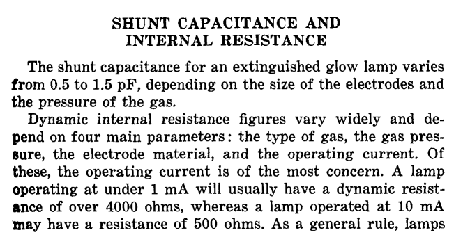

Jan,There's 47n // to the neon which will have to be discharged.
Do we know the dynamic impedance of an ignited neon?
Edit: it depends on current, it takes time for that cap to discharge and the 'step' in bias is not abrubt.
Hans do you have a sim model for that neon lamp?
Jan
look at the sim where the neon bulb is visible, simulated as a switch closing at 100V and opening at 50V.
A NE-2 neon bulb draws between 100uA and 10mA, so a value of 1mA in the middle seems reasonable.
Tripping at 100Volt, that means a 100Kohm resistance.
In fact a neon bulb has a negative resistance, so the 100K is on the mild side.
In combination with the 47nF this gives roughly a discharge time from 100V to 50V of ca. 3msec.
Hans

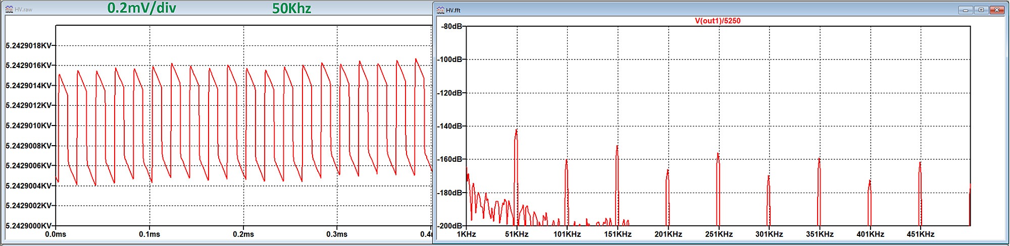

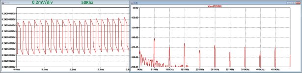

To get a better feeling to what a higher input frequency does for feeding the Bias Generator, I simulated both 50Hz and 50Khz.
Quite obvious for every frequency increase by a factor 10, the time signal and spectrum both drop by 20dB.
So a factor 1000 show's a time signal and spectrum that's 60dB lower, apart from the fact that 50Khz is completely outside the audio spectrum.
The left side of the two images shows the signal versus time, while at the right it's corresponding spectrum is visible.
The time signal changes it's shape at 50Khz, but the spectrum still looks very much like at 50Hz.
It seems like an interesting modification that Braun performed for the LE1.
Hans
