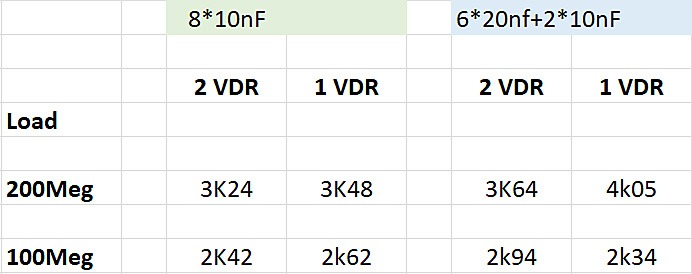

Hans, it seems that some of the caps are actually 20nF.Jan,
Looking in the partlist I see 6 pieces of 10nF capacitors for C18 to C23.
So to my belief he used 20nF caps in series to get this 10nF.
I may be wrong, but 10nF is the value I used in my simulation.
Hans
Does that change your sim results as far as 100M loaded output is concerned?
Jan

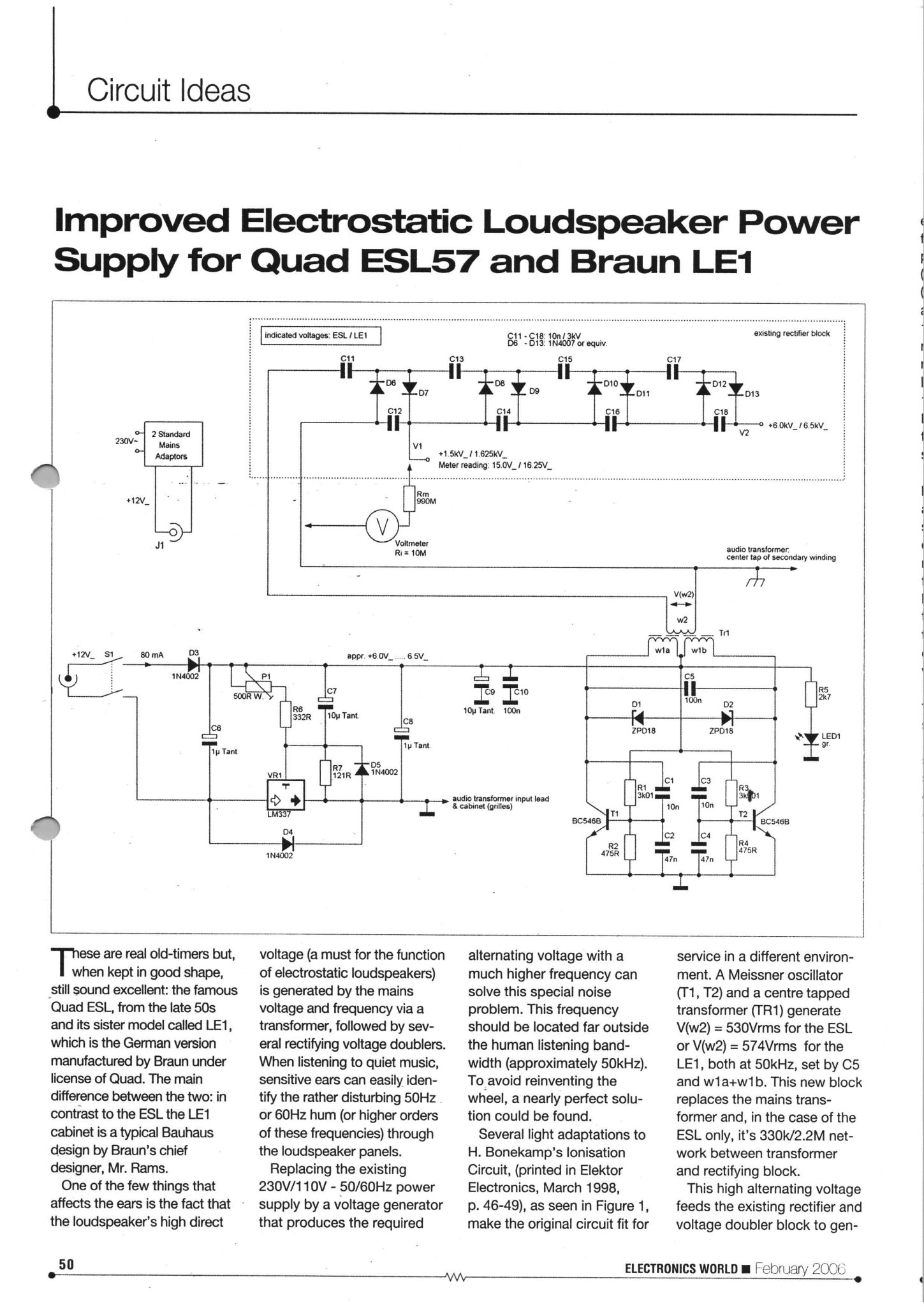

I have several electrostatic voltmeters. For this stuff there are NO substitutes. However the Classic HV probe for a CRT HV is close at typically 1000 Megs. At least you will be in 10-20% of the voltage and can validate the HV supplies function. I have seen enough in this discussion to validate the electronic supply + 100M to each panel we did 30 years ago.
I have a couple of vintage Telefunken 5kV HV meters which I used in the development of the direct drive amp, but they draw up to 50uA.
I contacted several eBay sellers that offer reasonably priced and undamaged electrostatic voltmeters, but none have the matching probe available.

I just noticed that I already used 20nF caps for all 8 eight capacitors in my sims, see #576.
This resulted in the 1.1Volt pk-pk on the bias.
Going to six 20nF and two 10nF as in #612 and like Jan reported, did not change a bit to the 1.1Volt ripple.
But making all caps 10nF, doubled the ripple to 2.2Volt.
The two versions with resp. one and two VDR's have different output impedances, and also having 8*10nF or 6*20nF+2*10nF makes a difference, as shown in the Bias voltage table below for two different loads, all versions starting with 5K25 with just the diaphragm's load.
So, the best performing version is with one VDR and 6*20nF+2*10nF.
Hans
