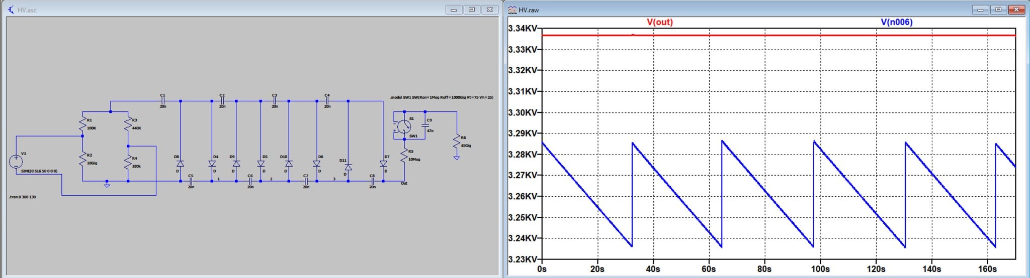

The cap to be discharged by the Neon NE-2 bulb is 47nF.
The 5nF that I used was a factor 10 off, so the leakage resistance is 45GOhm to get a 20 sec relaxation time.

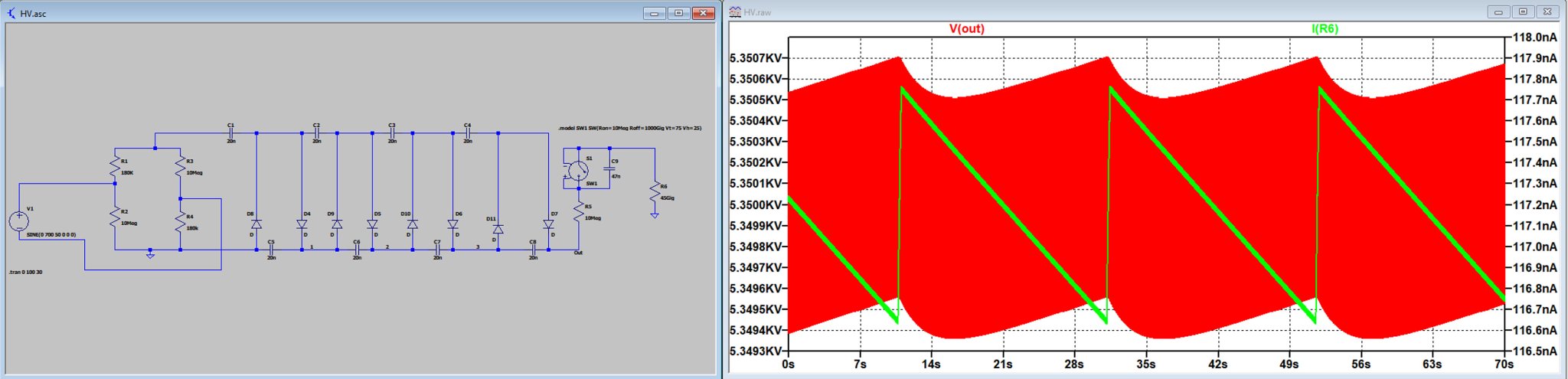

To make the picture complete, I ran a sim of the whole circuit.
Instead of a neon bulb a switch was used, closing a 100Volt, thereby discharging the 47nF cap, and opening again at 50Volt to let the 47nF cap charge again to 100Volt.
What is shown in the first image is the HV voltage in red, with a 50Hz band.
The green signal shows the current flowing into the ESL's diaphragm.
Since the current is practically constant, the HV voltage stays within a band < 1.5 Volt with a 100Hz ripple.

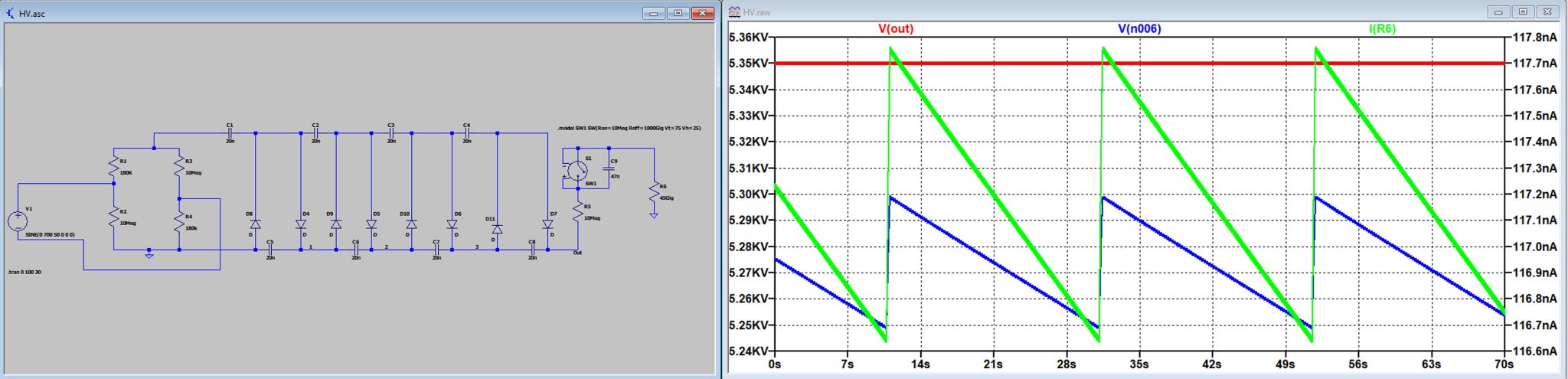

The second image shows the same, but now the voltage on the ELS's diaphragm is also visible in blue, having a sawtooth ripple of 50 Volt.
Hans

The 1.5V ripple is before the neon bulb.
The Diapragm is confronted with a 50 V sawtooth.
But you cannot simply translate that into a sideband calculation without knowing the transfer function.
The voltage applied to the diaphragm must be seen as a CM signal whereas the plates are working in DM.
CM suppression is very good, but has its limits because of (mechanical) imperfections.
But sensitivity is affected by a changing bias voltage and this amplitude modulation causes sidebands.
See image in #539 where amost reducing the Bias voltage by a factor two, results in a loss of sensitivity of 1.7 dB.
Quad would never have inserted this diagnostic neon bulb in the bias line, when it would have resulted in a perceivable sound detoriation.
But you can take the proof of the pudding, shorten the neon bulb and listen to the difference in sound, if any.
In that case the diaphragm will only see 1 Volt ripple instead of the 50V sawtooth.
Hans

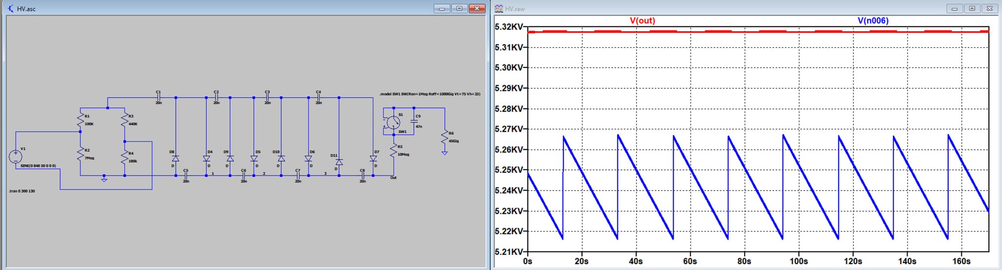

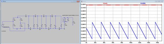

Marcel,
The transformer is producing 600Vrms and the VDR is a S10K460 that clamps at 460Volt.
Taking the latest version of the Bias generating circuit in the sim below, with 600Vrms input, Bias voltage becomes 5.32KV.
Any higher and the VDR will start clamping.
Lowering the 225Volt to 140Volt will result in a bias voltage of 3.36KV or 4.0dB less Bias voltage.
This resulted in 1.7dB less sensitivity, not 4.0 dB.
Hans

Rather elementary physics show that the sound pressure level should be directly proportional to the polarization voltage of the diaphragm, so there must be something going wrong somewhere.
There are several revisions of the ESL 63 electronics. Is the version you simulated the same as in the ESL 63 of which you measured the level?
How did you model the VDR or the two VDRs? There only appear to be linear resistors in your schematics.
I used a resistor, but I could also have inserted a Zener of 460Volt.
As I mentioned I simulated the latest version of the Bias generator having only one VDR.
The resistor respresenting the VDR in this case was set at a very high resistance value.
And at 600Vrms, the voltage on the VDR is indeed +/-460V peak, anything higher will be clamped.
So at 140V input , the VDR it is not conducting at all and bias voltage will drop by 4dB.
The acoustic measurements I did, may be +/- 0.1dB off, but certainly not the 2.3dB difference between 1.7dB and 4.0dB we see here.
Hans
