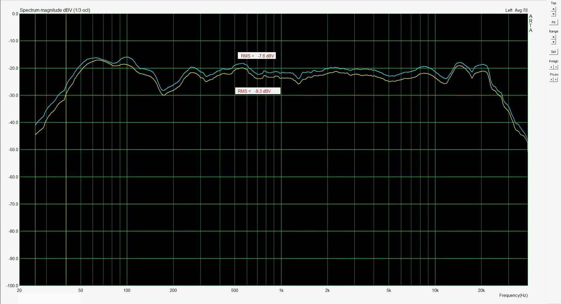

The load is in the hundreds of MOhms and the four 20nF caps are in series 5nF supporting the Bias voltage.
Lets say for simplicity, Vbias is 5000Volt, resulting in a current of 5000V/100e6Ohm= 50uA.
While I=C*dU/dT and dT 20msec for 50Hz, the ripple dU becomes I*dt/C = 50e-6A*20e-3Sec/5nF = 200Volt
Apart from the influence on the max output level, that will be affected by the magnitude of the bias voltage, the speakers efficiency will also drop.
See attachment for a mains supply of resp 225V and 140Volt that translates directly proportional to the HV Bias Voltage
FR will not be affected but output drops slightly.
So the above calculated 200V ripple on 5000 volt will have no effect IMO.
Hans
P.S. the curves in the image are not simulated but acoustically measured.
