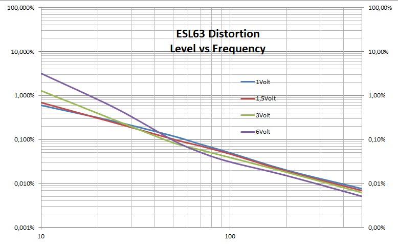

In the slides I posted there is also a THD comparison. The step-up gives about 35dB more THD than the DD. That is most likely from the step-up xformer as the used amps (my own paX and a Purify) have much better performance on a 'normal' speaker load.
You can make the point that the difference between -76dB THD and -110dB THD may not be audible.
Yet, in listening sessions at the ETF, I always got the same response, that details in the DD were much better.
Independently from each other, listeners mentioned the 'bouche' with blowed instruments being much better.
Not double blind or anything, and maybe they just wanted to be nice to me, but the similarity of comments was striking.
Jan

I have attached distortion measurements from a Danish magazine where they inserted a 1R resistor in series with the ESL and measured the distortion caused by the nonlinear load presented by the transformer. Measurements are with rumble filter and voltages shown are peak voltages.
Also, my own measurements, the second attachment, now without rumble filter and with rms voltages, come to the same ca. -84dB@500Hz distortion, independent of level when driven from a very low distortion Amp such as yours.
Extrapolating the 6dB/oct distortion line to 1Khz would result in -90dB THD@1Khz. So, -76dB@1Khz distortion at the secondary side seems to be a good result.
Also quite revealing with these distortion measurements is that they are predominantly 3rd harmonic.
And yes, uneven harmonics can cause nasty auditory side effects, but I doubt whether anybody can hear this level of 3rd Harm distortion, but I may be wrong.
Take also into account that the ESL is adding extra distortion
Analyzing a .Wav file recorded at the same at 1KHz with DD and trafo driven could answer that question how distortion compares between the two.
I think you did a magnificent job, just being curious how this translates into acoustic measurements.
Hans
P.S. the PDF from the Danish magazine was too big to attach but was practically identical to my measurement.
