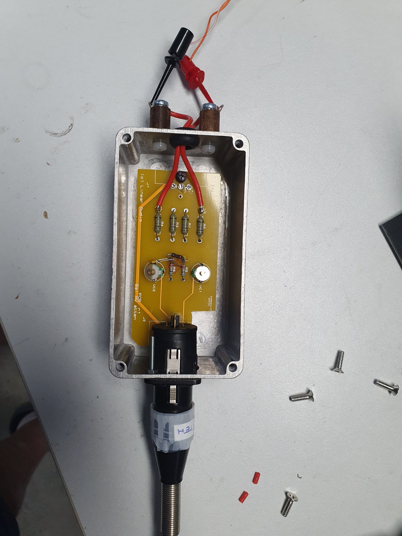

A bit late, but this is the freq response of the 60dB HV balanced attenuator, 100Meg differential impedance, courtesy Demian.
On the 2 x 50k attenuation leg, I need about 2 x 250pF to equalize the response which means I have about 0.5pF in parallel of the 100Meg.
I think that is low enough to not load down the test point on the amp.

The board in this metal box should have a distance of minimum 5cm to be able to handle 5kV, so should any wiring incl. The resistors ( dubble that for the differential signals). Therefore the size of the resistors alone is a problem here. Also the voltage coefficent needs to be checked if you like to have usefull measurement results.
Its very difficult to build something like this from scratch. Accuracy is an even bigger challenge. The mockup I sent seemed pretty accurate to 3 KV. I would not expect absolute accuracy without some fiddling. HV dividers can get quite complex. In any case I don't think the goal here is .1% accuracy, more of waveform monitoring and significant distortion identification.
These are more accurate with a substantial cost: http://www.ohm-labs.com/high-voltage-dividers/kvvb-compact-divider.html There are other, even more scifi, version at their site.
Or a pair of these: https://www.tek.com/en/high-voltage-probe-manual/p6015a again a lot of $$$.

O.k. Thx for your comment.Its very difficult to build something like this from scratch. Accuracy is an even bigger challenge. The mockup I sent seemed pretty accurate to 3 KV. I would not expect absolute accuracy without some fiddling. HV dividers can get quite complex. In any case I don't think the goal here is .1% accuracy, more of waveform monitoring and significant distortion identification.
