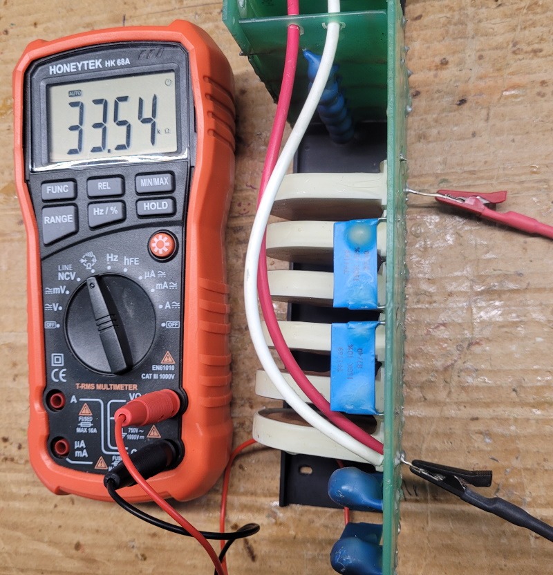

One hour of work, and the coil board was taken out, checked, and reinserted - problem still persists. Another listening test with a signal generator indicates it is the panel on the top of the speaker,....
See attached picture, I checked the DC resistance of all coils in series (only one half shown) and tried to see if rattling them would cause a change, but nothing happened. All coils measured 3.1 ... 3.2H (measured with a PEAK LCR meter at 1kHz).
So, as ESL63 and others said, its the panels, not the coils. Thanks a lot anyway for the help!
I'm away till Sunday, I will measure the resistance of a coil when I get home to see if it is similar to your 33k.
Jan
Jan
each coil has ~5k, this is the six coils in series - I just thought it would be easier to measure all of them at the same time while moving things around 😀
