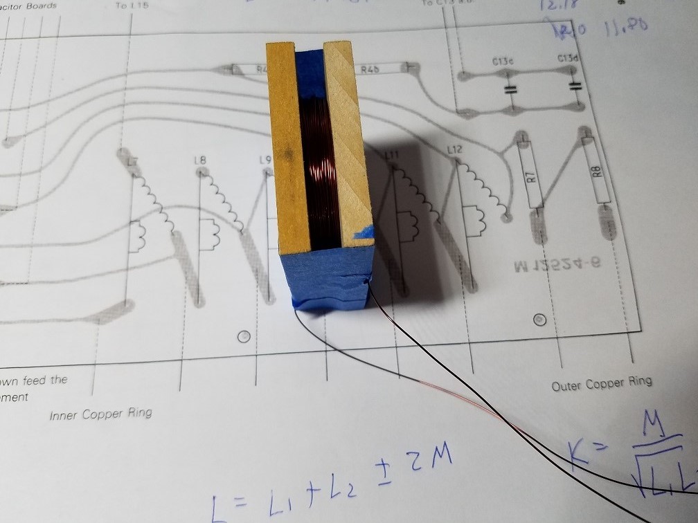

… I plan to wind up some inductors this weekend that more closely match the winding geometry(ie starting from near zero radius) and see if I can get a better estimate of the coupling factors to use.
Here is the version when cross-coupling the inductors with K=0.3 for the adjacent and K=0.1 for those one place further.
I did finally get the time to wind up some inductors more similar to the size and proportions of the actual delay-line inductors.
The new measurements show that the original estimate was not too far off.
New coupling factor estimates are:
K=0.25 (adjacent inductors)
K=0.05 (inductors one place further down the line)
Hi Steve,
Great to have these values confirmed.
I've adjusted the model to these two values, but as expected, it makes very little difference.
Even making the second coupling factor K=0 does very little.
But nonetheless, your figures are exact and the model is updated.

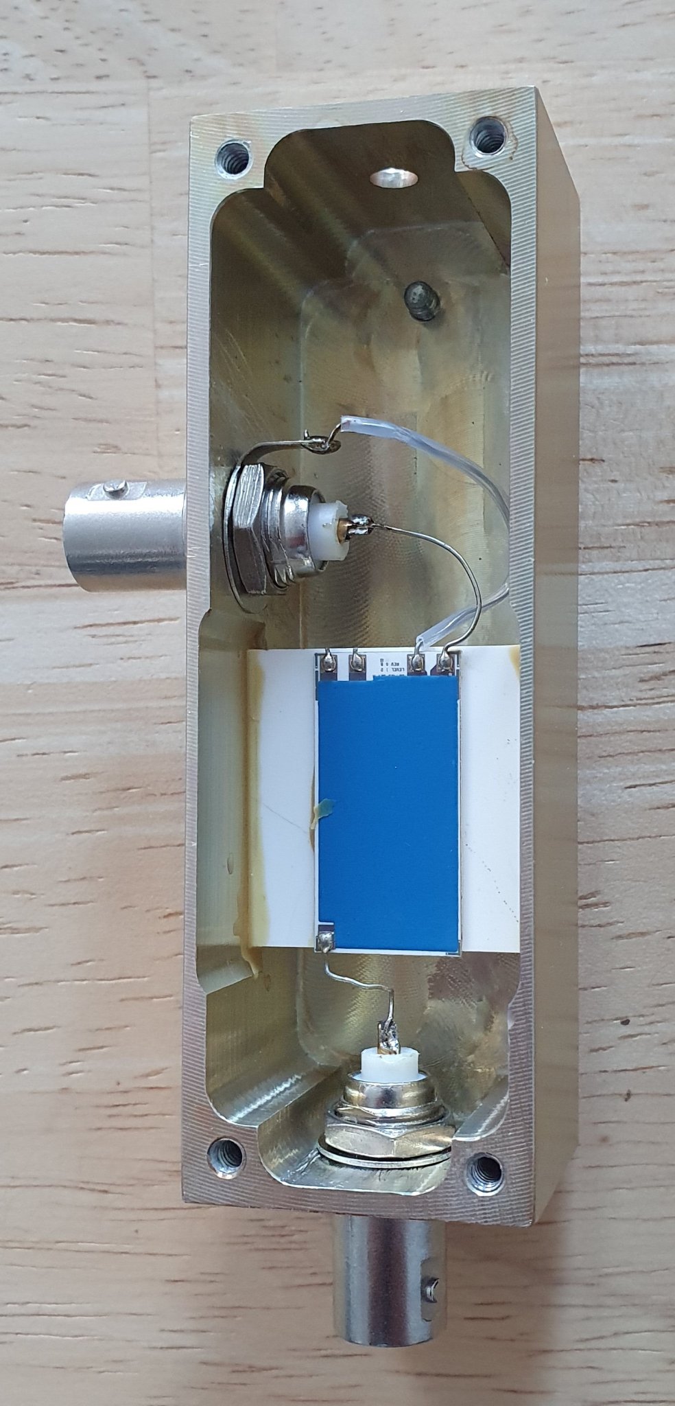

I have a pair of very high quality and very accurate 1:1000 attenuators, see pic, they come from a high voltage calibrator. I hung one on each transformer output, and the two 1:1000 atennuated outputs go to the balanced input of the AP analyzer. I measured the freq response and saw a large drop from about 10k (this is with a single ESL 63). Is that something I should have expected?
I did separately measure the amplifier and attenuation path and these are pretty flat, so it really is the speaker.
What I am not sure about is whether a 1M load on the transformer would skew the result.
Edit: it does match reasonably with what I measured last year in post 345 so I guess I'm doing it OK with the precision attenuators.
Comments invited!

Do you have details on the attenuators? Series R and shunt C? Have you been able to check them? Both input Z and attenuation could affect them. If you were on this side of the pond I would lend you a pair of P6013 HV probes. Accurate nonobtrusive measurements of high voltages are simply hard to do. However you can confirm the effect of connecting them acoustically.
Also the BNC connector is only good to 500V RMS. There is a special variant https://www.amphenolrf.com/000-27000.html rated to 3500V. I first encountered it in adapters for by AC calibration stuff.
Are you using a single amp for the speaker or multiples? Given a clean sheet, I would be using one amp per "ring" and drive them with DSP so I can fully tune them.
AX tech editor
Joined 2002
The attenuators are from some Fluke 5215A calibartion amps where they are used up to 1100V @ 100kHz. Impedance is 1M/1k.
They don't have the BNC's shown in the pics, the originals have a half inch teflon clad pin sticking out, a pair is mounted in a small enclosure with an XLR as output. I have several of them, the one in the pic are for 'normal' low voltage use.
I'm using one amp per stator, two in a monobloc setup. It's important to place the amp close to the speaker, it's easy to lose half the drive current into the capacitances of the connecting cables! I have a set of cables with the HV BNCs but they have too much capacitance to be of use for this, I'm brewing my own.

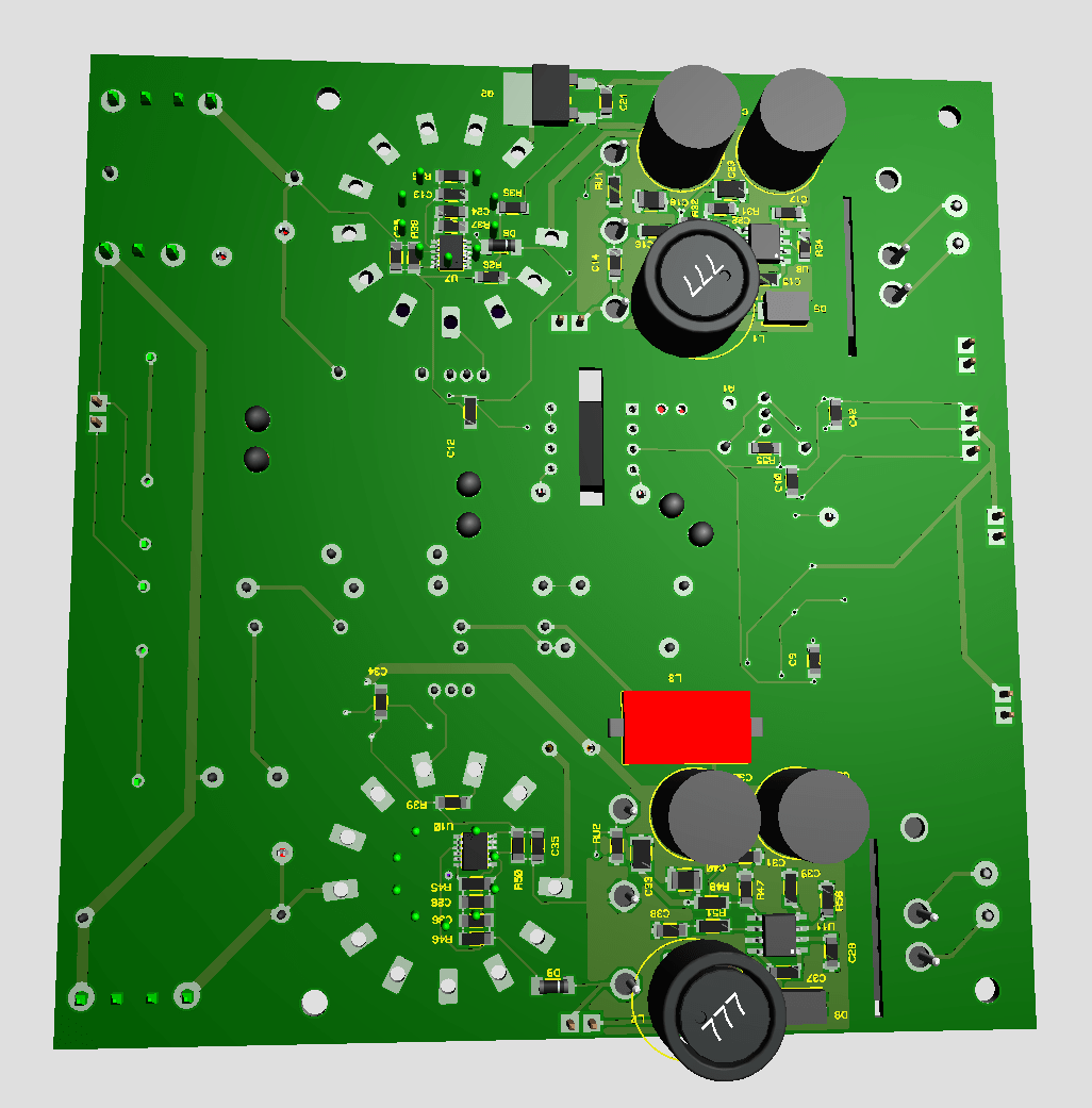

BTW Here's the PCB bottom view. It's interesting to mix analog, switching and tubes in the same area.
Jan

The Zout is about 3k. It's not a roll off; it's the loss of output current through the cabling, that current is no longer available for the speaker.
Think of it as an 8ohms resistor in parallel to an 8ohms speaker in a 'normal' situation. In a class A setup it would mean you need double the standing current to compensate for it.
