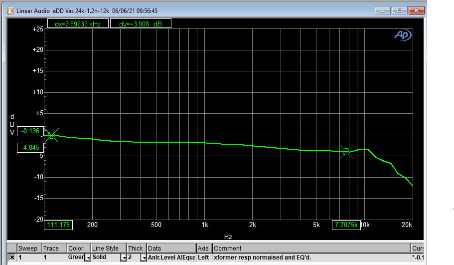

I agree that the numbers probably are not 100% correct, but I believe that the method is correct. Let me explain, also for my own benefit.
When I drive the speaker with a flat sweep, I get the secondary response as in attachment 1. If my direct drive amp has to provide the exact same acoustic response as the original transformer based, my direct drive amp has to deliver a frequency response as in attachment 1. Agreed?
In that attachment you see that, referenced to 100Hz, at for example 7kHz, the response has to be down by about 4dB.

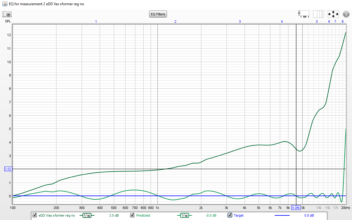

So what I do is invert this response and load it into REW so I get the 2nd attachment. Now the dip at 7kHz has been changed into a peak of 4dB at 7kHz.

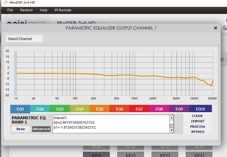

So now when I tell REW to equalize this response to a flat response referred to 100Hz, it will generate a filter set that lowers the 4kHz response by 4dB. The results is shown in the 3rd attachment.
So if I drive the direct drive amp through this filter set (loaded into the miniDSP), a flat sweep at the input of the direct drive amp will show a response at the panels which is identical to the original setup with the step up transformer.
There may be some confusion because the resulting response is shown as flat (with some +/-0.2dB ripples) in the 3rd attachment, but in reality it is the original response at the secondaries.

... and then, when I load the REW generated filter file in the miniDSP that was just delivered, I get the originally measured response at the secondaries/panel connections, as measured before. This filter is applied to the direct drive amp so it replicates the original freq response. -4dB @ 7kHz, -12dB @18kHz.
QED. 😎
