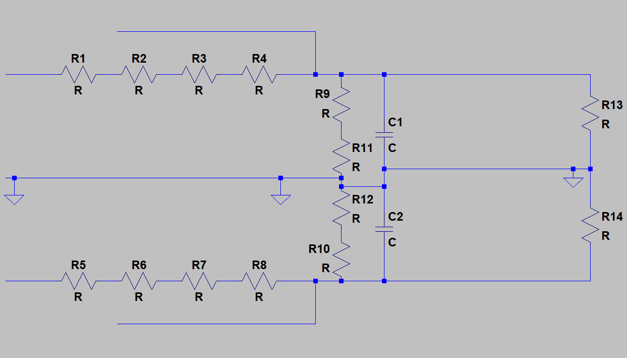

Building a differential HV probe is not simple but not too difficult and could be rewarding.
First- at high voltages resistors are not necessarily resistors. You would need several in series and they should be resistors with a low voltage coefficient. (Same for the HV amp feedback network.) Then you need to compensate for the input C of the cable and AP/Whatever its connected to. On a low voltage probe a cap in parallel with the resistors works but at high voltage not so easy. The big Tek probes (P6015) have a cylinder around the resistor that is tapered to make the shunt cap. I think you could do this with some clever PCB layout. Finally you would need some trimmer resistors to adjust the attenuation and trim caps to optimize the CMRR vs. frequency. Lots of good execution details here: Basics of High Voltage Probe Design

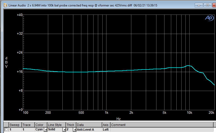

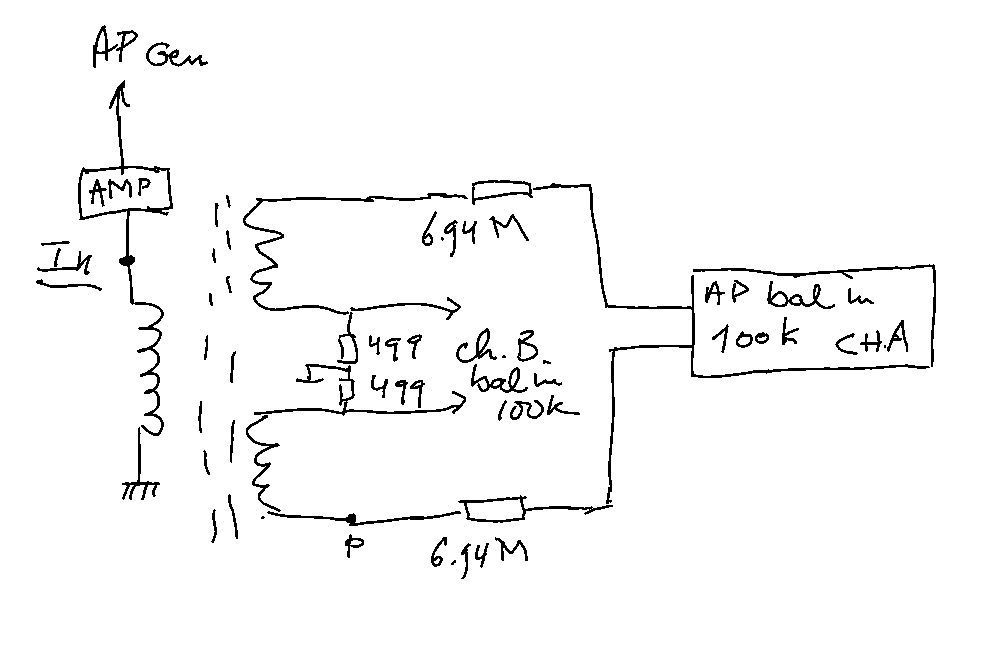

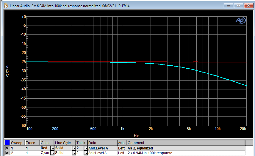

Alright, did some more measurements today. Constructed a high impedance probe (~14Meg across both transformer outputs) and looked at the probe response. The two 6.94Meg resistor are high-voltage 7.5kV rated resistors. Based on earlier posts, I assume that this impedance does not appreciably impact the secondary output voltage.
Then I used the probe response to eq the measurement of the freq response at the secondary output. Vo at the secondaries was about 400Vrms (the absolute value of the Y-axis can be disregarded).
The conclusion I draw from this is, that when I drive my direct drive amp with a flat response, the output should be equalized as in the 3rd graph.

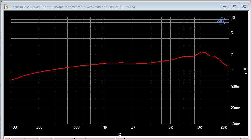

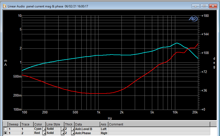

The next attachment is the panel current as measured with 2 x 499R in the panel ground leads as shown in the previous post. This measurement does not need a probe eq but I used regulation on the input to the speaker of 3V +/-2%, which gave about 400Vrms at the secondaries at 1kHz.
The peak current is about 2.2mA at around 10kHz. For my target of 1500Vrms full output, that would mean a peak current requirement of about 8mA at 10kHz.

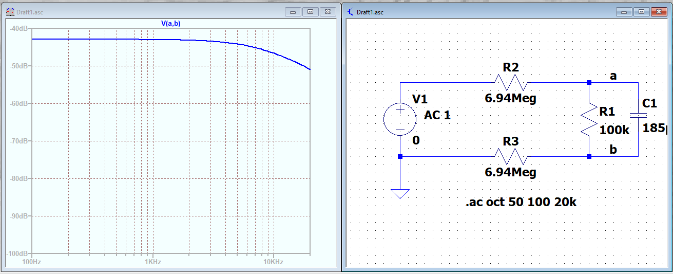

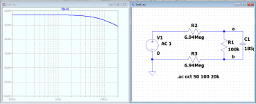

Hans, the 2nd graph shows the drooping response of the voltage probe shown in the first drawing. It is mainly due to the input capacitance of the AP across the 100k Rin. The flat one is a 'loop back' corrected with the inverted probe response, leading to a flat response as expected.
This corrected probe response is then used to equalize the input voltage, and measure the output voltage. Without the correction, the output voltage would droop very much due to the droop of the 'probe'. The correction EQ raises the input voltage according to the inverse of the drooping probe response to compensate for it so that the measurement can be considered flat.

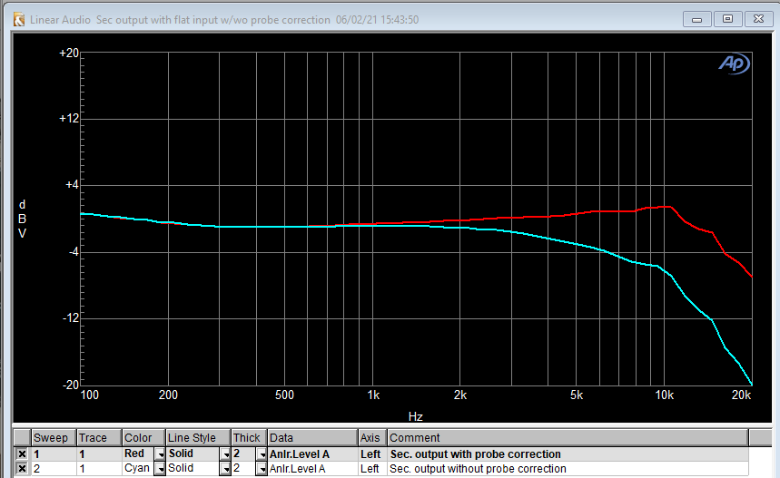

There is no correlation between the 2nd and the 3rd graph, as such. But here is a comparison of the xformer output with and without the probe correction. This compares with the 3rd graph in # 345.
How then is the third graph made when it is not correlated to the voltage correction curve ?
It seems that you assume that the only reason for a FR droop of your probe is the input capacity of the AP, however in the simulations it can be seen that the secondary voltage is not at all flat.
So I’m a bit lost.
Hans
Hans, my reasoning is as follows. If the probe has a flat response, and I feed the speaker with a flat response, then what I measure with the probe gives me the response from speaker input to the panels (output of secondary). This is not a flat response, and my direct drive amp should mimic this response; the dd amp sort of 'replaces' the xformer.
However, my probe is not flat but falls with frequency.* So to correct for the falling probe response, I normalize the probe response to 0dB at 100Hz, and then apply the inverse of this response to the speaker input level, so my measurement will 'look like' I measured with a flat probe.
So maybe a semantic issue or my misunderstanding, that there is of course a connection between the 2nd and 3rd graph, not sure what 'correlation' between them would mean.
Jan
*I suspect this is due to AP input cap but really the cause is not of importance for the measurement.
Jan. It looks like the peak voltage is at 90 degrees. That suggests the output devices will have the full supply voltage across them at peak current at around 10 KHz. Need good heat sinks.
I would not worry about response at this phase. Equalize the system as a system.

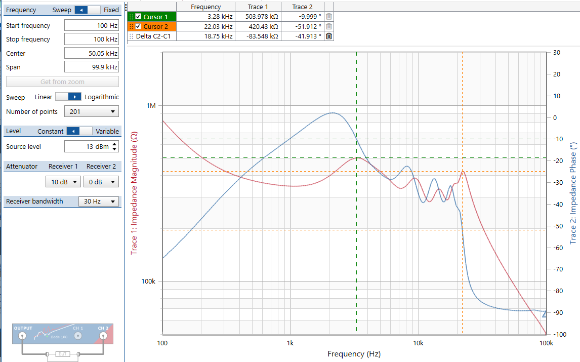

Finally, an impedance measurement with the Bode100 in series-thru mode. Measured between the two wires going from the xformers to the panels, disconnected from the xformer.
Lots of funny things seem to be going on in the upper octave!
